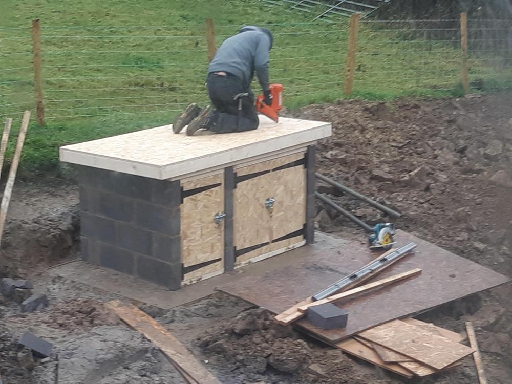

I built a brick hut, separate from the house and garage and situated the 2 meters in there as i needed both gas and electric to the house and garage/annex and situated them centrally between on the advice of the plumber and electrician. Have attached a photo. I had a groundsworker excavate the trenches, and placed the ducting inside, i then paid the utility companies to drop their supplies through the ducting. The hut needs to be watertight and lockable and have a concrete foundation though you can buy specific cabinets to fix to walls. The Utilities will do the digging but charge more so better to do it yourself.  The utility com costs were c£850 for electric (NB from a pole around 60m away in the field) and the gas cost £450. Im not sure the utility companies get out of bed for much less than 400 tbh. The energy suppliers are a bit clueless about this stuff so you need to approach the infrastructure supplier for info e.g. for me it was SP networks for the electric.  Hope this helps, if you need the spec i provided to SP networks give me a shout.
We did the same and included the comms and water also so everything bar the sewage comes to the utilities center and gets distributed from there. In our case to the garden room and the house we can isolate either / all and it meant, in our case, the run distance from the base of the pole, Electricity and Broadband, was < 1m the gas was 1.5 meters to the main and water similarly. Electric move was £850 and gas £450, we dug all the trenches.

It turned out a tad ugly, i did start dry stone walling the external walls but that looked pants (also the corners around the door were to tricky for me). My renderers have now promised to krend it to match the house while they are there. Fingers crossed it looks less naff then!
