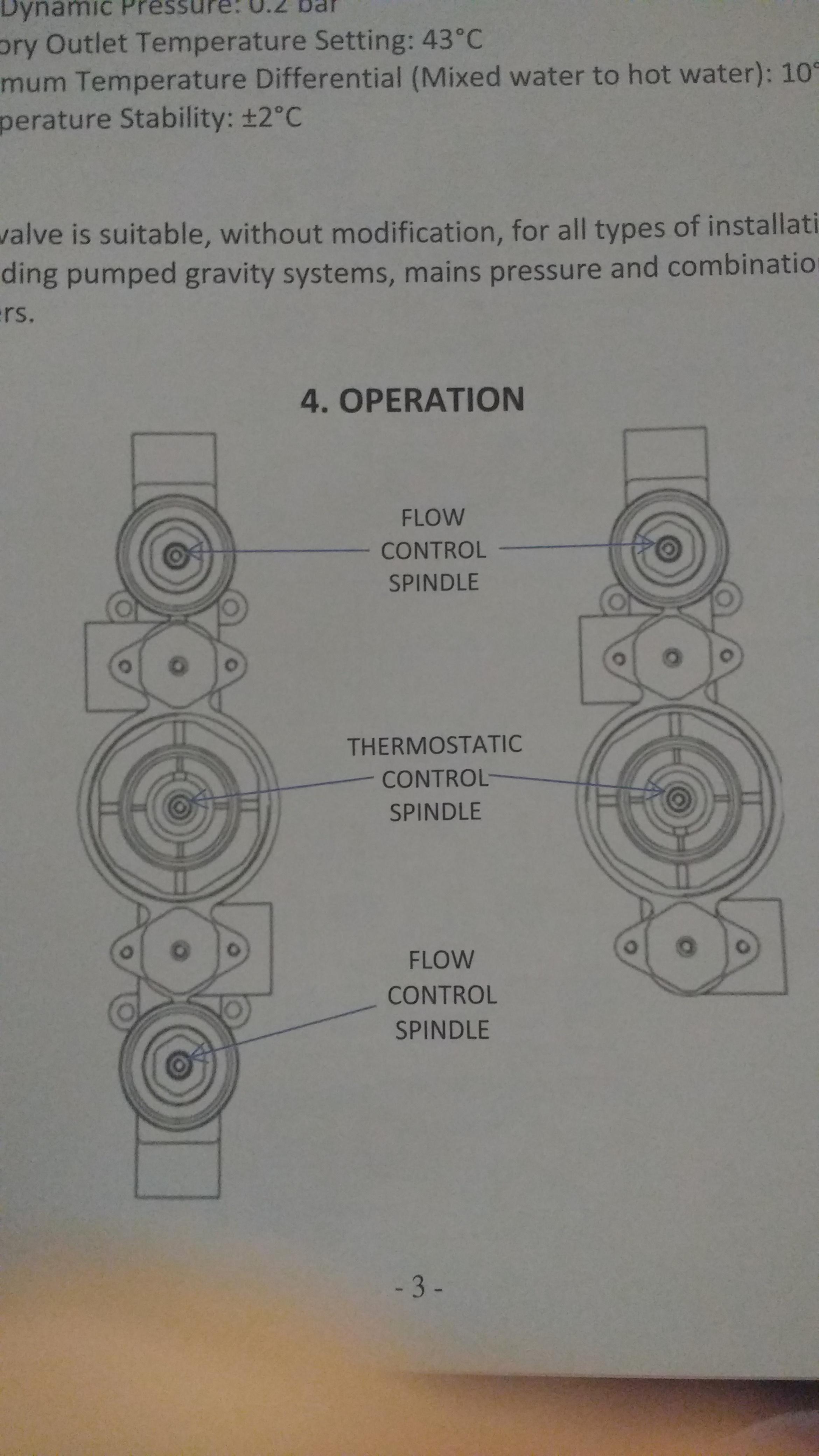

Onoff Posted July 20, 2021 Share Posted July 20, 2021 12 minutes ago, Vijay said: Well I checked, double check and tripled check with Hudson Reed, they are adamant that there is no flow control, it is just on off. Really? VID-20210720-WA0021.mp4 1 Link to comment Share on other sites More sharing options...
Onoff Posted July 20, 2021 Share Posted July 20, 2021 &...the manual refers to"flow control": 1 Link to comment Share on other sites More sharing options...

Onoff Posted July 20, 2021 Share Posted July 20, 2021 7 minutes ago, Vijay said: Where did you find that video mate? About 50' from where I'm sitting typing this...at home! 2 Link to comment Share on other sites More sharing options...
Nickfromwales Posted July 20, 2021 Share Posted July 20, 2021 16 minutes ago, Vijay said: Where did you find that video mate? It from his ‘personal shower’ collections…… Please don’t ask any questions about arse hair removal devices……. 1 Link to comment Share on other sites More sharing options...
Nickfromwales Posted July 20, 2021 Share Posted July 20, 2021 19 minutes ago, Vijay said: 3 different people replied to me from Hudson Reed and they all the no, the last person saying exactly what I quoted. Like I said, talking complete and utter bollocks. Email them a link to @Onoff’s video. Link to comment Share on other sites More sharing options...

Onoff Posted July 20, 2021 Share Posted July 20, 2021 (edited) 1 hour ago, Vijay said: Can't download the video to send to them, get sound but no visual Won't they need an account to see this thread?? PM me your email and I'll send it that way. I'm sure though they'll just revert to saying you should be able to turn it a bit and get a little flow but should really be used full on, like you said they already have and that that's what my video shows. Edited July 20, 2021 by Onoff Link to comment Share on other sites More sharing options...
Vijay Posted July 21, 2021 Author Share Posted July 21, 2021 12 hours ago, Onoff said: PM me your email and I'll send it that way. I'm sure though they'll just revert to saying you should be able to turn it a bit and get a little flow but should really be used full on, like you said they already have and that that's what my video shows. Are you sure you don't work for Hudson Reed! lol this is what they replied: "as you can see from his video , when he first turns the shower on with not doing the full turn , water does come out of it but its not enough to have a shower, this is also dependent on the pressure you have coming to the shower, which is why I suggested that theoretically you should be able to turn it slightly and not get the full amount of water, which is why we recommend they are only supposed to be used as a full on and full off" Link to comment Share on other sites More sharing options...
Onoff Posted July 21, 2021 Share Posted July 21, 2021 16 minutes ago, Vijay said: Are you sure you don't work for Hudson Reed! lol this is what they replied: "as you can see from his video , when he first turns the shower on with not doing the full turn , water does come out of it but its not enough to have a shower, this is also dependent on the pressure you have coming to the shower, which is why I suggested that theoretically you should be able to turn it slightly and not get the full amount of water, which is why we recommend they are only supposed to be used as a full on and full off" Only just read this after responding to your email! Told you they would say that. Wtf call it FLOW control then? ? One thought...in the event of a failure of ANY concealed mixer it may mean tiles off etc. If you're needing the shower daily, don't have an alternative, have carers coming in etc then a good old surface mount, thermostatic mixer bar might be the way to go instead as easier to sort if a failure. Quick to replace on just a couple of stub pipes coming out the wall. Fix it firmly and it might double as a grab rail. Probably just as likely to bang their head if they slip on concealed or surface. Link to comment Share on other sites More sharing options...
