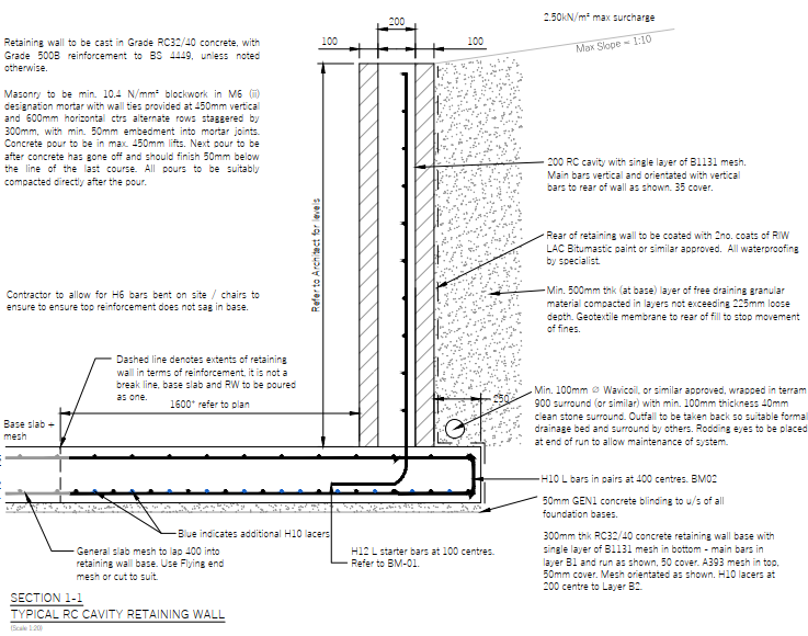

Moonshine Posted May 23, 2021 Posted May 23, 2021 My 300mm slab has two meshes in it, which need a min 50mm cover. The bottom mesh is to be set on 50mm castles above the blinding. The question I have is what spacer to use to get the 200mm space needed so the top mesh doesn't sag. Any ideas?
TonyT Posted May 23, 2021 Posted May 23, 2021 https://www.steelaccessories.co.uk/products/continuous-high-chairs-wire-deck-chairs?variant=39487334613154 1
Ronan 1 Posted May 23, 2021 Posted May 23, 2021 Tony is correct with the product but you won't want 200mm ones as with 50mm cover top and bottom a 200mm spacer and the depth of 2 layers of mesh and the overlaps you'd be out through the top of the concrete. 150mm spacers would be loads for that. And even then use flying end mesh to avoid issues at corners with 4 way overlaps. 1
Moonshine Posted May 23, 2021 Author Posted May 23, 2021 I think I will use these 50mm concrete chairs to get, the mesh off the blinding https://www.steelaccessories.co.uk/collections/concrete-spacers/products/concrete-mesh-spacers-meshmen I will get some 150mm spacers / deck chairs. The wire mesh isn't going to be flying end mesh, will I need to grind off some for the corners?
Ronan 1 Posted May 23, 2021 Posted May 23, 2021 What size is the mesh? At the corners you might need to Nick the corners of the top 2 of the 4 overlapping sheets. For the spacers on the bottom I'd use mars bars far easier and better the others will just overturn 2
Moonshine Posted May 23, 2021 Author Posted May 23, 2021 (edited) 45 minutes ago, Ronan 1 said: What size is the mesh? 2.4 x 4.8m lower A1131, upper A393, those mars bars look a much better solution for the reasons you give, how many of those bars would you have per m2 of mesh? Edited May 23, 2021 by Moonshine
Ronan 1 Posted May 23, 2021 Posted May 23, 2021 3 minutes ago, Moonshine said: 2.4 x 4.8m lower A1131, upper A393, those mars bars look a much better solution for the reasons you give Definitely need to take the corners of at least the top sheet of A393 but more than likely the top 2 your detail even mentions that fact.just lay them as is and you'll know exactly what you need to cut then and it's easy to cut in place Yeah the MARS bars are all I'd use for bottom layer they are the right tool for the job, you can break them up by hand as required too. 1
Moonshine Posted May 23, 2021 Author Posted May 23, 2021 1 minute ago, Ronan 1 said: Yeah the MARS bars are all I'd use for bottom layer they are the right tool for the job, you can break them up by hand as required too. how many bars would you set out per m2 of mesh?
Mr Punter Posted May 23, 2021 Posted May 23, 2021 That mesh is heavy duty. Space your mars bars and deck chairs at about 1200 and you will be OK. I hope you have a machine to lift the mesh in. 1
