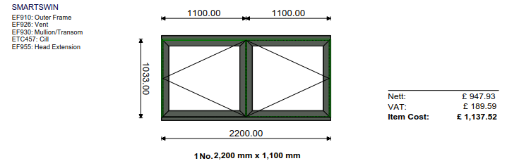

David Mclean Posted May 20, 2021 Share Posted May 20, 2021 (edited) Hello We are refurbing a small house and want to fit aluminium windows. Total of seven windows, front and back doors. Can anyone tell me what I would expect to pay for a something like this, just the window no fitting. 187cm wide x 115cm height Double glazed Anthracite grey RAL 7016 Trickle vent Photo attached of the old one Thank you Edited May 20, 2021 by David Mclean Link to comment Share on other sites More sharing options...
Moonshine Posted May 20, 2021 Share Posted May 20, 2021 this is one from a quote i received, for a similar sized window no fitting, these weren't the cheapest company, but the only one that itemised the cost of each. Link to comment Share on other sites More sharing options...
saveasteading Posted May 20, 2021 Share Posted May 20, 2021 So that is about £400/m2 + vat, and you can apply that to all the windows for a first estimate. Seems a decent price if the quality is good. Link to comment Share on other sites More sharing options...
Moonshine Posted May 20, 2021 Share Posted May 20, 2021 1 hour ago, saveasteading said: So that is about £400/m2 + vat, and you can apply that to all the windows for a first estimate. Seems a decent price if the quality is good. The company that i am probably going to go for is 16 windows and 2 bi-folds, is £394 per m2 + VAT. That is with 6.8mm lam x 18mm Argon Gas x 4mm float. Link to comment Share on other sites More sharing options...
