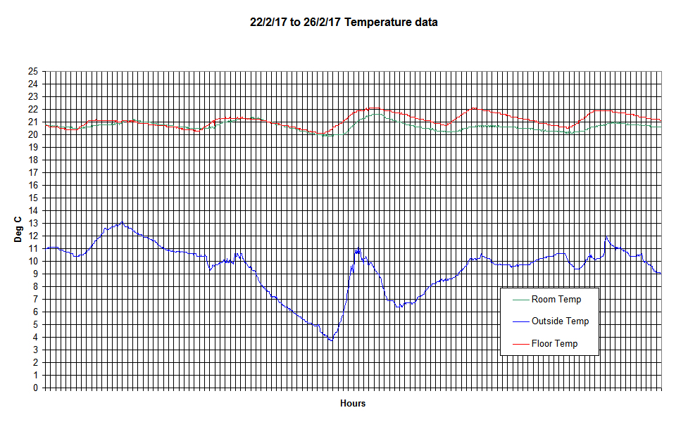

I think there's a great deal of over-thinking going on here!  A heated slab like this in a highly energy efficient house simply will never get "hot" as such, it will get very, very slightly warmer than the room.  We have travertine over a lot of our ground floor, through doorways etc as a continuous run.  There is not even the slightest possibility that it will crack when laid on a steel reinforced slab like this, both because there's no significant temperature changes between the two elements and because the steel fabric in the concrete means that the structural slab can't crack (if it did it would cause problems, as it's load-bearing and supports the whole house).
To illustrate this, this is a rough cut from some data collected over the last couple of weeks for the coldest four days we had.  The slab surface temperature rearely gets more than 1 deg C above the room temperature, and most of the time stays well below that:
The data above is a bit rough, I'm still tidying up the plot, but the horizontal scale is hours, starting at midnight 21/2/17 on the left and ending at midnight 26/2/17 on the right.  The red line in the floor surface temperature (travertine) and the green line is the room air temperature.  You can see when the UFH has come on for an hour or two from the small peaks; most of the time the UFH is off.  We didn't get any really cold weather when I was doing this lot of monitoring, which is a nuisance, as I was hoping to get more data on the relationship between heat input and outside temperature.
Anyway, you can see from this that the floor isn't going to get at all hot from the UFH, it will get far hotter from the sun shining on it in summer.

Our travertine is all 600 x 400 IIRC, laid on standard set Mapei white, flexible, adhesive, with cream grout.  The whole lot was sealed with some silicone sealer that was applied once before grouting, then again after grouting, and seems to do a reasonable job.  I think they recommend re-sealing the floor every year or two, which isn't much of a chore as the sealant is very thin and is quick and easy to apply.
It's been down for a couple of years, and goes through four doorways on the ground floor, with no thresholds, just tiled straight through.  The coefficient of linear thermal expansion of limestone/travertine flooring is nearly identical to that of structural concrete, so they won't move differentially at all over a small temperature range.  Problems only really arise when laying something that has a coefficient of linear thermal expansion that is significantly different to the base it's laid on, like hard fired porcelain, that has about half the coefficient of linear thermal expansion of structural concrete.
