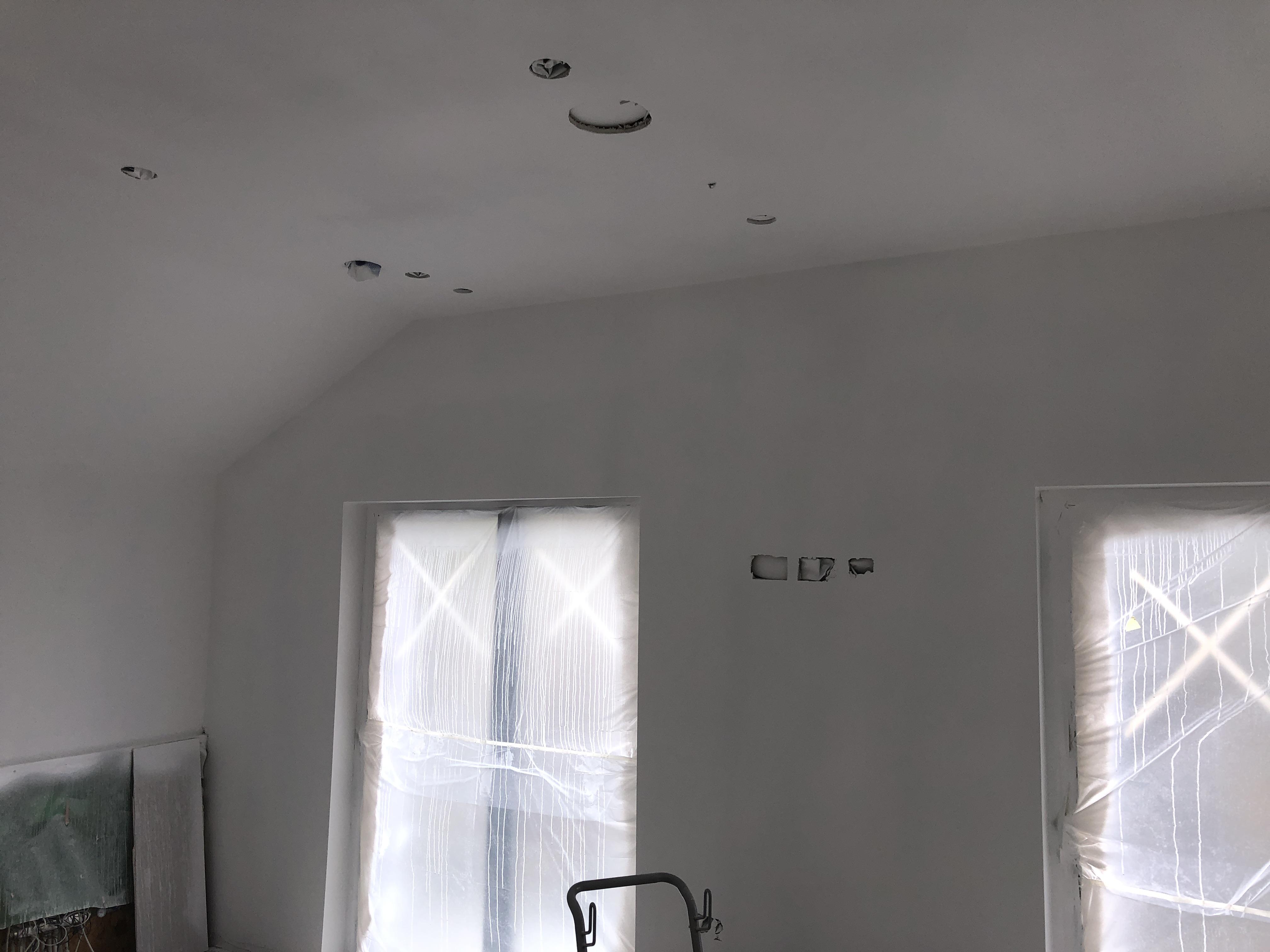

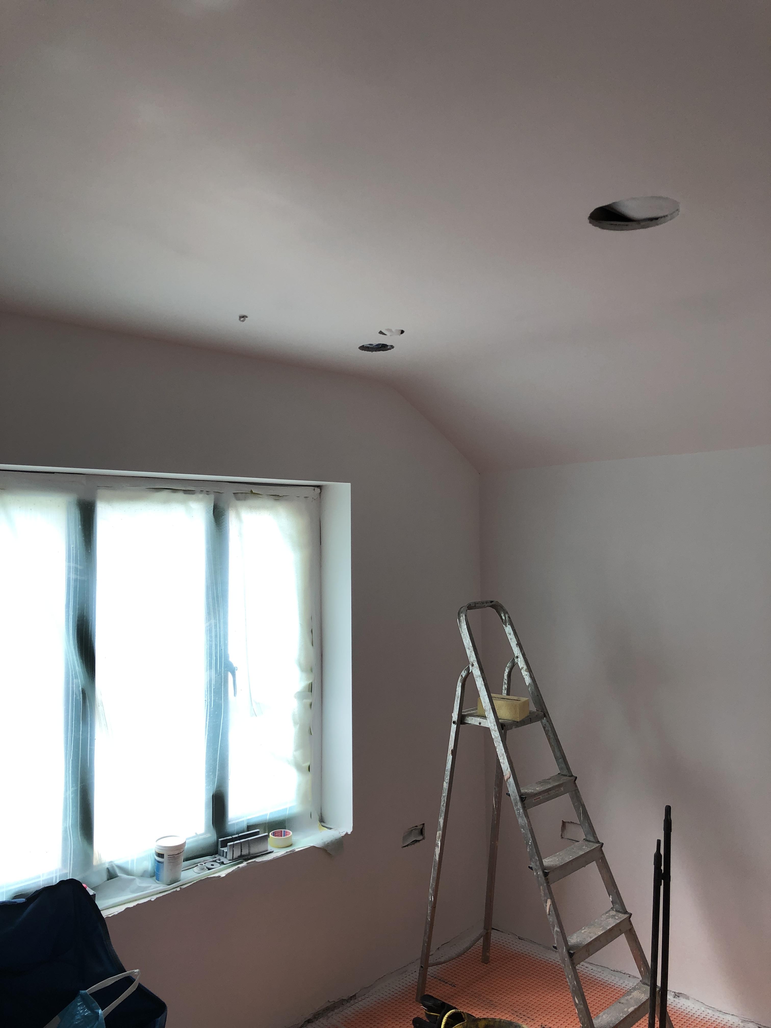

Pocster Posted May 28, 2021 Author Posted May 28, 2021 (edited) I went for it Even the Wagner extension rod doesn’t seem to work ! Just a dribble ! Back to the short nozzle . Man in paint shop said not to dilute just mix well . Kept blocking over and over again ! I then ran out of paint ( sprayers seem to use tons more ) Sent SWMBO to get more Mixed the 2nd tub in and magic . No blocking - runs like a dream ! I’m over stretching to do ceiling and the mess on me is amusing . But the quality of finish is the dogs ! ? Photos don’t do justice . Perfect white not one dribble ( not one !! ) Almost like a skilled man did it Edited May 28, 2021 by pocster 1
