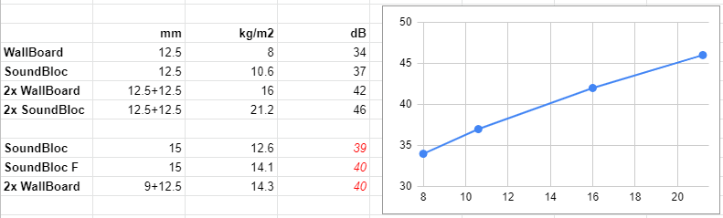

MortarThePoint Posted June 16, 2021 Author Posted June 16, 2021 (edited) Considering this article on the BG website (admittedly about walls), the sound attenuation in dB is linear with plasterboard mass. I have plotted the points they identify below and extrapolated some other makeups. Two layers of 12.5mm WallBoard has better performance than one layer of 15mm SoundBloc F and is slightly cheaper. Probably not when the additional screws are factored in. It is thicker which is a negative, but probably wouldn't be noticed. Installation effort is debateable as lifting a 23kg plasterboard sheet twice is arguably less effort than lifting one 41kg plasterboard sheet. WallBoard is more available however so that may mean I have to go that route. All of this is a gross oversimplification as the acoustic benefits can't be fully appreciated in a single number, but it could be indicative. Edited June 16, 2021 by MortarThePoint
joe90 Posted June 16, 2021 Posted June 16, 2021 (edited) 1 hour ago, MortarThePoint said: Two layers of 12.5mm WallBoard has better performance than one layer of 15mm SoundBloc F and is slightly cheaper. Probably not when the additional screws are factored in. It is thicker which is a negative, but probably wouldn't be noticed. Installation effort is debateable as lifting a 23kg plasterboard sheet twice is arguably less effort than lifting one 41kg plasterboard sheet. a conclusion I came to on a recent job, screws are cheap as chips, (I also had use of a plasterboard lifter which was brilliant). “It is thicker which is a negative,” ??? only 2.5mm ?♂️. Edited June 16, 2021 by joe90
Pocster Posted June 16, 2021 Posted June 16, 2021 14 minutes ago, joe90 said: screws are cheap as chips Friday night after a few beers for sure 1
MortarThePoint Posted June 16, 2021 Author Posted June 16, 2021 1 hour ago, joe90 said: “It is thicker which is a negative,” ??? only 2.5mm ?♂️. 10mm (2*12.5 vs 15). Still not massive 1 hour ago, joe90 said: a conclusion I came to on a recent job, screws are cheap as chips, (I also had use of a plasterboard lifter which was brilliant) So you went 2 layers of 12.5mm WallBoard rather than 1 layer of 15mm SoundBloc
joe90 Posted June 16, 2021 Posted June 16, 2021 (edited) 2 minutes ago, MortarThePoint said: So you went 2 layers of 12.5mm WallBoard rather than 1 layer of 15mm SoundBloc Yup ! (Unfortunately not on my build, as I have pointed out before, my only regret with my new build is lack of sound insulation between floors ?). Edited June 16, 2021 by joe90
