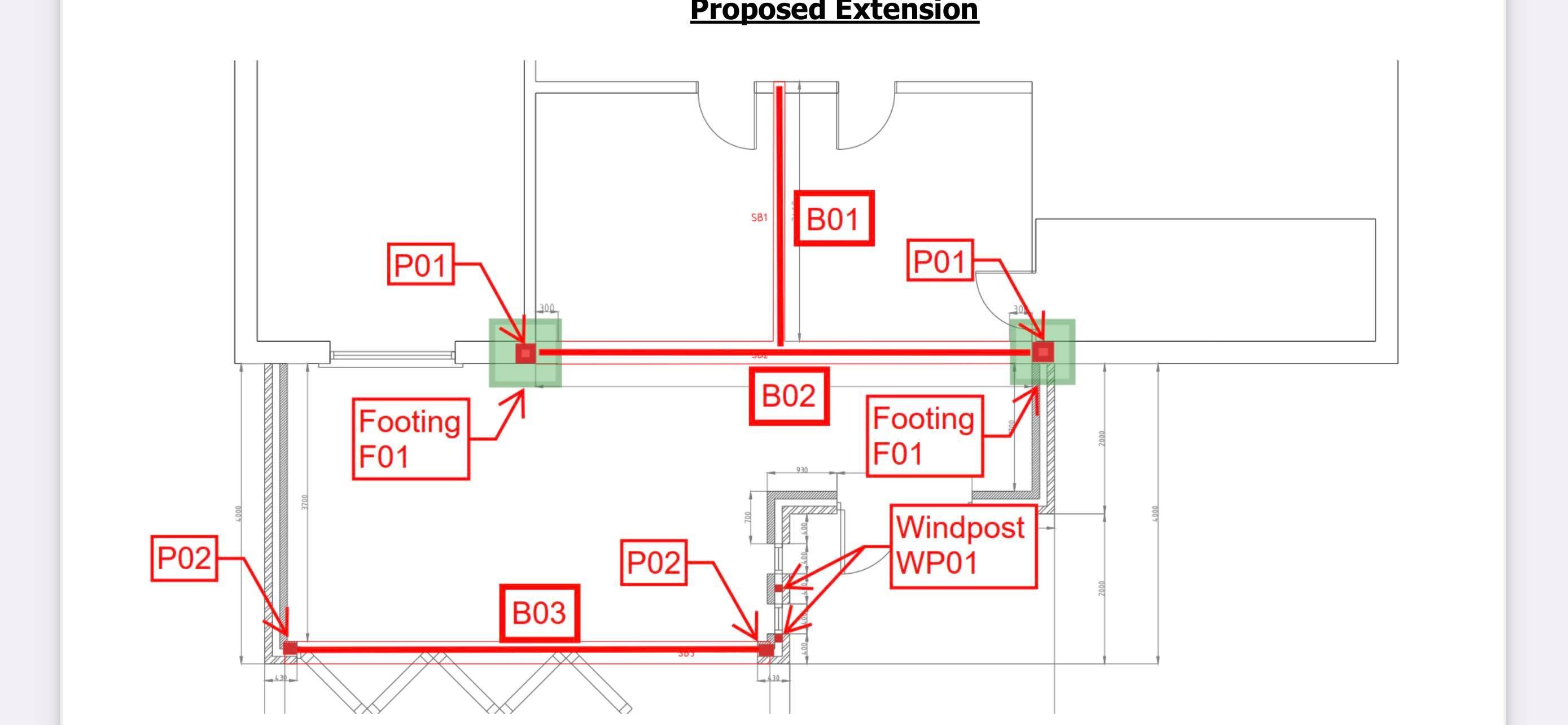

joe88 Posted May 8, 2021 Share Posted May 8, 2021 Hi, can some one please run me through the build-ability of the padstone foundations(footing F01- green hatch). Obviously the existing rear wall of the house is their at the moment and we are wanting to build and make the extension watertight before knocking the rear walls down and installing the steel. Its the right hand side pad that I'm concerned about as i believe this will have to be done when the extension foundations are poured. can they do this from the outside(underpin) or can it be poured in two stages?, our kitchen is the room that this backs onto and we don't want to rip it out just yet. The SE has stated " 1000x1000x300dp rc35 pad foundation with 2 No. A393 in bottom", the opening is 6.5m so quite large, im not sure if a box frame might be better design for us. Thanks in advance. Link to comment Share on other sites More sharing options...
saveasteading Posted May 8, 2021 Share Posted May 8, 2021 Ask your Engineer if the pad can be asymmetrical, ie more of it outside the existing house. That will let you dig more easily, and perhaps all from outside in one operation. Alternatively it might become more rectangular. That may require it being a little deeper, or reinforced. Yes you can normally pour it in parts as all the load is presumably downwards. In that case you would probably put some ties bars in to link fully (push them into the earth face before pouring, or drill in afterwards), This should be simple to redesign if you explain why you want to do it. Link to comment Share on other sites More sharing options...
joe88 Posted May 8, 2021 Author Share Posted May 8, 2021 14 minutes ago, saveasteading said: Ask your Engineer if the pad can be asymmetrical, ie more of it outside the existing house. That will let you dig more easily, and perhaps all from outside in one operation. Alternatively it might become more rectangular. That may require it being a little deeper, or reinforced. Yes you can normally pour it in parts as all the load is presumably downwards. In that case you would probably put some ties bars in to link fully (push them into the earth face before pouring, or drill in afterwards), This should be simple to redesign if you explain why you want to do it. Saveasteading, Thanks for your suggestions, ill go back to him with them and hopefully we can go with one of them options. it would be great if we can do it all from the outside as it would save messing with concrete at a later stage and just use one readymix load Link to comment Share on other sites More sharing options...

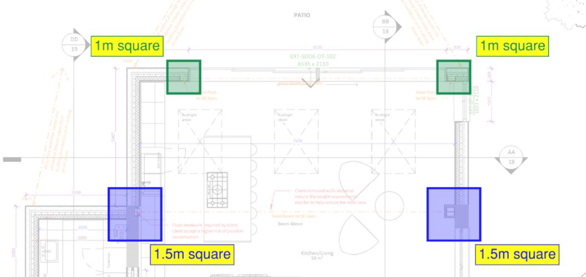

NandM Posted February 9 Share Posted February 9 (edited) @joe88 - what did you end up doing? My SE has also specced pad founds and am looking at ways I can minimise disruption of the existing living room floor. The one alternative he has come back with is to use wall piers and possibly with underpinning - but these are would stick out too much. Also - if there is no reasonable alternative, then how much of the existing floor would need to be dug up? And would cold bridging be an issue? Edited February 9 by NandM Link to comment Share on other sites More sharing options...

NandM Posted February 13 Share Posted February 13 On 09/02/2024 at 13:29, George said: A box frame as mentioned above - keeps the foundation much narrower, but has a higher steel cost. You'd only be able to do it for B1 but I'm guessing that's the problem one. Sorry for the late reply - I need to enable notifications. By box frame, do you mean something like the attached option the SE suggested? Link to comment Share on other sites More sharing options...
NandM Posted February 13 Share Posted February 13 (edited) @Gus Potter - I've attached the plans and the SE drawings for all the floors. The whole disruption is the biggest concern. The living room is fully finished and the disruption will probably affect at least a third of it. We have a solid floor, so fortunately no electrics to disturb and no pipework underneath. Edited February 13 by NandM corrected order of pics Link to comment Share on other sites More sharing options...

George Posted February 21 Share Posted February 21 On 13/02/2024 at 10:24, NandM said: Sorry for the late reply - I need to enable notifications. By box frame, do you mean something like the attached option the SE suggested? No they've suggested leaving a masonry pier at each end. It'd be a much cheaper way of doing things and architecturally would separate the living room off, which is a good thing. Link to comment Share on other sites More sharing options...
NandM Posted February 21 Share Posted February 21 (edited) Hmmmm....not sure what you mean by separating the living room off. The new living room extension won't be open plan in to the kitchen, it'll just be en extension for the living room. But I've gone back to the SE to get an actual number for how big these piers would be. *Edit: the pier sizing is in the diagram and would just be too big* Edited February 21 by NandM Link to comment Share on other sites More sharing options...
George Posted February 21 Share Posted February 21 They can't really go less than 665mm without a steel goalpost or box. If masonry piers aren't acceptable then a steel box frame is likely to be a better option to reduce foundation size. 1 Link to comment Share on other sites More sharing options...

NandM Posted February 22 Share Posted February 22 The SE has come back with the following, which is at odds with what I've read so far. I thought the beam needs to be encased, but here the SE is saying we need to create a new foundation. "A box frame might be feasible, however the bottom member will require a mass fill trench foundation approximately 700-800mm wide dependant on the loads, which will be casted central to the bottom transfer beam resulting in excavation on the existing property." Link to comment Share on other sites More sharing options...
George Posted February 22 Share Posted February 22 The encasement and foundation are essentially the same thing, just depends how far down you need to go to get to competent ground. 700-800mm is thinner than the pad and should be able to be mostly not under the existing walls, which I would have thought was the main issue. Last one I did was 600mm wide but I think you've more load coming down onto that part of the building. Ultimately it will need to be what it needs to be. 1 Link to comment Share on other sites More sharing options...

Tetrarch Posted February 24 Share Posted February 24 I had exactly this problem where my SE specified the foundations below. After a good discussion we've opted for a picture frame instead of goalposts for the beam where the blue squares are and we had 600mm trench dug to 1200mm below DPC that satisfied the SE for the remainder. This way we didn't have to undermine the foundations of the existing structure that have been prefectly happy for 53 years. 1 Link to comment Share on other sites More sharing options...
George Posted February 24 Share Posted February 24 (edited) 18 hours ago, Gus Potter said: @George.. What is your gut feeling on this one? Do you fancy stepping up to the plate? Not for free! But a box frame feels the right solution here. There's not much lateral stiffness in the structure otherwise and they could get the box installed first before taking out all the rest of the structure, and the other steelwork is tied back to it. With suitable trial puts I think I'd consider reusing the existing foundation. Edited February 24 by George Link to comment Share on other sites More sharing options...
