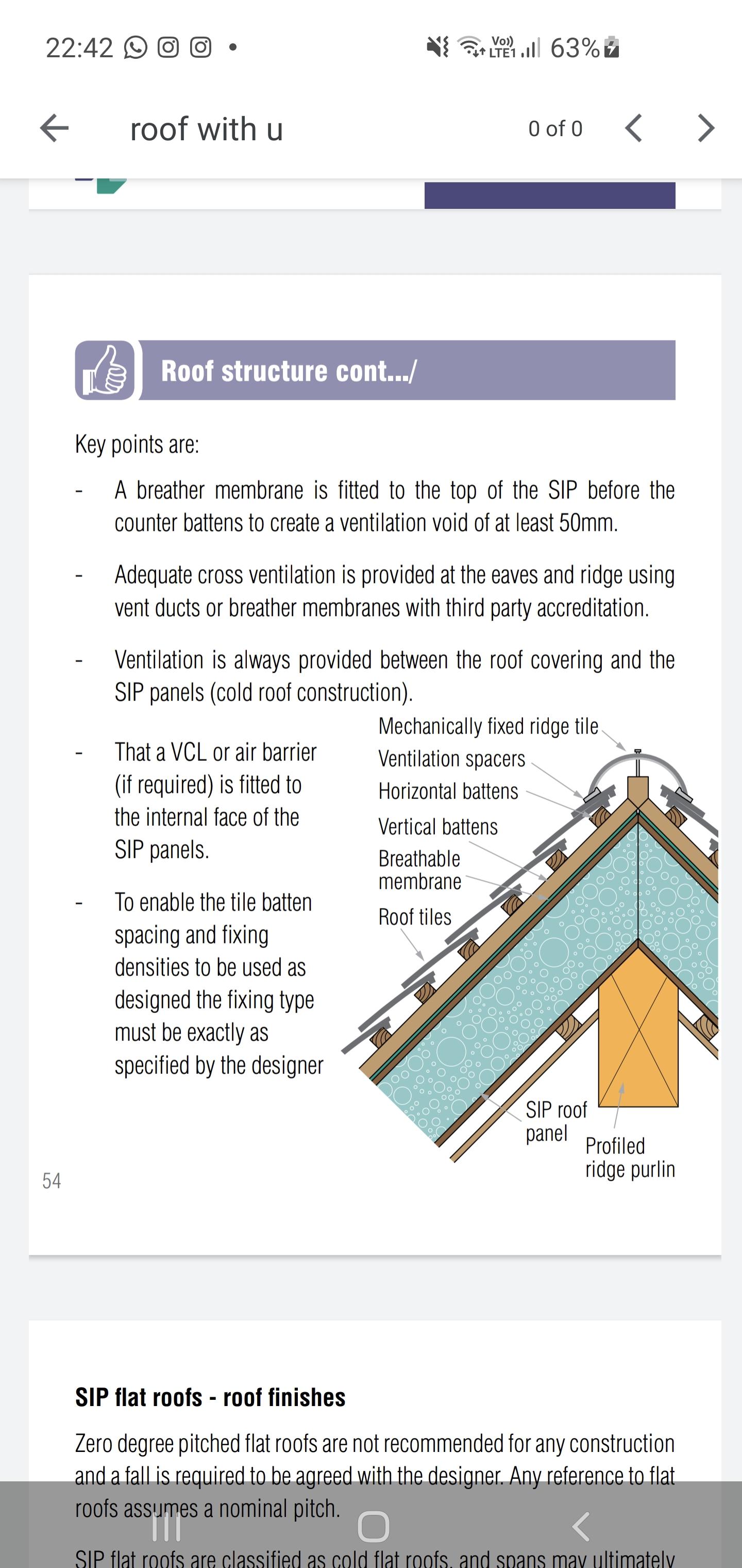

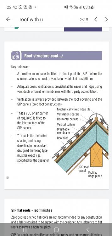

SuperJohnG Posted May 6, 2021 Posted May 6, 2021 I have a SIPS roof coming, which will be slated. The SIPS roof will have a breathable membrane directly fitted then I had planned to counterbatten using 25x50mm battens then put 22mm sarking over the top, then membrane and slates directly nailed. However reading the STA guidelines tonight, it says minimum 50mm ventilation gap. So does this mean I need 50 x 50mm roof battens now? This plays havoc with my combination roof lights with the wall /roof junction. What's the norm here?
Temp Posted May 7, 2021 Posted May 7, 2021 (edited) 50mm is the normal spec for the ventilation gap on a cold roof. Not quite sure why you need sarking boards on a SIP roof? I know they are more common on traditional roofs in Scotland but isn't that for structural reasons? Don't the SIPS already deal with this? Edited May 7, 2021 by Temp

scottishjohn Posted May 7, 2021 Posted May 7, 2021 I would have thought 25mm vertical batons to fix sarking boards or (osb sheeting) to - and another vapour barrier between slates and sarking ?- should be fine ,providing it can vent out of the ridge and bug screen at gutter level
SuperJohnG Posted May 7, 2021 Author Posted May 7, 2021 1 hour ago, scottishjohn said: I would have thought 25mm vertical batons to fix sarking boards or (osb sheeting) to - and another vapour barrier between slates and sarking ?- should be fine ,providing it can vent out of the ridge and bug screen at gutter level Thats what I had assumed. I'm just having a wobble as the STA guide says 50mm void and that's what other seems to spec. My architect also thinks its fine. He also mentioned OSB too as it will be cheaper and easier to fit. But I'm slightly nervous at that not lasting as battens or sarking are obviously treated.
scottishjohn Posted May 7, 2021 Posted May 7, 2021 (edited) 2 hours ago, SuperJohnG said: Thats what I had assumed. I'm just having a wobble as the STA guide says 50mm void and that's what other seems to spec. My architect also thinks its fine. He also mentioned OSB too as it will be cheaper and easier to fit. But I'm slightly nervous at that not lasting as battens or sarking are obviously treated. you fit batons --then clad them with thick OSB ,then add breathable membrane ,then nail on the slates, needs to be thick OSB to give nails something to fix to - If using sarking boards --they must be treated and leave small gaps between them -to allow for movement of wood as it will grow when damp Edited May 7, 2021 by scottishjohn
SuperJohnG Posted May 7, 2021 Author Posted May 7, 2021 1 hour ago, scottishjohn said: you fit batons --then clad them with thick OSB ,then add breathable membrane ,then nail on the slates, needs to be thick OSB to give nails something to fix to - If using sarking boards --they must be treated and leave small gaps between them -to allow for movement of wood as it will grow when damp I was planning on a membrane over sarking too.
