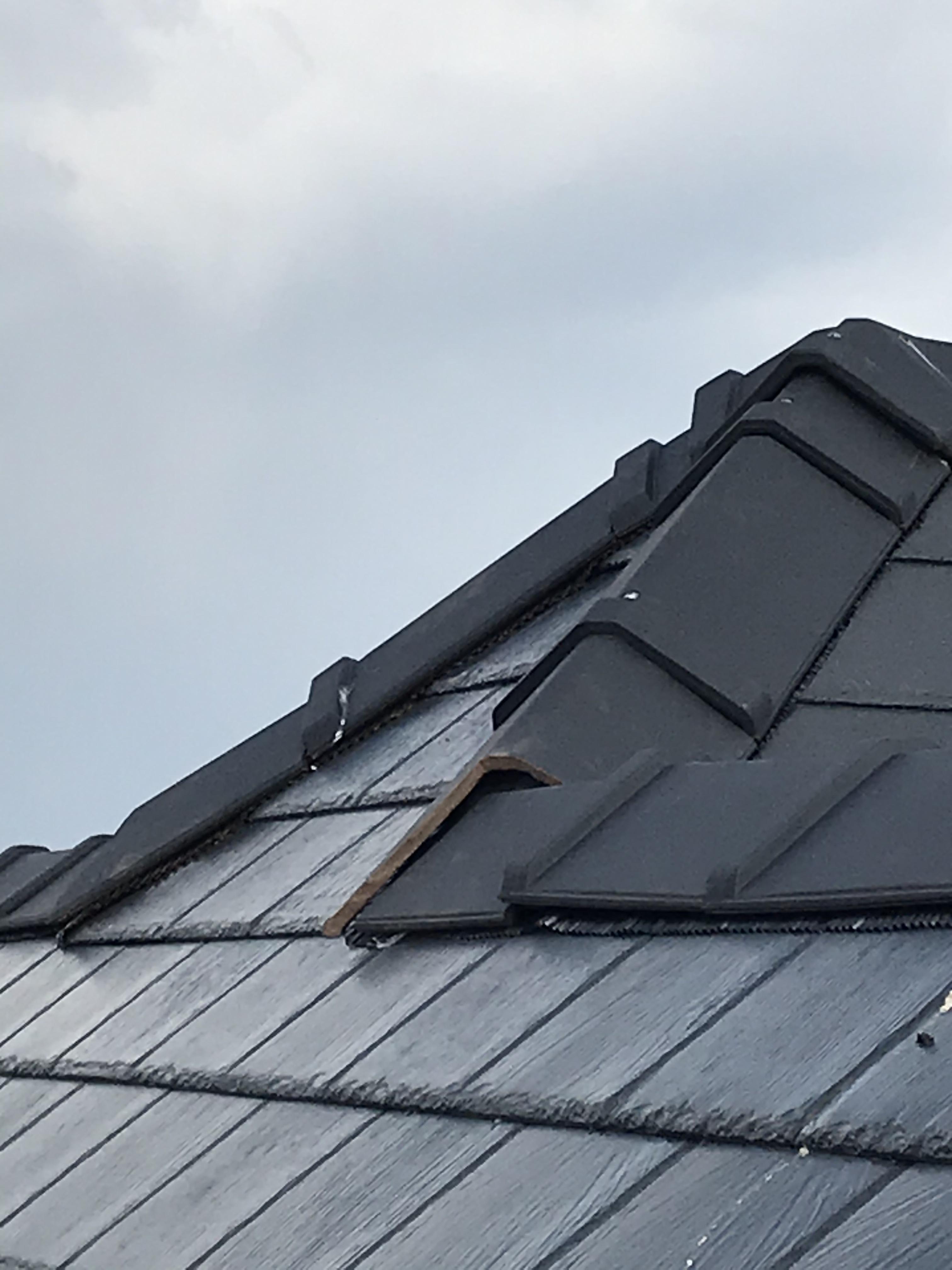

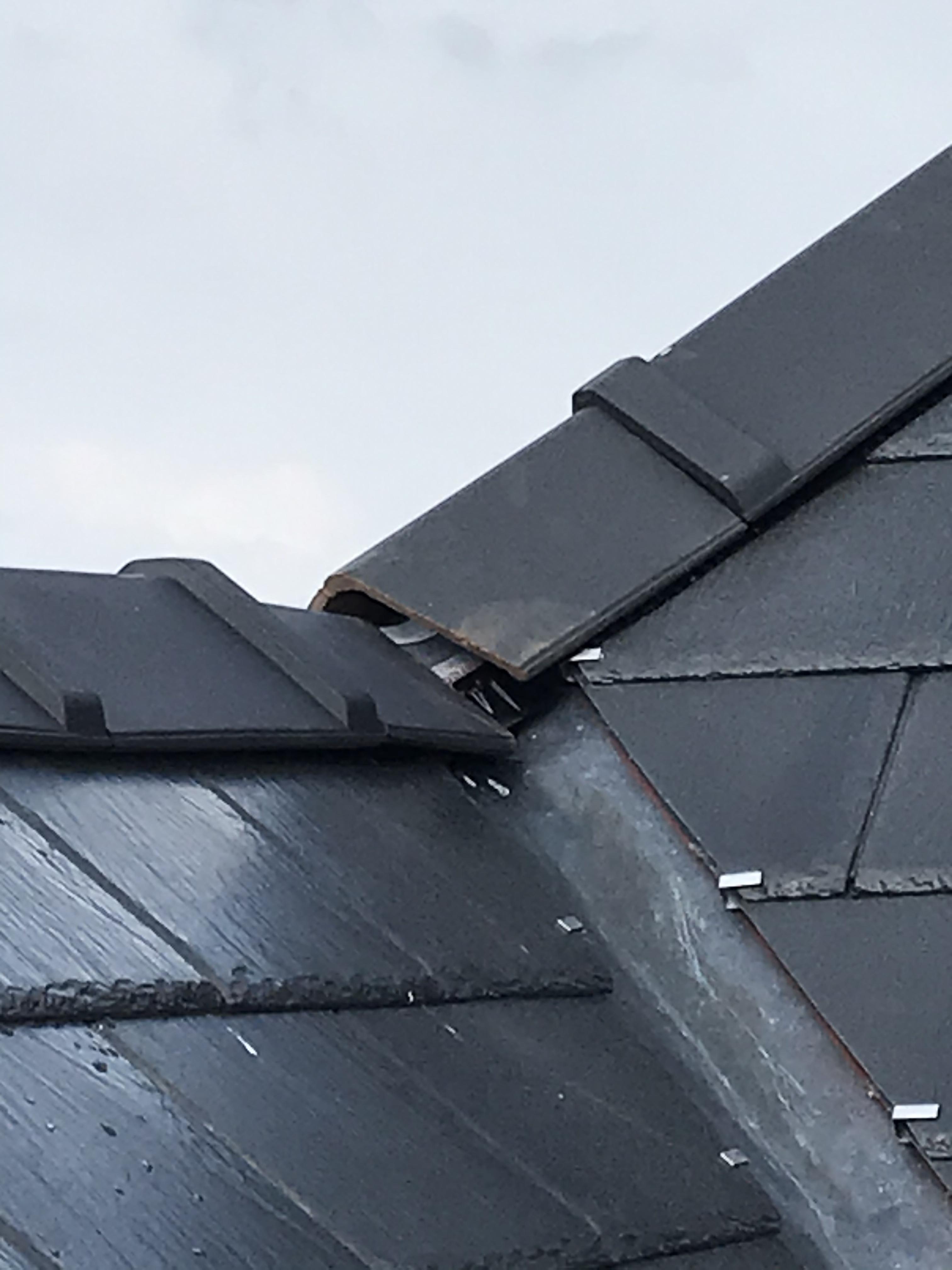

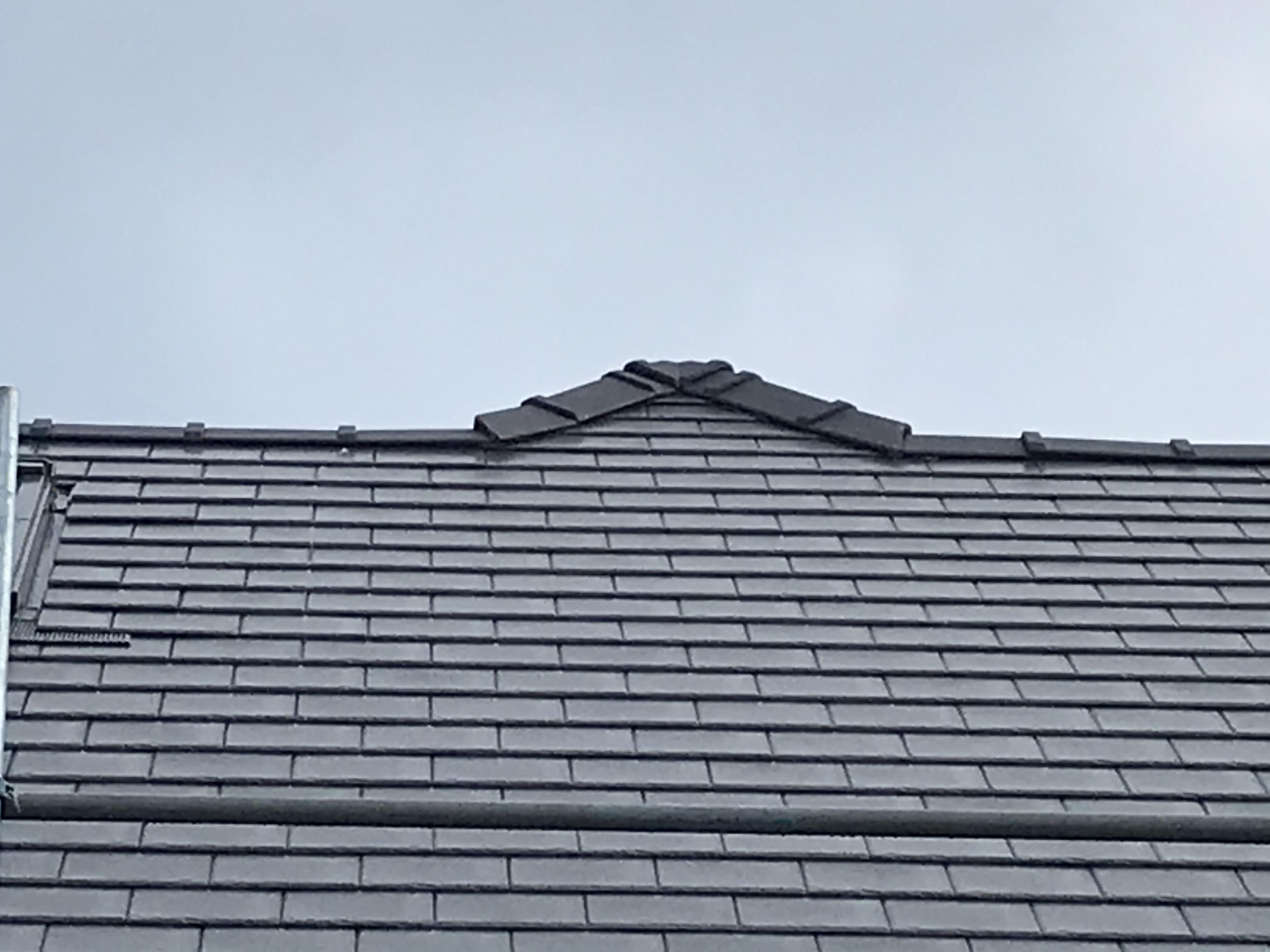

BobHenry Posted May 1, 2021 Share Posted May 1, 2021 This a view of the same part of the roof from different angles. The roofer needs to put black cement to fill the gap but still looks a little messy to me. Is there a better way this should have been done? Link to comment Share on other sites More sharing options...
Big Jimbo Posted May 1, 2021 Share Posted May 1, 2021 Those tiles (man made?) look great, but those ridge tiles look dreadful im afraid. I doubt you will be happy even if they do fill the gaps with coloured cement (which will quickly fade) Link to comment Share on other sites More sharing options...
BobHenry Posted May 1, 2021 Author Share Posted May 1, 2021 They are the Cambrian tiles. Yeh they look great Link to comment Share on other sites More sharing options...
tonyshouse Posted May 1, 2021 Share Posted May 1, 2021 Ridges should be redone - ideally with ones that don’t overlap. Link to comment Share on other sites More sharing options...
Dave Jones Posted May 3, 2021 Share Posted May 3, 2021 multiple problems here. Why have different ridge tiles been used ? The roof is slate/fake slate by the looks and they have then used conc ridge tiles that are totally out of character.? The junction from hip to ridge needs a lead soaker and then dressing to look decent. The ridge cut square above with a lead apron to dress it would look much better. https://www.roofingsuperstore.co.uk/product/tapco-synthetic-hip-and-ridge.html sorry but that is dog rough. Link to comment Share on other sites More sharing options...
