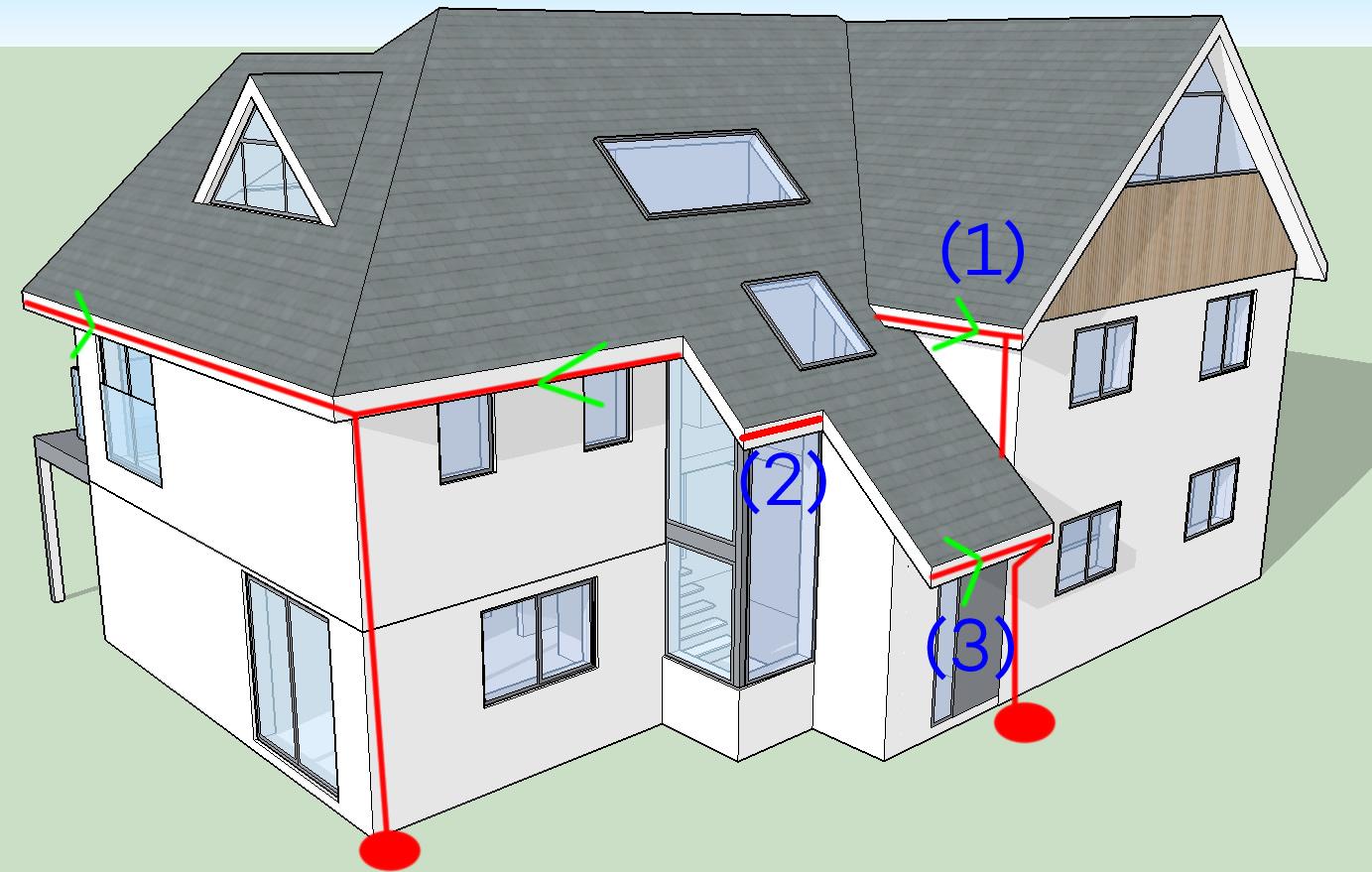

  3. Hello could anyone help me on some guttering design. I have attached an image: (1) Do you agree that its best to run this gutter away from the valley? (a) If i run away from the valley should I drop onto the sloped roof below or take the downpipe all the way to the gulley pot? (b) or should I run towards the valley then I dont need any downpipes? (2) With gutter 2 could an option be for me to run to the right then at 42 degrees down the slope on the facia to connect with (3). I ideally dont want to create any more soak aways
