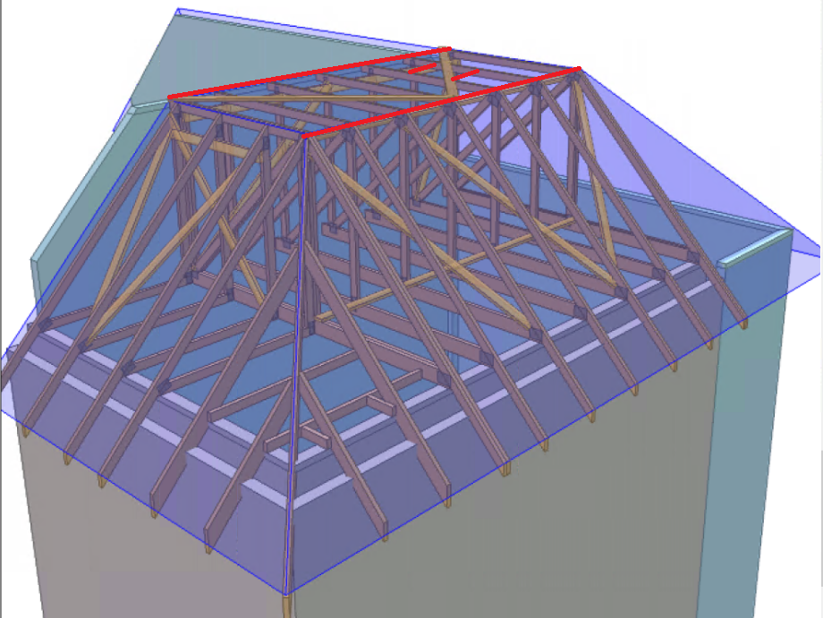

MortarThePoint Posted April 30, 2021 Posted April 30, 2021 I'm installing 25mm SE plywood sheets on a small area of flat roof approximately 3.5m x 1.75m in size. I'm using 47 x 50-0 firring strips under the ply to create a gentle fall. The trusses are only 35mm timber. I've laid the sheet perpendicular to the trusses. I'll be screwing the plywood down with 5x100mm screws (coungtersunk) so that the screws always pass through the firring into the truss. The end of the sheet doesn't fall on a truss so I believe I have two options: Cut it back to the centre of the truss and have the join between sheets there. I'd be happy with that if the truss timber was wider, but having a join 35mm timber feels a bit bad Add some noggins to support where the boards join. I'd make this out of 4x2 so am happy there would be room for the join. I'm inclined to go with option 2. Which of A or B would you go for? The yellow trusses are 600mm c/c. Also, should I be adding noggins between the trusses along the long edges of the plywood at the perimeter of the flat roof?

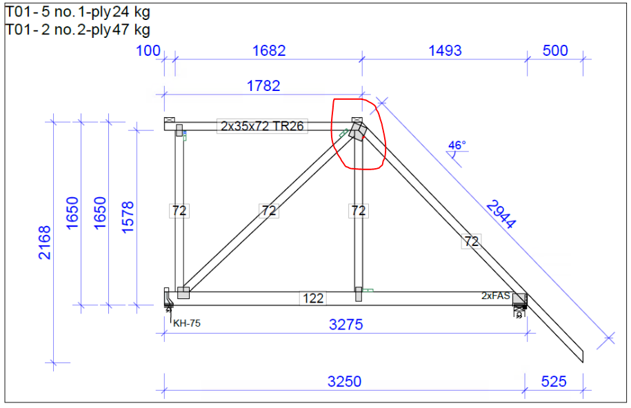

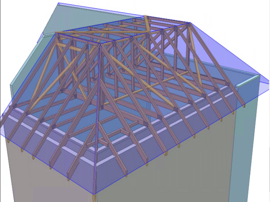

MortarThePoint Posted May 1, 2021 Author Posted May 1, 2021 I've circled here where it's going to be a pain to install noggins due to the gang nails. On the other end of the top chord there is some space. 6 noggins to install along that edge. I think the two timber sections shown at either end of the top chord in the drawing are diagonal bracing that obviously can't (and doesn't need to) be there when the sheathing is on.

MortarThePoint Posted May 1, 2021 Author Posted May 1, 2021 (edited) 2 hours ago, joe90 said: I am not a fan of always joining boards on rafters/joists,(even plasterboard) I would instal noggins at 400mm centres and lap some off cuts of ply between the noggins across the ply joins underneath, glue it as well if you want. I like this approach, but wish there was more meat to the top chord as putting 4no. 5mm screws through it doesn't feel kind. (4no. at the ends of the top chord, 2no. in other areas). It's only 35x72 timber. I'm sure I'm probably over thinking it though. The red lines below show where noggins need to be added. Edited May 1, 2021 by MortarThePoint
joe90 Posted May 1, 2021 Posted May 1, 2021 1 hour ago, MortarThePoint said: It's only 35x72 timber. Yes, just make sure your screws are in the middle (pencil line to follow?). That’s why I don’t like joining sheets on a joist that narrow. Those noggins will be fine, 1 1
MortarThePoint Posted May 1, 2021 Author Posted May 1, 2021 (edited) 8 minutes ago, joe90 said: Yes, just make sure your screws are in the middle (pencil line to follow?). That’s why I don’t like joining sheets on a joist that narrow. Those noggins will be fine, Still have to work out how to cope with the gang nails. I guess I'll jus put the noggins as close to the edge as possible but not on the gang nails. Edited May 1, 2021 by MortarThePoint 1

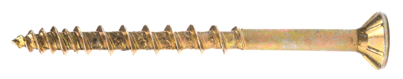

MortarThePoint Posted May 3, 2021 Author Posted May 3, 2021 Well it's looking good and sturdy, but only 2/3 done as the latest batch of plywood is 2mm thicker than batch I got last year. Crazy! I started off predrilling and countersinking, but gave up on that whilst doing the first sheet as it worked well without. The second sheet though needed the countersinking as it created pushed up splinters without doing so. I wasn't worried about lack of predrilling not pulling the sheets down as I was using a screw with partial thread. 4.0 x 70mm Screw-Tite, an excellent screw IMHO. Where the firring is thicker, I'll be using a 5.0 x 100mm screw. No glue, though I would for a floor.
