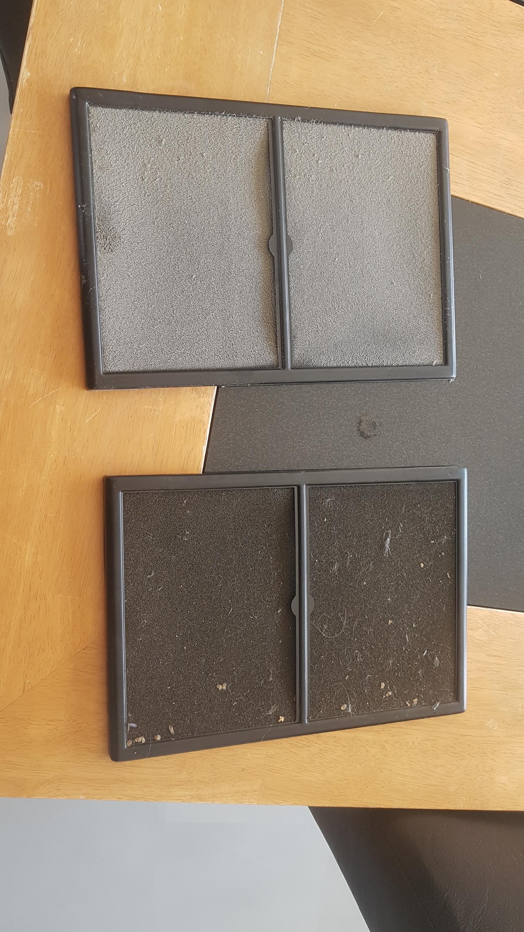

Oz07 Posted May 11, 2021 Share Posted May 11, 2021 @Marvin how do you get on with that unit. I've got the same. Recently cleaned the pre filters and was impressed at what they caught but it has been dry. It seems the unit is sealed and there is no way to change the actual filters. Link to comment Share on other sites More sharing options...
Marvin Posted May 11, 2021 Share Posted May 11, 2021 I purchased and installed a Polypipe Silavent Green Line HRX2 https://www.polypipe.com/sites/default/files/HRX2_MVHR_Technical_Data_Sheet.pdf with a summer bypass and I put all sorts of bespoke controls on it. It now looks like the name changed to the Domus HRX2-D heat recovery unit. The model is suitable for up to 275m2 floor area but I only have 106. I was careful to follow the recommended duct sizes and insulated the lot and in my small loft it was a pain in the . It runs at 20 watts on normal and has been excellent. We can just about hear it on boost. I clean the filters once a year. My filters are a different shape to Oz07's. We have had no mould issues however the 3 things I aim to improve are: Sound travelling down ducting from one room to another. Hot cooking smells cooling and travelling around the building "Wet rooms" smell removal. I am considering various options but any thoughts would be appreciated. I have only just realised that the summer by pass is the wrong name for the facility as when it is hot outside and cold inside it actually cools the fresh air when I use the heat exchanger! ? But I'm sure everybody else knows this. Link to comment Share on other sites More sharing options...
