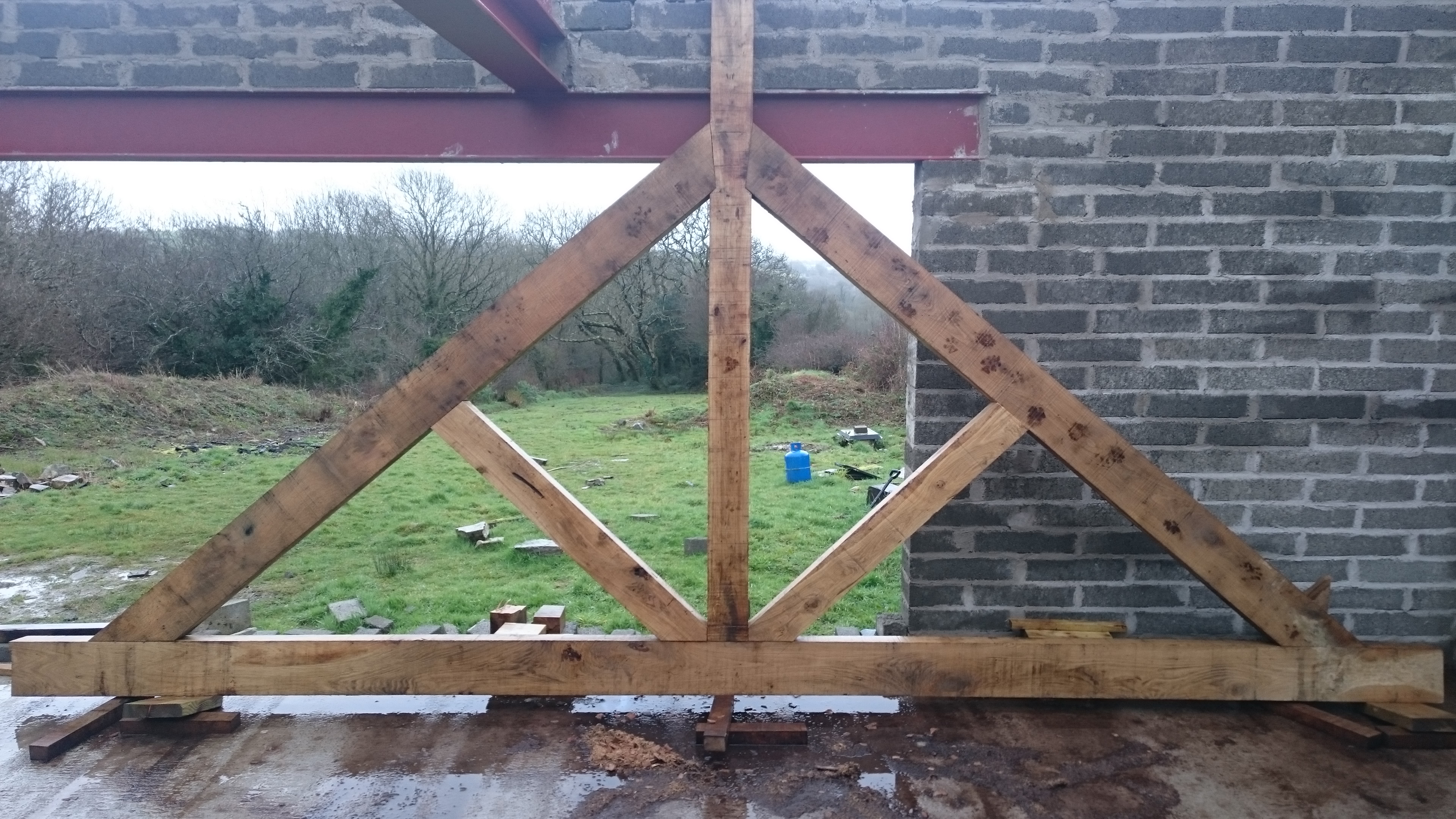

MarkH Posted March 30, 2017 Author Posted March 30, 2017 (edited) On 27/01/2017 at 07:44, Crofter said: Glad it worked out, keep us posted with your project Trusses done. Here's one of them (kingpost yet to be cut down, by the way). I might leave those dog footprints... Edited March 31, 2017 by MarkH 2
