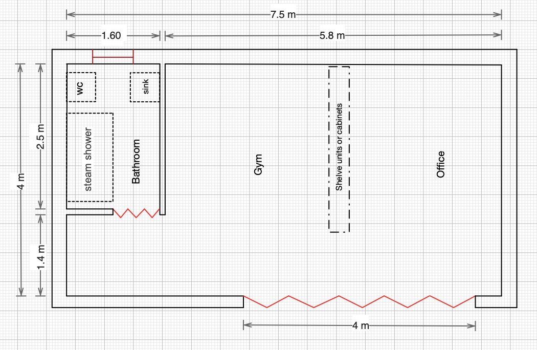

Good Evening,
I am building a new outbuilding in my back garden. I am trying to figure out what the best electric heating solution (CH + HW) would be and I would like to ask you for your opinions here.
The outbuilding will contain an office, a gym and a small bathroom with a steam shower unit and a sink as per the plan below. It will be used throughout the year on a pretty much daily basis.
I initially thought about using electric heating mats for my UFH and a small boiler for my hot water needs but now I think there may be a better, more cost effective solution.
I have seen a number of threads talking about ASHP, Ampec flow boilers and Willis heaters. It made me think about fitting a wet underfloor heating system and using one of the solutions but honestly speaking I am not sure what would be best as my knowledge and experience is limited.
I would be very grateful for any advice.

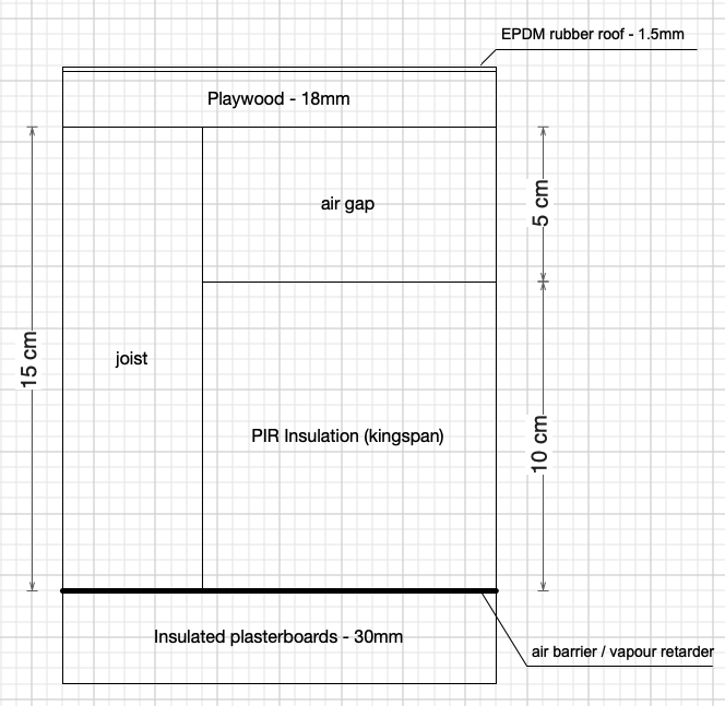

 What are your plans for the walls and roof? Roof detail is of importance too.
Flat Roof:
I am thinking of 6x2'' joists and 18mm external grade plywood. Then 100mm PIR between the joists and plasterboards from the inside. I don't know what I am going to cover the roof with. I started researching EPRM. Any ideas would be much appreciated.
Walls:
150mm solid wall (Thermalite blocks) with external insulation (50mm or 100mm).
Do you think I need more insulation on the walls and the roof?

Then 100mm PIR between the joists and.....
.....30mm insulated plasterboards so you lose the cold bridging of the rafters. Heat rises, so pay the most attention there. Use foil tape to seal the 100's to the rafters and same to seal the insulated roof structure to the top of the internal vertical walls, immediately prior to boarding the walls.
Rubber roof membrane or GRP, but rubber is the quietest in the rain. Nicer for an office environment / phone calls etc IMO.
Roof, as above, walls good enough to not invest more IMHO. If nothing discernible being affixed internally, then 30mm insulated PB to the interior would further improve things.

Roof
If you do what you describe with the 6x2s, PIR, and plywood then your plywood is never going to dry. Why?
Putting a sheet of plastic (air/vapour barrier) on top of grass gives you...moisture under the plastic from the moisture generating activities underneath. Do the same with your roof (EDPM or felt air/vapour barrier)...and it will rot.
Your flat roof needs to be:
- waterproof layer (EPDM better than felt)
- support layer (OSB is fine)
- VENTILATION gap
- Insulated roof structure
- Airtightness / vapour retarder
It's fine to have an unventilated flat roof on a shed...because the entire shed is ventilated. It doesn't work for habitable buildings.
For long life you probably want more like:
- waterproof layer
- 12 mm OSB (this is enough; go thicker if you'd like to spend more)
- spacers (use 20x50 mm battens if you are creating the "fall" in the structure of the roof; use something fatter cut to an angle if you are laying the structure of the roof flat)
- 195 mm C24 roof joists on 600 centres to span the full 4 metre width and avoid any beams inside (see span tables e.g. https://www.timberbeamcalculator.co.uk/span-table/flat-roof-joists?load=1&class=C16)
- mineral wool between these
- airtightness layer/vapour retarder (without holes through it)
- plasterboard
To save on height run all your cables and ventilation at high level in the walls, rather than in the ceiling. (anything that "crosses" joists should be run in the walls) Where they must go in the ceiling put them between the joists so that the plasterboard "pushes up" the membrane and the insulation slightly - fine for cables for lighting or alarms etc; don't try it for deep downlighters; and don't fit downlighters anyway wall washers will give you a nicer light)
Alternative?
Going for a shallower roof means a bigger fall (and letting it bend a lot) and/or internal structure (to support the shallower joists at midpoint).
If you could tolerate a post where your "shelf wall" is, and making the partition wall between bathroom and gym structural, then you could have a "ridge beam" running from left to right and a very shallow dual-pitch roof with joists that are only 2 metre span. Then you're into C24 45x95s on 400 centres (or 600 centres if ok with it being bendy) rather than 45x195s.
You could go with structural panels at that point; as they easily span 3 metres but are dubious at 4 metres unless you go for particularly fat ones.

Sturctural
Single sole plate and header plate on the walls. Line up your roof joists with the wall studs on 600 centres.
Careful on BIG openings.
You will need a structural header above the big door to carry the roof joists. Maybe 2x 195x45s in C24 - use something like this to check https://www.timberbeamcalculator.co.uk/)
Push this to the TOP of the wall so that all the load is carried at high level by two pieces like this ||. Then have another piece of 145x45 mounted like this _ above your big door but don't put any vertical sticks between this and the roof. Why? These pieces || provide the roof strength. They will bend as the roof is loaded up. This piece _ provides the in/out strength for the door but has all the structure of we spaghetti in the vertical direction. By separating the loads you will avoid jamming the door or busting a window under a large opening in the timber frame.
The other option is making a "solid" wall (with vertical sticks between your header and the the top of the window opening) then putting the window OUTSIDE the timber frame on an OSB or ply box. This way the wall can move under load, and the OSB/ply box will bend so that the window can stay the same size even as the size of the hole in the wall changes)
(most fixed windows have 5; maybe 10 mm of movement between glass and frame before you run out of room and start loading up (breaking) the glass; most moving windows/doors can only allow 5 mm of outside frame movement before they stop opening/closing/sealing correctly; big timber frame openings will move more under load than you might expect; and not all window/door people that are used to selling to brick and steel constructions will give you the right mounting details for a timber frame)
Floor
If you have a raft already then gluing some foam and structure on top as nick suggests makes sense. If you're using an engineered wood finish (basically tongue and groove plywood with some veneer on top) and you glue this to 22 mm OSB (rather than gluing it to itself and floating it) then you have the equivalent of a 40 mm kitchen worktop to walk on. It won't move and saves the extra 22 mm OSB.
Your bathroom might dictate otherwise. Are you going to have a drain in the floor there that you can hose down all the mud / sweat / human fur into? Does the steam shower need to drain into the floor rather than the wall?

The drain in the bathroom is in the floor. I have not decided on the steam shower unit but I will pick one that drains into the floor. I intend to tile the whole bathroom.
The steam cabinets are free standing in every unit I've ever fitted, so you can go out of the wall to an external drain which is less complication.
Edited by Nickfromwales
@Nickfromwales Is there any particular model that you liked and you think it would be a good fit for my outbuilding?
I can still change the size of the bathroom as the partition wall is not there yet. I already have the drain in the raft foundation but I can still go with an external drain.

Thank you @Nickfromwales and @markocosic for all your comments and recommendations.
Based on what you are saying, I came up with this picture of my roof:
Please, could you help me with the following:
  1. For the rubber roof, what product would you actually use and what thickness. I am looking at EPDM Rubber Flat Roofing Supplies | Rubber4Roofs but I am not sure if I am looking at the right thing....
  2. For the air barrier, could I use this product: Powerlon Air Barrier Membrane - 50m x 1.5m Roll | Roofing Superstore®? Or is there any better product you would recommend?
  3. Do I need anything between the plywood and the joists / air gap?
  4. I planned on having spotlights / downlights as I thought they would be best for the office / gym area. However, I understand that I should not break the air barrier.... Do you reckon that wall washers would be really better? Is there any specific product you would recommend?
Edited by MP1
@markocosic
20 hours ago, markocosic said:
Given where you are already it'll be your final finish (render? cladding?) that dictates what you do here more than anything else.
I think it will be monocouche render to match what I have on the house.
Kinda yes to your build up.
If it were mineral wool then nothing between ply and the top of the joists. It will all air dry. Leave those channels above the insulation "open" to the outside air by venting them into the soffits. That is how any moisture going through your roof will be cleared. Then vapour control layer where you've drawn it
If PIR boards and you mount these PIR boards level with the bottom of the joists then the foil tape over the gaps as Nick described. It will be cheaper/easier than a membrane. The barrier is still in the same location as you drew. You can't make holes in it which I think answers your downlighter question.
The "insulated" plasterboard will give you somewhere to hide any ceiling cables. (router / gouge out a little of the insulation so that you don't push the PIR boards upwards and tear the aluminium tape) That works for surface lights and for surface mounted spotlights.
What about slim downlights you ask? (e.g. 25 mm depth for 40 mm void) Careful. These usually need ventilation from above. They're meant for fitting into an uninsulated "service cavity" not a "pocket" in insulation and will cook if you try encasing them in insulation. Many also have remote drivers that you'll need to find space for too. For example here @ 40 mm:
https://www.expertelectrical.co.uk/aurora-enlite-slim-fit-shallow-led-downlights#product-info-dimensions
Maybe you can find something that doesn't need ventilation. Personally I hate downlights especially for an office. You'll have horrible hard reflections off all horizontal surfaces; such as your desk; and also off your angled screen. I fitted them once because she who must be obeyed wanted them and apart from vacuuming/scrubbing the floor - and the bathroom - they're never used. Spotlights will be better but you'll end up trying to bounce the light off walls rather than directly lighting objects.
This kind of light is soft and forgiving on the eye and on the workmanship:

Thank you @markocosic
I reckon you are right about the downlights and their suitability for an office I need to really think what lighting would be best for my video calls too. Thanks for all the ideas and suggestions.
I still have my doubts about the rubber roof. I will have two 600x900 skylights. Do you think I should go for EPDM? If so, any particular thickness and brand you would recommend? Any suggestions would be much appreciated.
