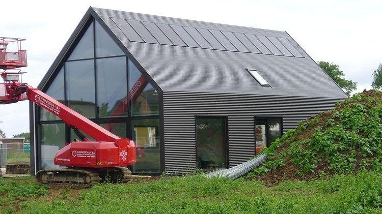

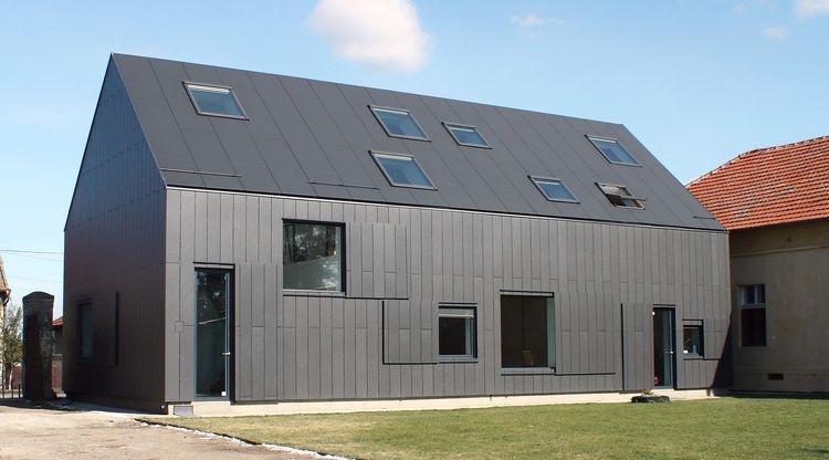

Standing seam - I suspect the first image that you attached looks messy because nothing lines up (roof vs walls) and the walls are covered in unnecessary seams. (that length can be made in one piece) Standing seam roofing can be premade zinc plated / powder coated steel too rather than made off the roll. Max off the shelf length on Rukki is 10 metres. It's ~€15/m2 in the baltics but how much it would be to import to the UK though.

You might want the opposite with MORE seams (or ridges) to make them less prominent rather than a hard seam every 500 / 1000 mm though? I think this looks clean because the seams between panels are much less visible, they're the same on the roof and the walls, and the gutter breaks any mismatch between roof and the wall:

Could be a trick of the camera but to me, there doesn't seem to be much of a seem on that build which is what draws me to liking it (I agree the roof and walls need lining up though). I also like the width on the roof, but appears much wider than what I have been told is possible with zinc (circa 500mm Max).

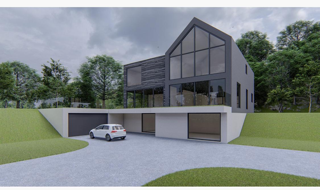

The bottom grand designs image I would need to see in the flesh, it appears clean and contemporary but I'd be concerned it looks too barn like close up for what I am trying to achieve (fine for them as it's on a small holding). Fortunately it's local to me so I might see if I can take a peek. For reference, this is what I am cladding (there is a bit to be worked on still - gable to be recessed and the flat roof part to be tweaked to be more interesting, ground floor won't be white render)....

That first one looks like ~500 mm standing seam on a 9-10m long "1.5 storey" building (left side full height) to my eye - scale it from the velux windows?

I thought the roof on the first one looked wider than 500mm seams but could be wrong (I was looking at what appears to be the doors at the front and rear which appear to be similar to the roof width, and guessing these doors are 850mm or so). Other detail I do like is the walls sides have no seam, and the roof is hard to tell but at the very least a low seam. Not so keen on the tiles (slate or zinc)  as I find them a bit busy for the walls. Thanks for the help  - keep the suggestions coming!
