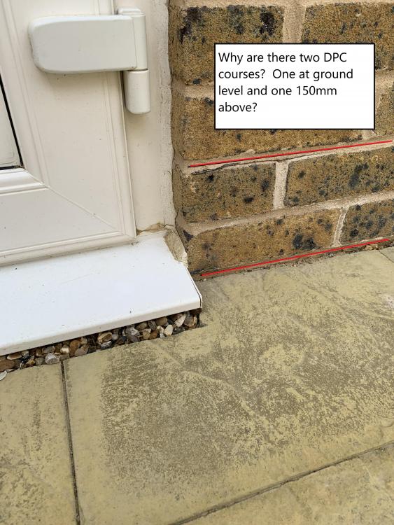

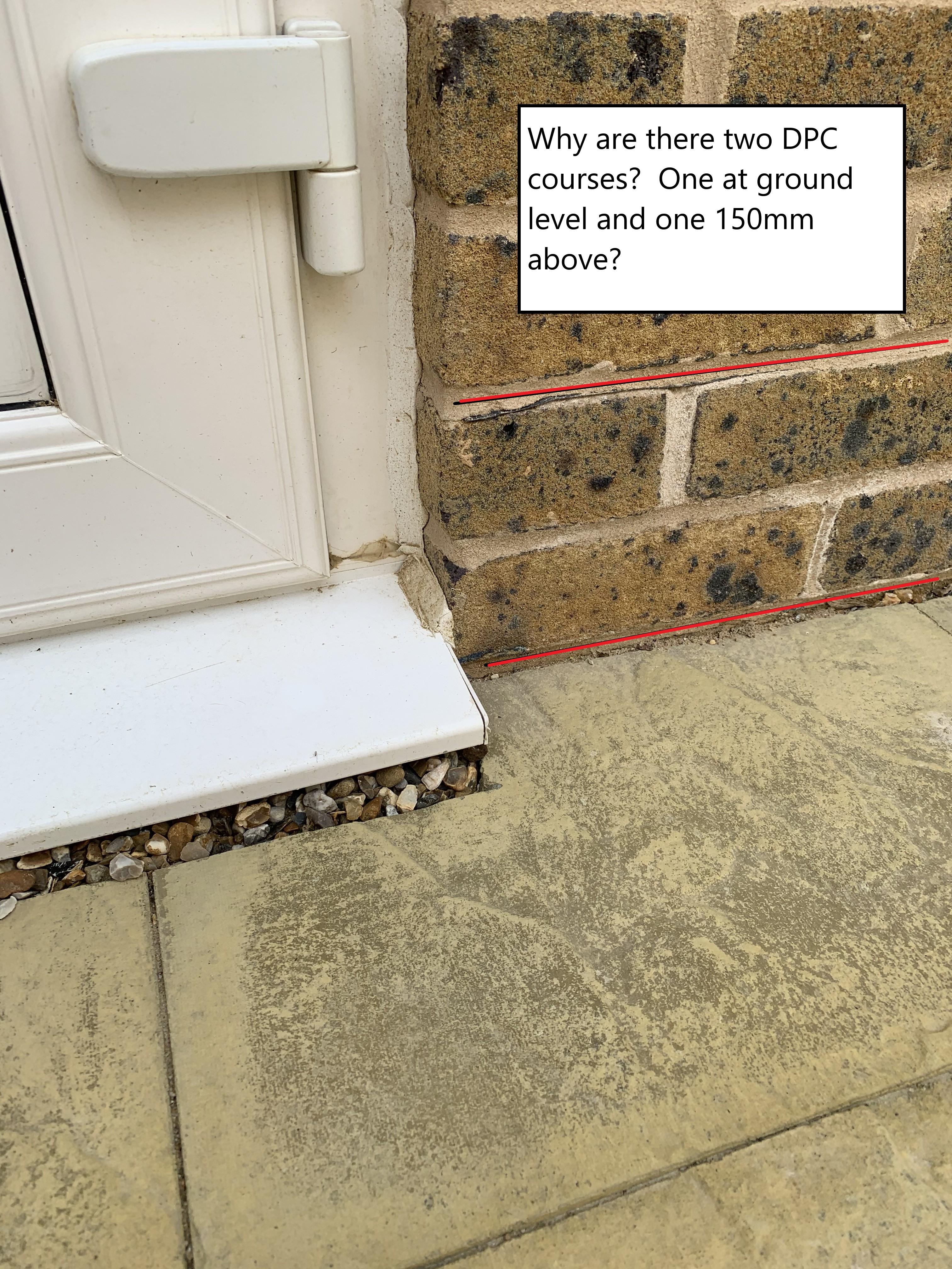

kgg Posted April 12, 2021 Share Posted April 12, 2021 Surely this does not meet building regs? I can only assume they just got the levels wrong? internal floor level is the same as the patio. Thanks in advance. Link to comment Share on other sites More sharing options...

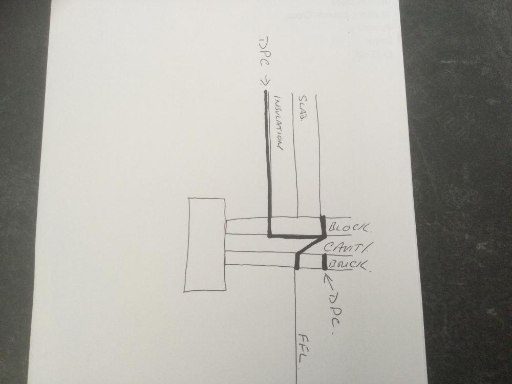

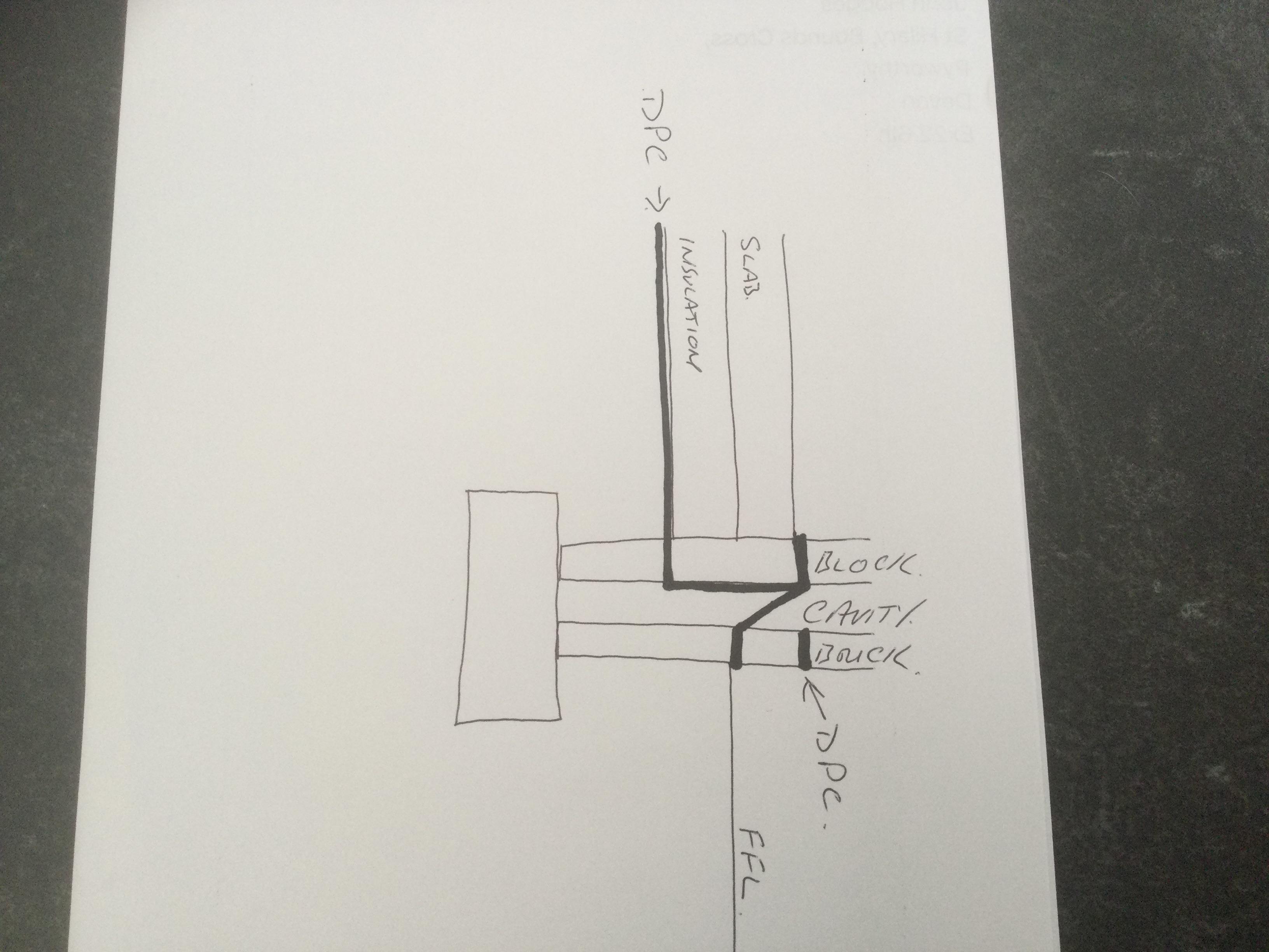

joe90 Posted April 12, 2021 Share Posted April 12, 2021 (edited) Not necessarily, I have two DPC,S. The bottom DPC is sloped in the cavity to carry moisture out via weep vents, the upper DPC is to stop rain splash soaking the wall. Edited April 12, 2021 by joe90 Link to comment Share on other sites More sharing options...
Brickie Posted April 12, 2021 Share Posted April 12, 2021 Your patio level is what’s known as ‘level threshold’-there’s no step up into the house as there would have been traditionally. The lower dpc shown should be a continuous barrier all the way around the building, at that level,on both skins of masonry. A level threshold presents a risk that rain splash will affect the wall above dpc level (not having the standard 150mm clearance from ground level) & so an additional dpc is installed,extending a minimum 1m past the raised ground level & lapping down to meet the dpc lower down. 2 Link to comment Share on other sites More sharing options...
kgg Posted April 12, 2021 Author Share Posted April 12, 2021 Brilliant, thanks. Link to comment Share on other sites More sharing options...
epsilonGreedy Posted April 12, 2021 Share Posted April 12, 2021 1 hour ago, joe90 said: When did your house fall over? 1 Link to comment Share on other sites More sharing options...
joe90 Posted April 12, 2021 Share Posted April 12, 2021 15 minutes ago, epsilonGreedy said: When did your house fall over? Bloody IPad, it does not matter which way I take photos it turns them around, ? Link to comment Share on other sites More sharing options...
SteamyTea Posted April 12, 2021 Share Posted April 12, 2021 6 hours ago, joe90 said: Bloody IPad, it does not matter which way I take photos it turns them around Try putting the sketch against a wall, then take a picture. It could be that the orientation sensor is confused. It iCrapple does not always 'just work'. Link to comment Share on other sites More sharing options...
joe90 Posted April 12, 2021 Share Posted April 12, 2021 18 minutes ago, SteamyTea said: It could be that the orientation sensor is confused. ???? will give it a go Link to comment Share on other sites More sharing options...
