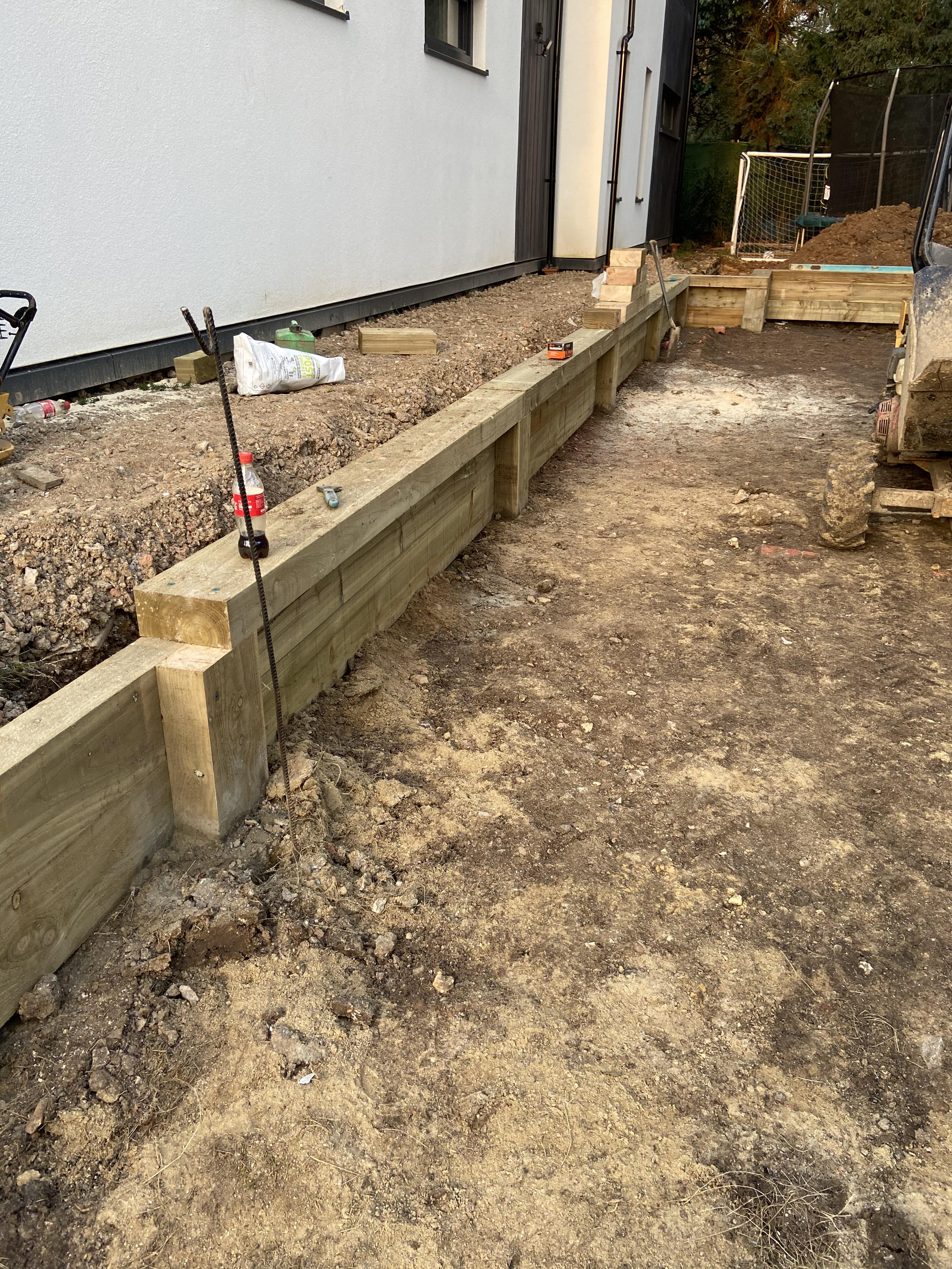

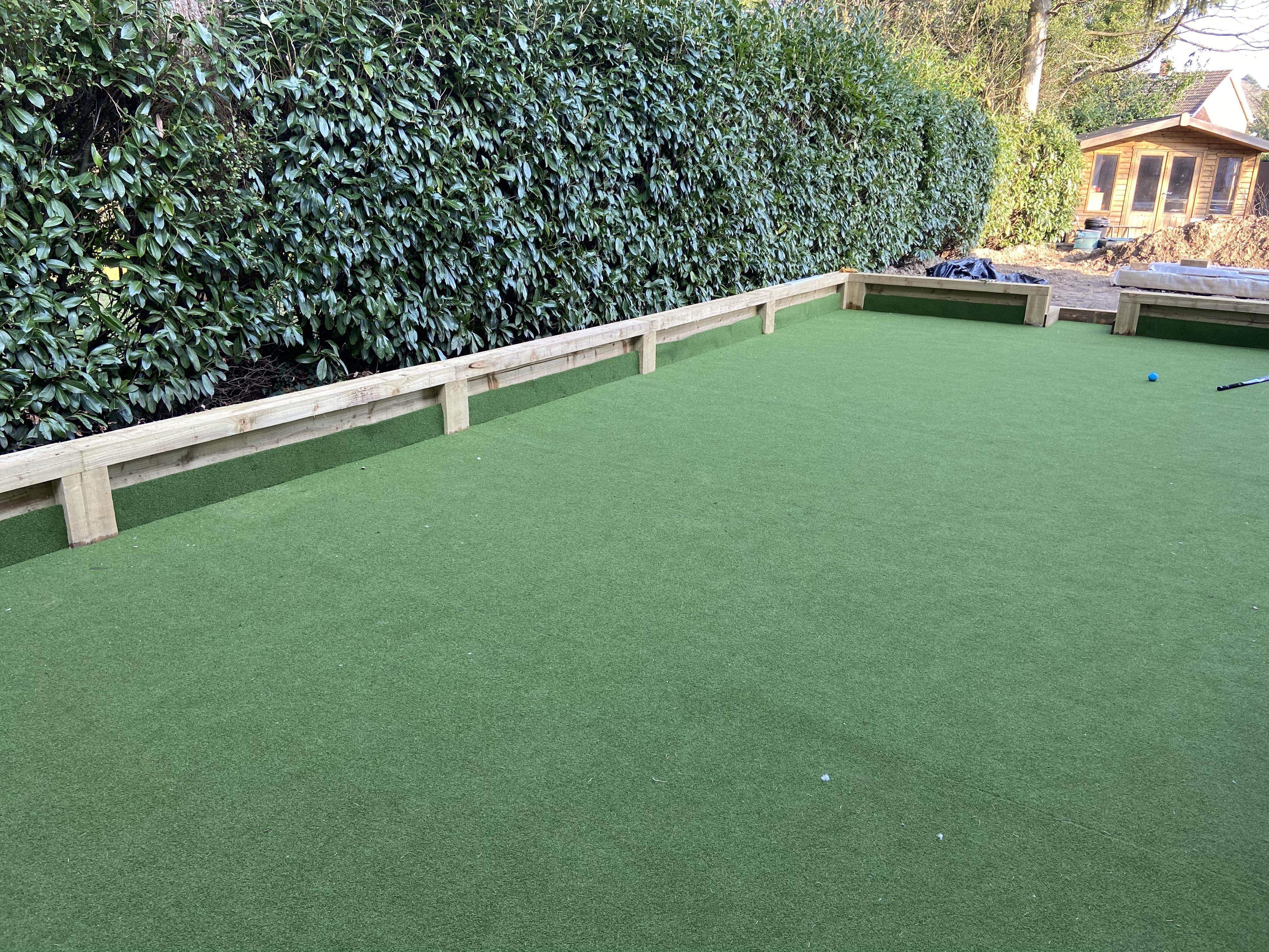

Weebles Posted April 6, 2021 Share Posted April 6, 2021 We’ve just laid a proper astro playing surface (2 hockey playing kids). Sleepers worked well around the edge. I’ve also seen brick edging look good (with the astro screwed onto battens). Or a piece of treated timber if you don’t want the height of a sleeper. If you are sand dressing it the weight of the sand will help keep it in place . We were advised to screw to battens though we ended up with the astro covered gravel boards holding it down. before and after shots below. we’ve gone for a high edge but the theory is the same I guess. Link to comment Share on other sites More sharing options...

Toppers Posted April 13, 2021 Author Share Posted April 13, 2021 On 06/04/2021 at 13:50, Weebles said: We’ve just laid a proper astro playing surface (2 hockey playing kids). Sleepers worked well around the edge. I’ve also seen brick edging look good (with the astro screwed onto battens). Or a piece of treated timber if you don’t want the height of a sleeper. If you are sand dressing it the weight of the sand will help keep it in place . We were advised to screw to battens though we ended up with the astro covered gravel boards holding it down. before and after shots below. we’ve gone for a high edge but the theory is the same I guess. I'm thinking the sleeper on edge may be the best option, would I need to concrete it down or is there another fixing method? Link to comment Share on other sites More sharing options...
Weebles Posted April 15, 2021 Share Posted April 15, 2021 We used postcrete to secure vertical bits of sleeper where the horizontal ones join each other. Over engineered for sure but that’s what happens when you have two (ex) engineers and a project ? Link to comment Share on other sites More sharing options...
