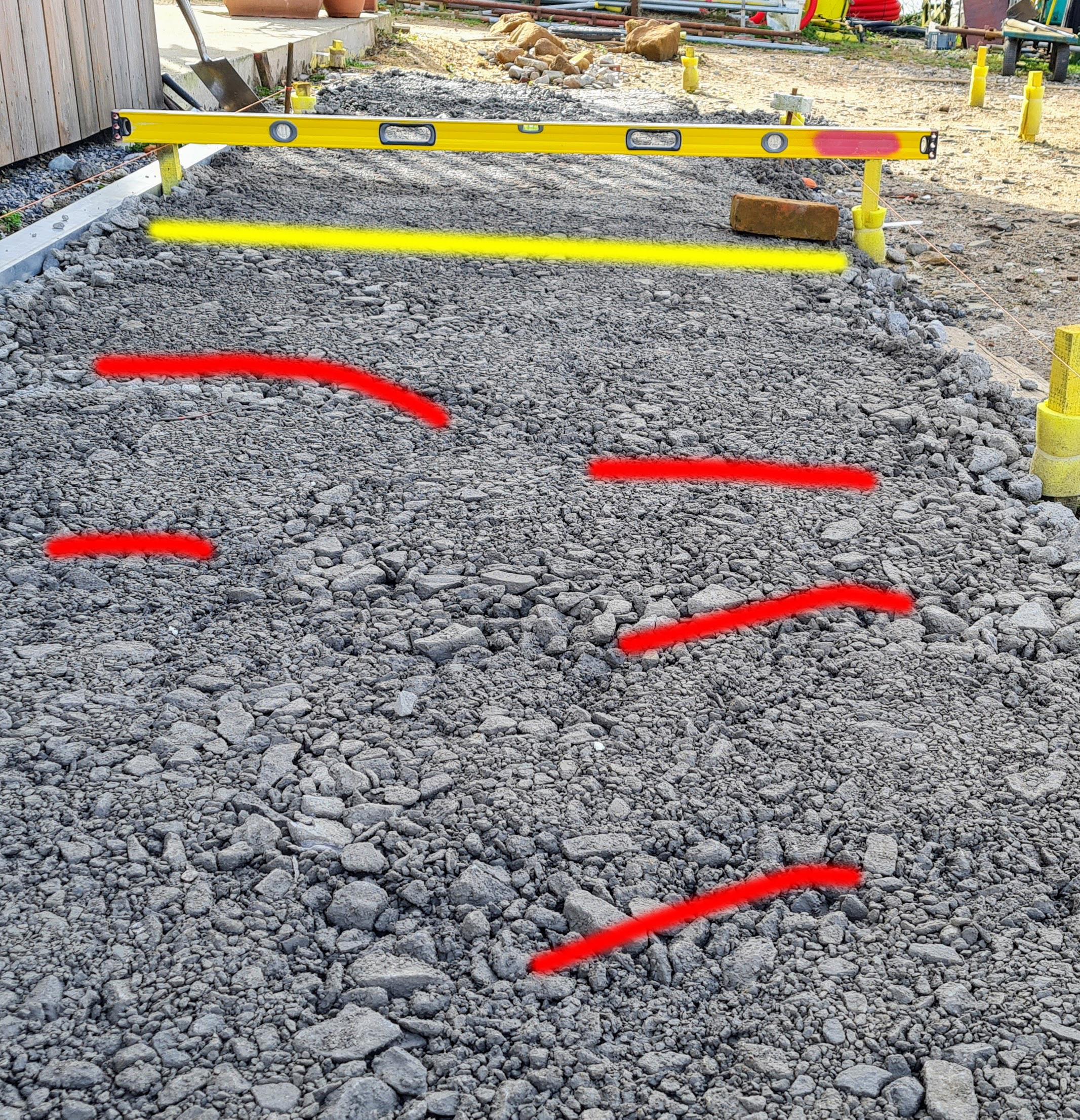

ToughButterCup Posted March 30, 2021 Posted March 30, 2021 (edited) Sounds daft dunnit? But in the context of making a flat footpath, not so silly. Build up so far MoT1 thoroughly compacted over four years Crusher Run 64mm to dust whacked flat - ish (about 100mm deep) Have a look at this to see what I mean The desired cross-fall ( left to right) is shown by the yellow line beneath the level. Thats as I want it almost. The red lines show where, when you look carefully across the compacted base , you can see the edges of the barrow-load dumped on the spot. It shows as a sort of flattened ripple. As I understand it, the next layer should be sharp sand (20mm approximately) . Using the sharp sand, will it be possible to 'iron out' the slight dips in the compacted crushed stone layer? Or do I have to scabble it loose until that layer is completly flat , recompact and then lay the sand? I'm beginning to think I'm addicted to painfully steep learning curves. ? Edited March 30, 2021 by ToughButterCup
TonyT Posted March 30, 2021 Posted March 30, 2021 https://thecobbleshop.co.uk/product/whin-dust/ we use a lot of whin dust to flatten out surfaces
PeterW Posted March 30, 2021 Posted March 30, 2021 19 minutes ago, TonyT said: https://thecobbleshop.co.uk/product/whin-dust/ we use a lot of whin dust to flatten out surfaces Also know as grano in other regions..!
Declan52 Posted March 30, 2021 Posted March 30, 2021 1 minute ago, PeterW said: Also know as grano in other regions..! Quarry dust here.
