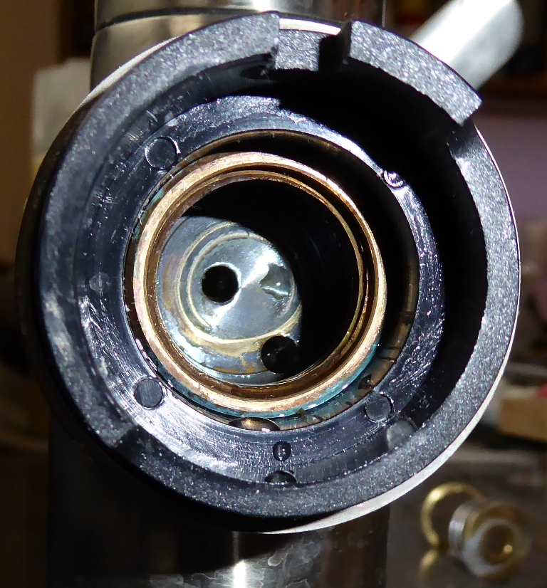

Out of interest, was it the taps that failed with the Franke?  The reason for the failure of our tap (2013 model, now superseded with a different design) was the drilling in this photo being far too close to the edge of the ceramic valve base seal:
58b6bc692affc_Witnessmarkintapshowingsealdisplacementsincenew.thumb.JPG.cc85548452733db70c18bf0f07c6c420.JPG
You can clearly see where the bottom drilling is right where the seal should be seating (the mark is the stain left by the seal).  On the new design that drilling isn't there,  it comes in from the side of the bored hole, leaving the bottom of the recess flat for the seal to bed on properly.

I do hope we don't have any tank problems, as that would be expensive to sort, now that the price has been hiked up so much.  It's been OK for a couple of years, so fingers crossed it's got over the initial part of the reliability bath tub curve.
There was a change to the design of the push button that pre-dated our first tap, as Itho have instructions on how to replace a moulded plastic part with a newer design of metal part on their website.  Our old tap already had the newer part fitted, it just had the drilling flaw.
