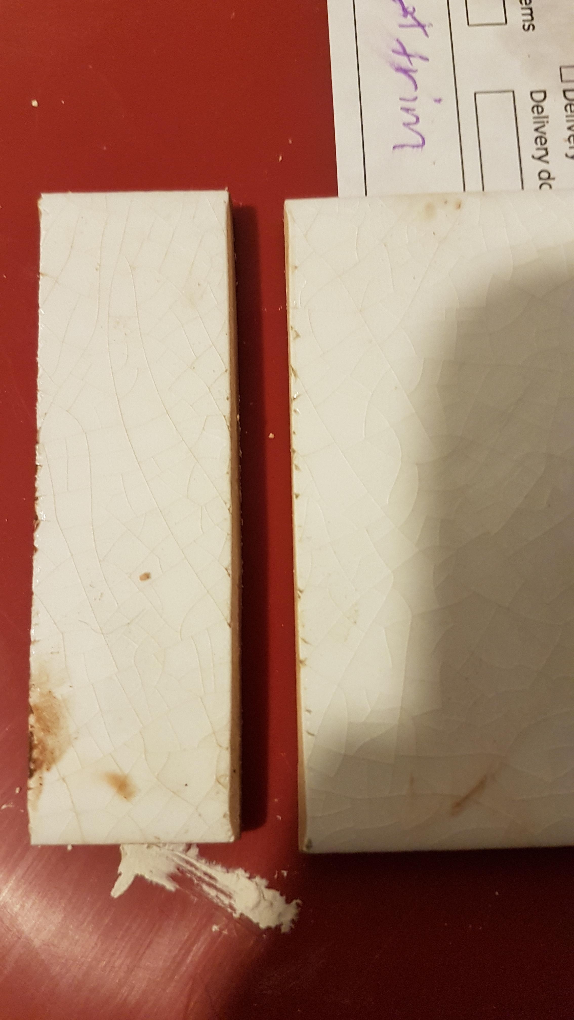

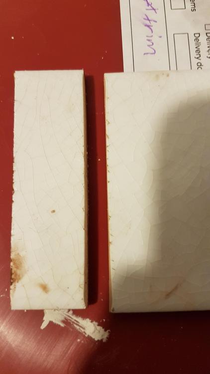

MikeSharp01 Posted March 23, 2021 Posted March 23, 2021 Anybody got any good ideas for cutting crackle glaze tiles without edge damage. Can't get better than attached with wet wheel. Left is cut and diamond polished bevel right is as cut with slight diamond bevel. Left shows too much base to be acceptable while right is too damaged without diamond polishing. Any thoughts?
Vijay Posted March 23, 2021 Posted March 23, 2021 I can't give any help with the cutting, but if you can't find a solution you're happy with, any way of painting in any of the base showing through?

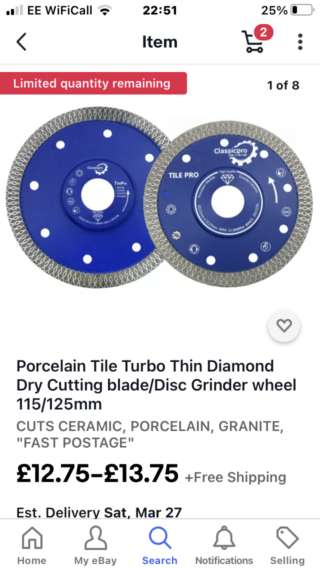

nod Posted March 23, 2021 Posted March 23, 2021 I use these Fast cutting ultra thin Spray a little cutting compound to stop scorching

MikeSharp01 Posted March 24, 2021 Author Posted March 24, 2021 18 hours ago, nod said: I use these Fast cutting ultra thin What machine are these for, angle grinder or a tile cutting machine? Also what is the lube if not water. I tries cutting with water but the muck gets in the crackles! (Not acceptable to customer - our daughter!)
MikeSharp01 Posted March 24, 2021 Author Posted March 24, 2021 Ok, I have them on the way. Many thanks. Mike
