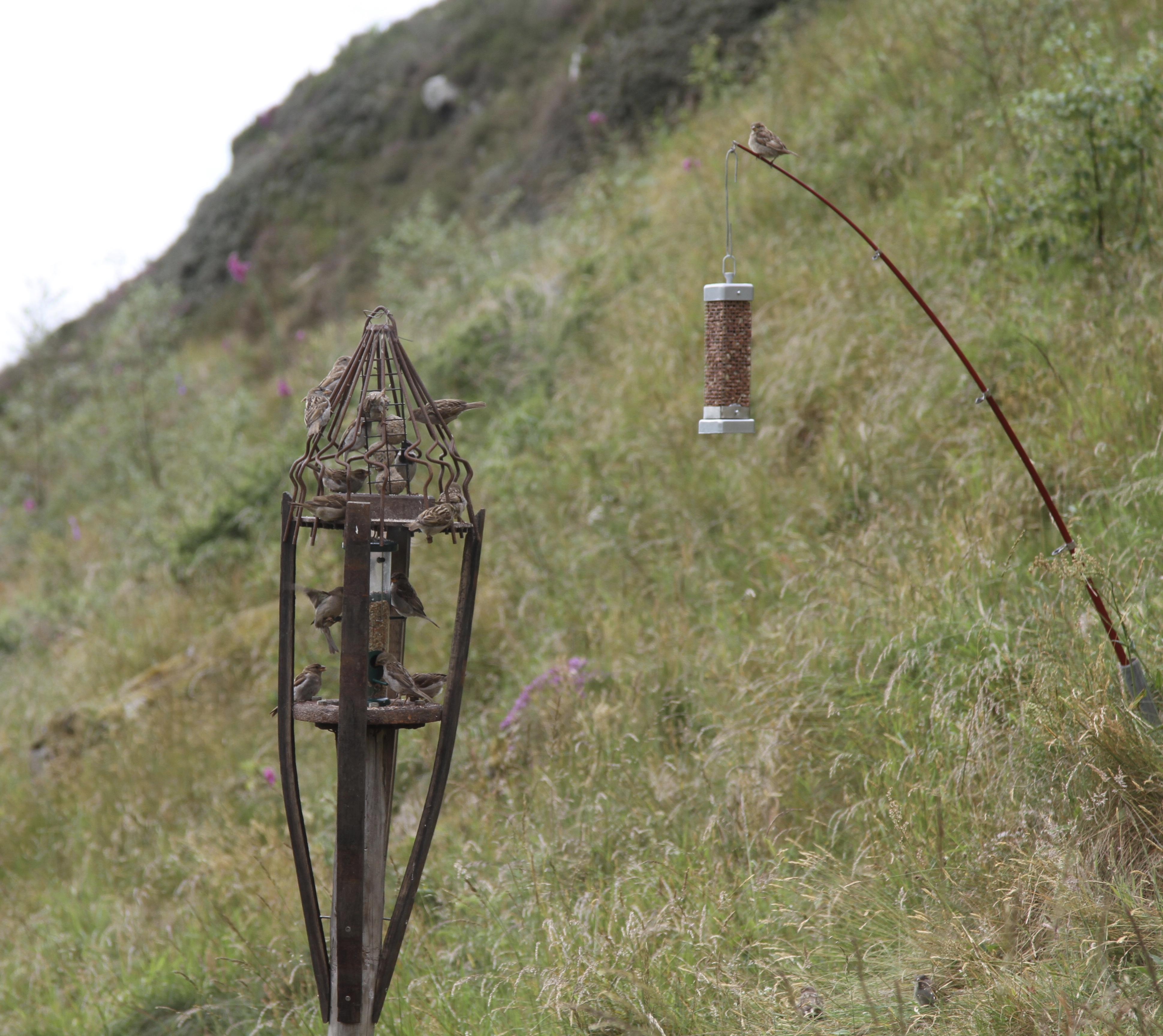

Cpd Posted March 22, 2021 Share Posted March 22, 2021 1 hour ago, MortarThePoint said: We're planning to fit a wire Tepee: A cowl with a lid would make a big reduction to the water entry. 40 minutes ago, PeterW said: They are crap and stuff ends up in them. Have seen birds nest on them As Peter says they are crap and there are far better options, this is what I did with the one on my chimney! 1 1 Link to comment Share on other sites More sharing options...
