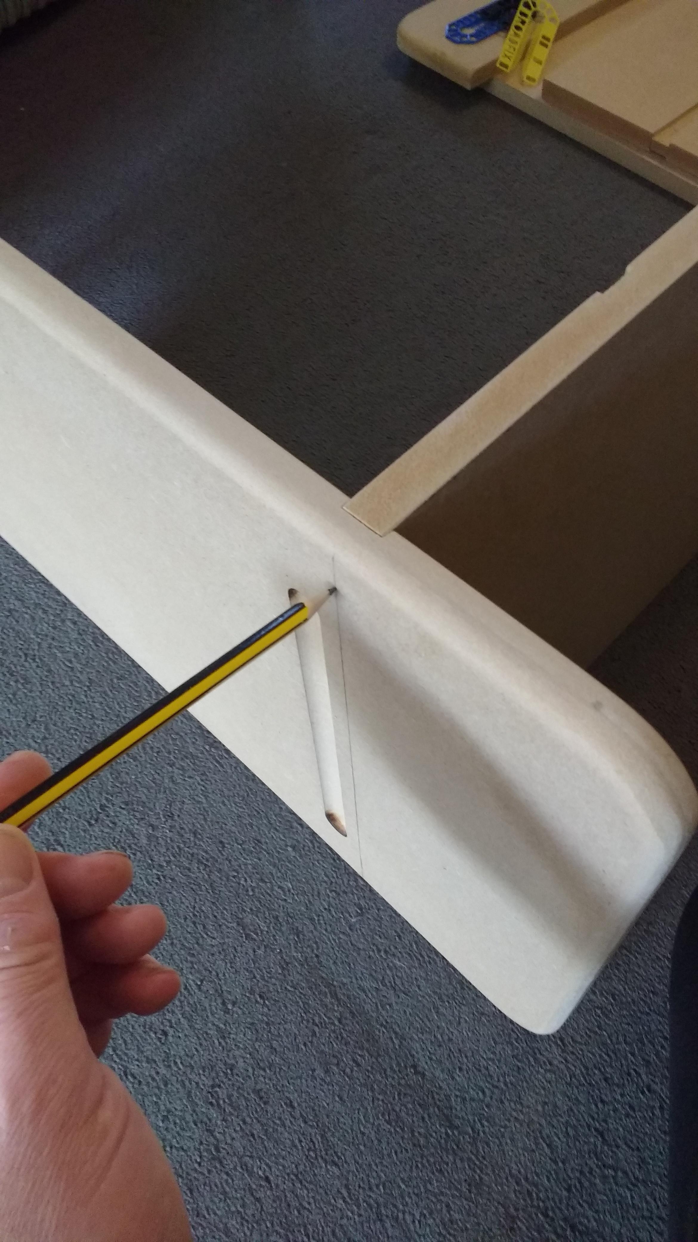

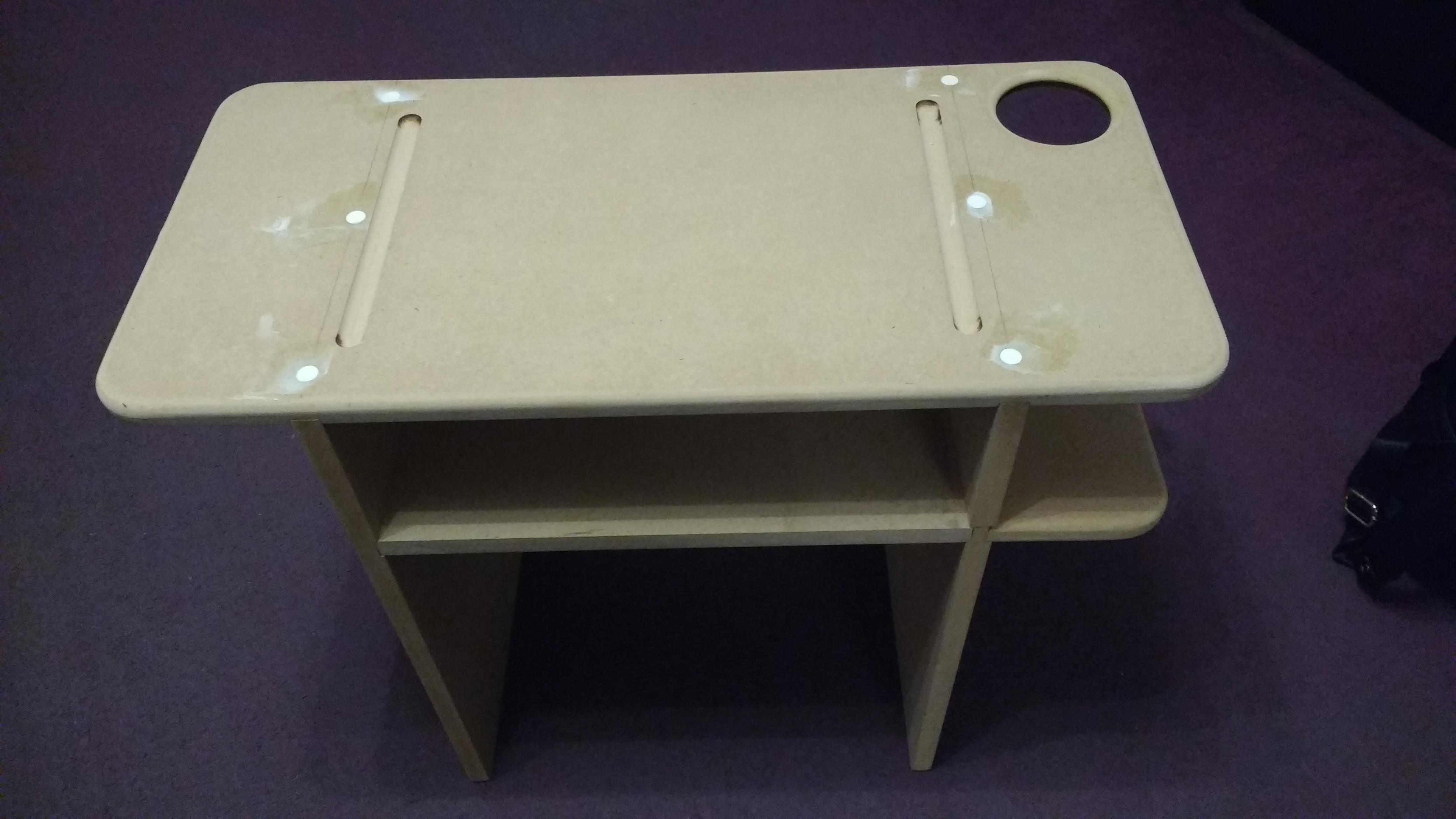

Making a quick bedside table for No2 daughter in 18mm MDF. Space for her laptop, a shelf and bottle holder. She dictated how she wanted it. It'll be primed then roller painted black, probably with Bedec barn pain.
I've glued with Gorilla glue and screwed with  4mm Goldscrews. Screw heads counter-bored as a feature and will be filled. (One joint is tbh just Gorilla glue so currently sat weighted down with some heavy books).
Done now but one thing I never know, is there a need, particularly in MDF, to pilot drill first before screwing? I always do tbh.

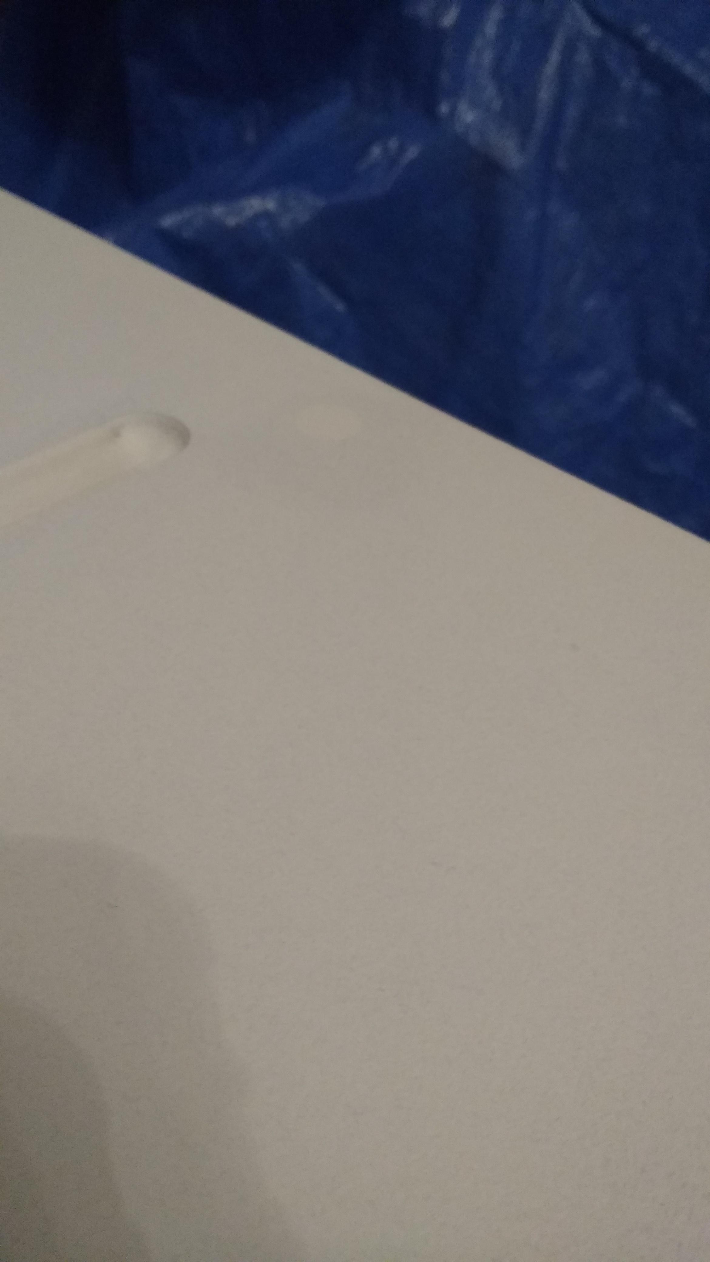

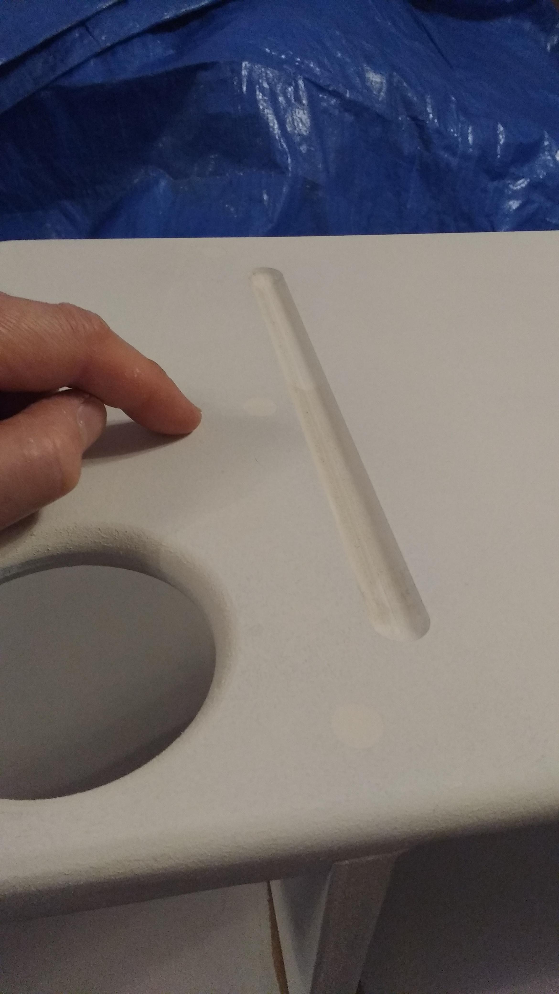

Counter-bored and filled my screw holes, deliberately, as I'm aiming for them flush.

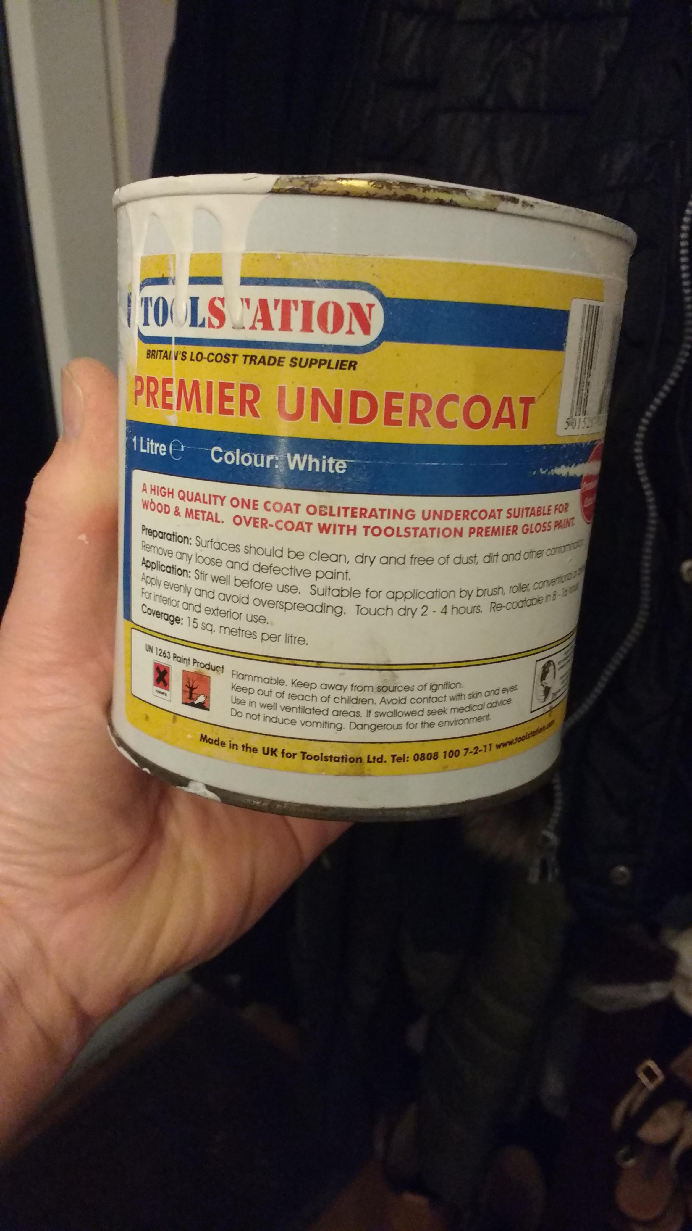

This is the primer I used, an old tin and I've no idea what sort of paint it is:
Smells like "proper" paint and just about washes out with copious Fairy liquid and hot water.
Looking for something I can fill over the top of the primer. Any ideas?
more primer?

I'll see what it looks like with a second coat.
