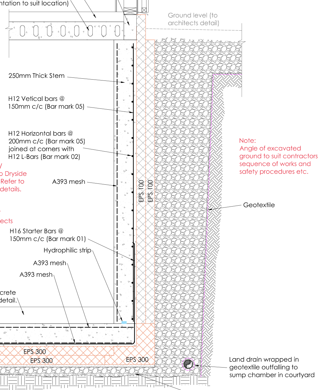

EquiumDuo Posted March 4, 2021 Share Posted March 4, 2021 Hi All, been a while since I've posted due to trying to buy the damn piece of dirt, but we now seem to be weeks away rather than months as we are imminently about to sign a contract. I'm working with a structural engineer to try and sort out a basement wall/structure. I'm trying to get ahead of it and I am not understanding how the insulation will fit in. Briefly this is a house on a hill, with an integral basement garage that we have decided to extend to fully open out underneat the house, effectively a 3x story house with the basement buried in the hill. The garage opens to street level. Typical rectangle house, 4x bed. 72sqm per floor. The garage/basement structure walls will look like this: How does the insulation fit into this? I am imagining that we fit EPS300 or something on top of the footing but under the concrete base. And also EPS300 on the esterior of the 100mm outer block? Then maybe use marmox blocks to prevent a cold bridge? Example: Whats the best practise these days? Link to comment Share on other sites More sharing options...

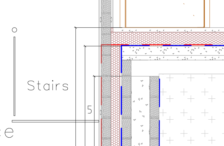

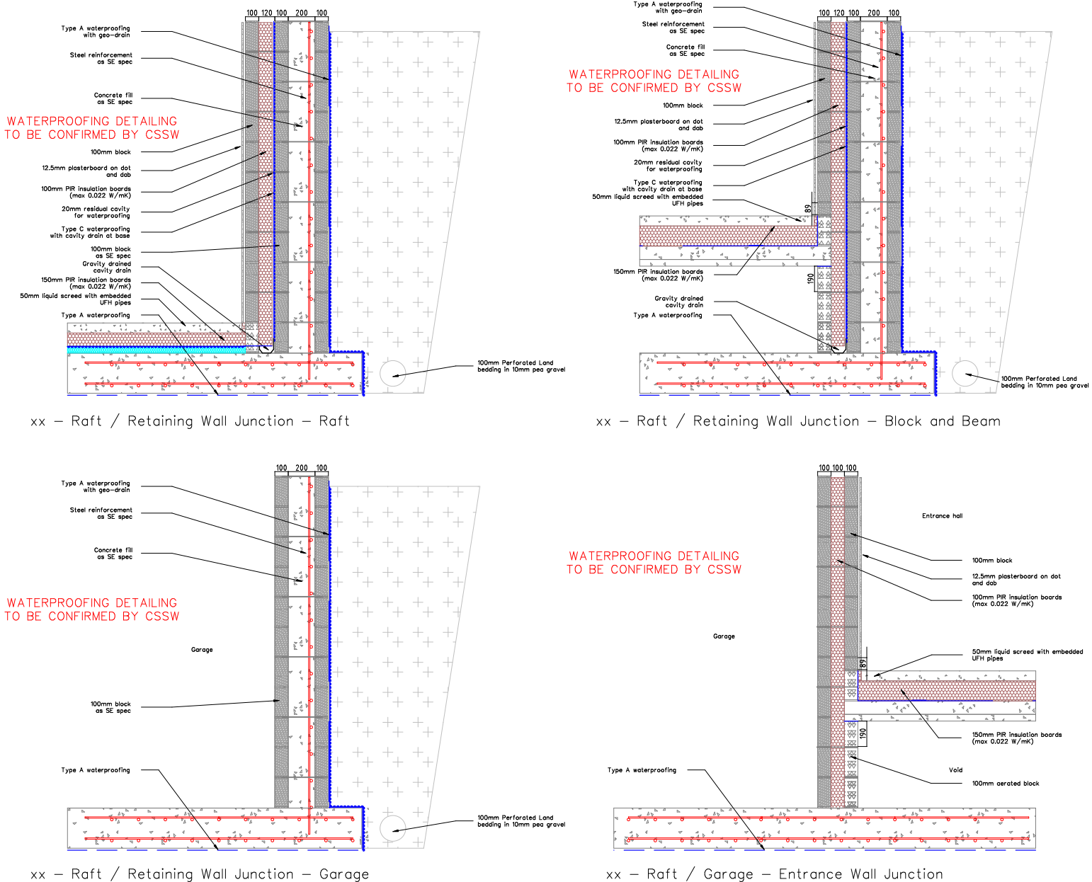

Moonshine Posted March 4, 2021 Share Posted March 4, 2021 (edited) We have the same and building a semi basement (3 sided) with with an integral garage and entrance hall in the basement. I don't know what is best practice, but this is what i am doing (work in progress drawings), and having the insulation inside of the retaining wall in a separate cavity wall, though i know others have done it outside. Also you could have a metal frame wall internally with insulations, though you need to think about the waterproofing. if you are having a structural warranty you will need two forms for habitable spaces (grade 3 - BS 8102) and one for garage (grade 2 - BS 8102) the reason for doubling up the masonry wall inside the retaining walls is that it forms a structural walls past the ground flor level, as below Edited March 4, 2021 by Moonshine Link to comment Share on other sites More sharing options...

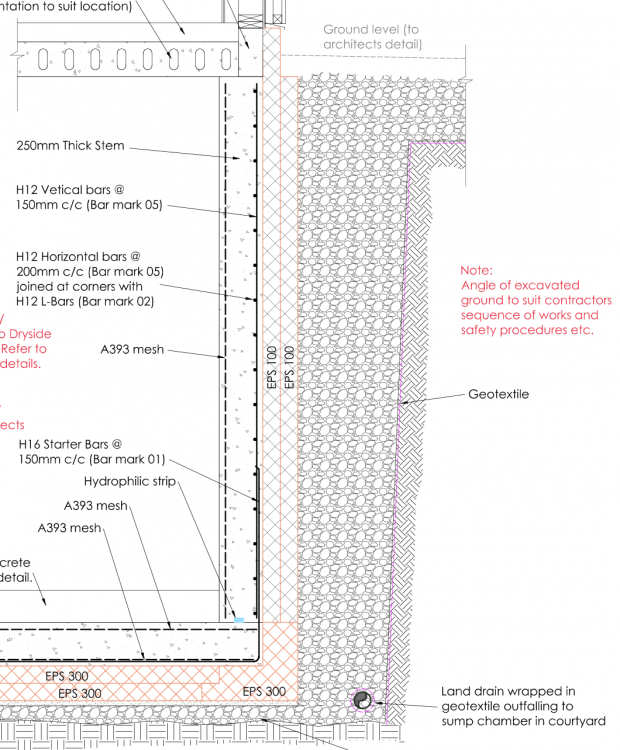

Thorfun Posted March 4, 2021 Share Posted March 4, 2021 we're having a full basement but are going for an insulated slab underneath rather than how yourself and @Moonshine are doing it. mine is the same way that @Bitpipe did his. here's our SE drawings based on a Kore insulated slab system 1 hour ago, EquiumDuo said: And also EPS300 on the esterior of the 100mm outer block? no point using EPS300 on the vertical for insulation though as you don't need that compressive strength. EPS100 or EPS70 should do but you'll need to get the confirmed by your structural engineer. Link to comment Share on other sites More sharing options...

Thorfun Posted March 4, 2021 Share Posted March 4, 2021 with the insulated slab you don't get any cold bridges at all and no need to worry about those Marmox blocks. just seems logical to me! we're also having the same insulated slab foundations for our non-basement structures. may not be as economical as other ways (even though I've not done a price comparison) but I just like the concept of it. from the moment I saw the insulated slab it just made sense and I had to have one. ? Link to comment Share on other sites More sharing options...

Bitpipe Posted March 4, 2021 Share Posted March 4, 2021 2 hours ago, Moonshine said: if you are having a structural warranty you will need two forms for habitable spaces (grade 3 - BS 8102) and one for garage (grade 2 - BS 8102) We received our warranty with just one method (concrete) but that itself came with its own warranty - Sika. Link to comment Share on other sites More sharing options...
Moonshine Posted March 4, 2021 Share Posted March 4, 2021 12 minutes ago, Bitpipe said: We received our warranty with just one method (concrete) but that itself came with its own warranty - Sika. Ah good point, if its waterproof concrete (type B) then i think that you can just use that. Link to comment Share on other sites More sharing options...
