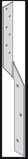

SimonD Posted March 4, 2021 Share Posted March 4, 2021 7 hours ago, Mr Punter said: I would have stainless steel restraint straps externally. Have the top bent over top of the sole plate and then rum down the outside 500mm and fix to the blockwork with plugs and stainless screws. Get them 1200 long and cut in half. Light duty if the engineer says it is OK. I've got something similar on my current timber frame, although that is sitting on an existing ground floor masonry wall. In our case the SE also specified Tapcon anchors through the sole plate into the masonry but our roof is curved so there's increased uplift. 8 hours ago, SeanDean said: Some really useful responses from you all that have really helped me understand what I need a lot more and the reasons why. I'm going to work on a solution that includes anchor or resin bolts along with a strap like the one below, I just need a solution for sealing the DPC after it's been penetrated along with sealing the DPM if I put the straps on the inside of the build. Any input would be greatly appreciated. I think it would be okay to use resin fixed anchor bolts and then use mastic to seal around the penetrations. In the US, when they're aiming for high airtighness levels, they'll add an EDPM strip to the dpm/dpc layer below the sole plate. The brackets you show above are really just uplift restraints so if you do need additional fixing, restraint straps as @Mr Punter suggests would probably be easier to install. Link to comment Share on other sites More sharing options...
Cait Posted October 8, 2021 Share Posted October 8, 2021 On 04/03/2021 at 13:56, Mr Punter said: I would have stainless steel restraint straps externally. Have the top bent over top of the sole plate and then rum down the outside 500mm and fix to the blockwork with plugs and stainless screws. Get them 1200 long and cut in half. Light duty if the engineer says it is OK. @SeanDean Hi Sean, have enjoyed following this discussion some very useful questions and comments - how's your extension coming on and did you go with the stainless steel restraint straps as @Mr Punter suggested? Link to comment Share on other sites More sharing options...
