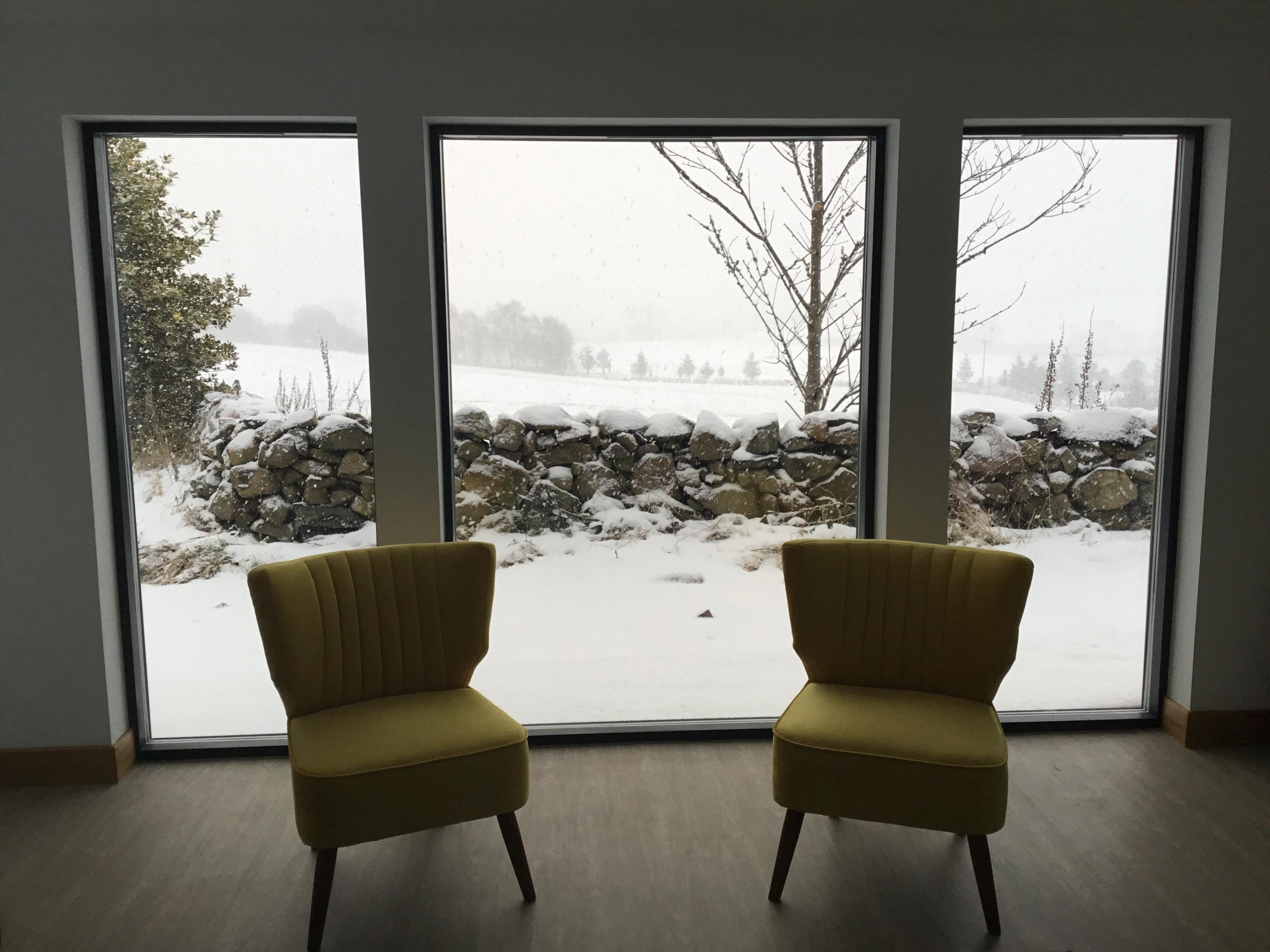

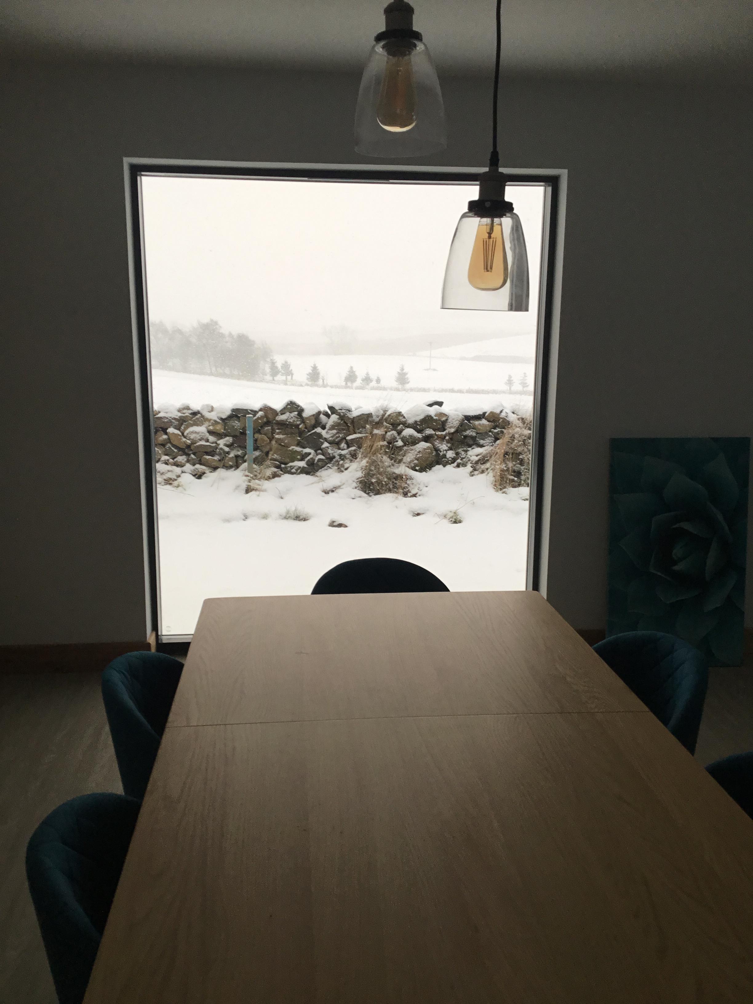

We have these Rationel windows.  Lots of them.   Lots of fixed panels plus some of their window doors.  And their exterior doors x 2.
They are excellent.  I have attached a pic during recent snow.  Couldn’t tell I was cold outside, temperature wise.  And we don’t have a vestibule.
I did look at Nordan liked them but the Rationel beading etc was less ornate more streamlined.  Didn’t get a quote just went for Rationel & pleased I did.

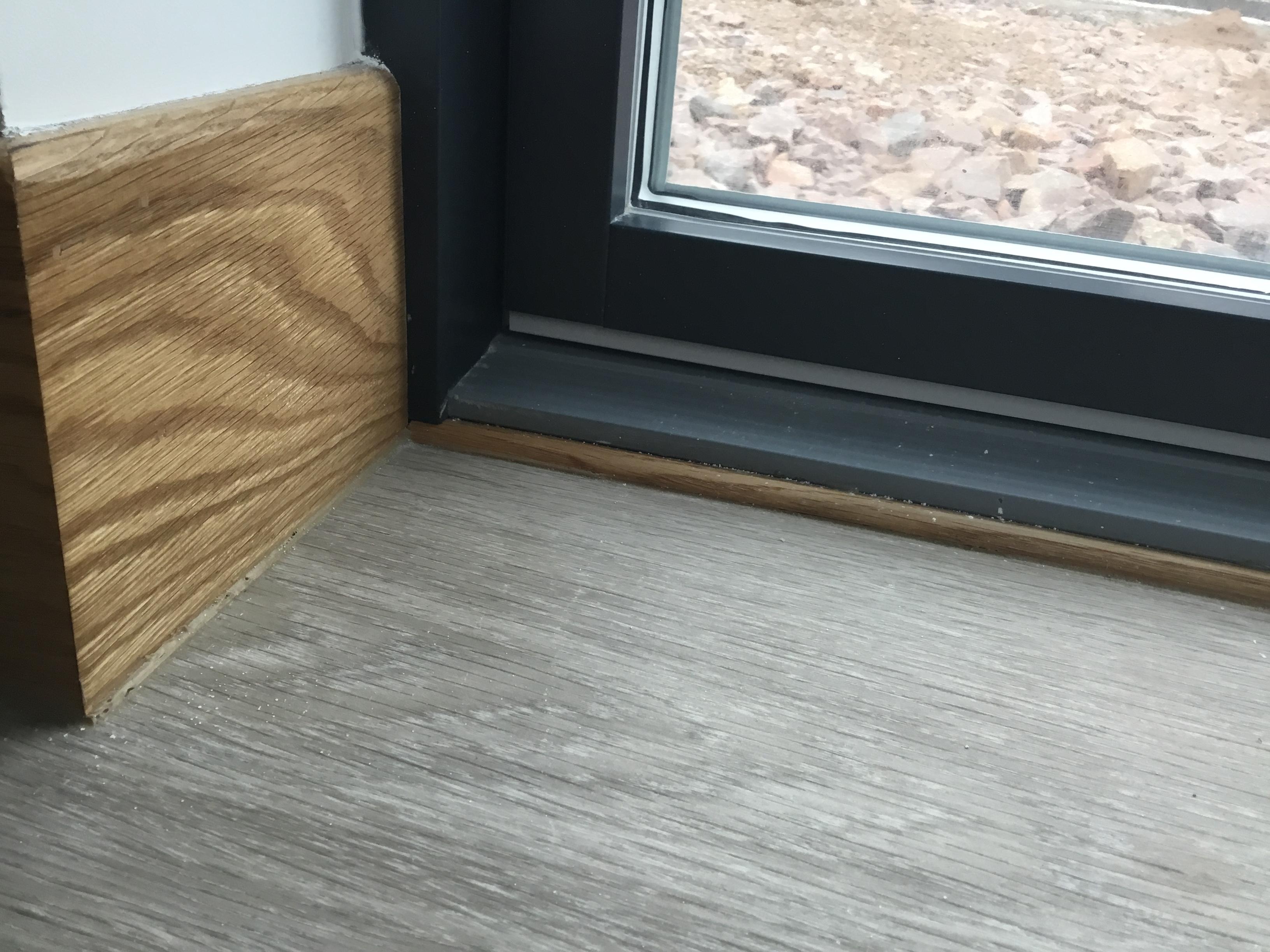

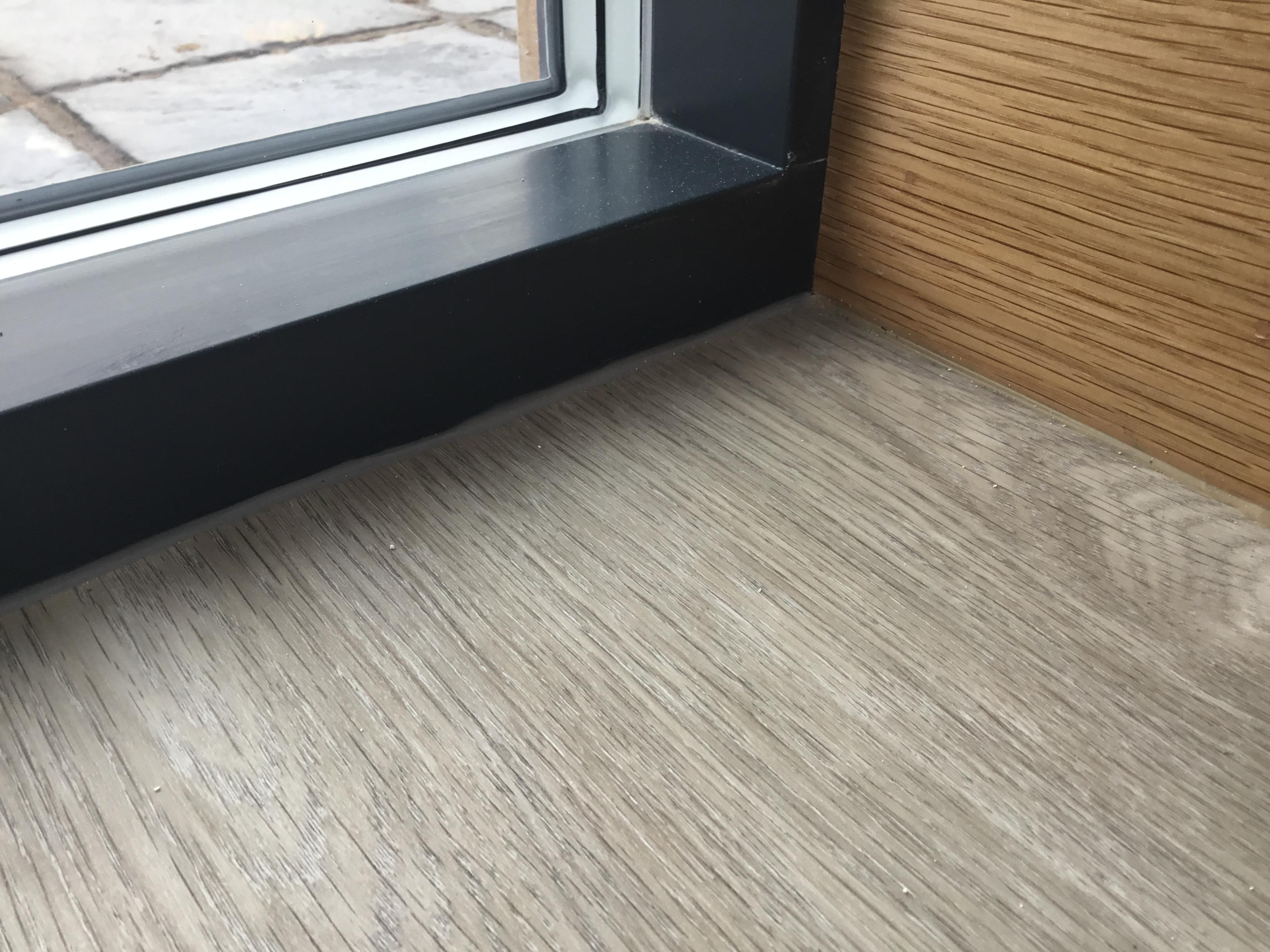

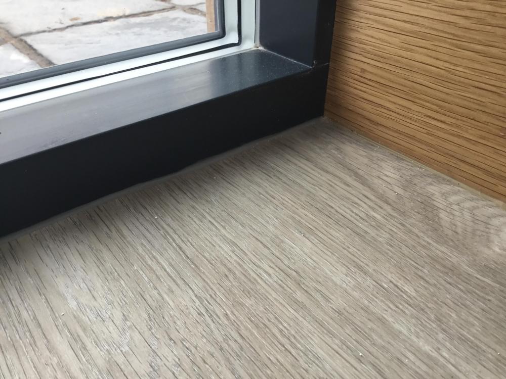

@bozza would you mind posting a close up of where the floor meets the window on those? We're having a debate about that for our own Rationel windows and joiner is talking about beads and sills to finish the edge that we don't like the sound of.
Many thanks.
Many thanks.
Sure no problem attached below with /without bead so you can see both.
I see you are in Angus.  You’re welcome to come & see mine, when travel is allowed.54569B60-1D33-454B-9C07-D51F8C4B3EB0.thumb.jpeg.09dcae715ebaeb2ff2b8b2d4a2e9db86.jpegF2D52AD7-34D5-449F-817E-45E7568B8532.thumb.jpeg.0e9a275c9b0815687e48f2547fc65317.jpeg
Thanks that's exactly what I was looking for. And thanks for the offer, very kind of you.
