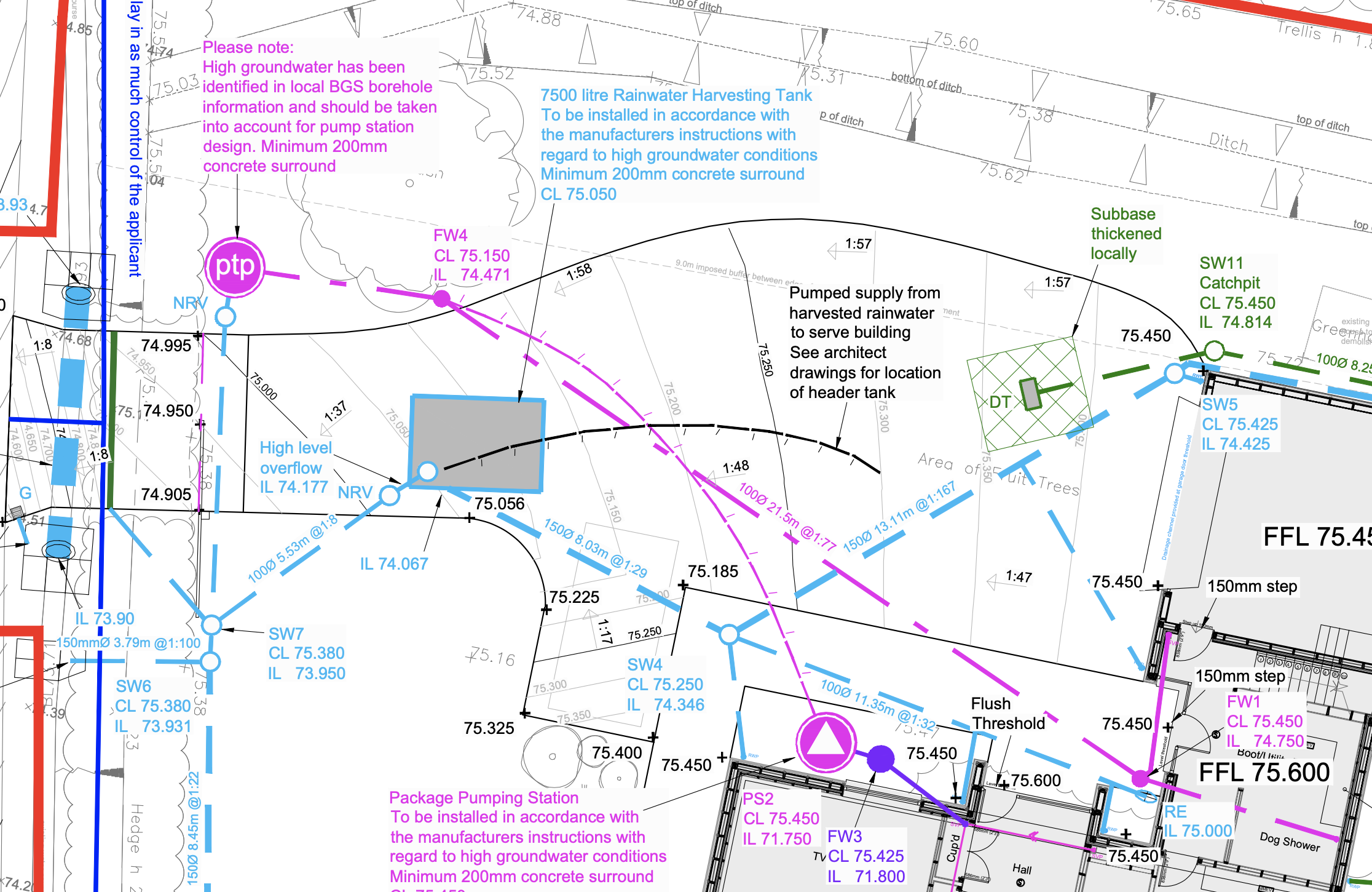

Thorfun Posted February 28, 2021 Posted February 28, 2021 afternoon all and a happy sunny Sunday to everyone. I hope you're all having a lovely day. my latest dilemma/decision is to do with our temporary hardstanding for the construction traffic during our build. I am currently digging it out to the depth that will eventually be required for our driveway and need to decide whether to simply put down some temporary hardcore for the build and then remove it all and then put down the Type 3, the open surface tarmac to go on top which will be finished off with the resin bond that we've decided on. here's the plan for our driveway and you can see that there is a RWH tank, diffuser tanks and plenty of pipework to eventually go underneath the driveway so anything I put down will need to be dug in to at a later date to install all of that. as such it would seem that just putting down some crushed concrete to create a temporary hardstanding would be the best route but it also seems like it's simply throwing money away as it will need to be bought and delivered just to be dug up and taken away afterwards at another expense. But then if I pay for MOT 3 now will that get ruined during the build and by digging in to it for the pipes and tanks? any suggestions about what to do or what would you do in this situation? or any other options I might not have thought of?

Mr Punter Posted March 5, 2021 Posted March 5, 2021 A lot of the pipework is quite deep and there is lots covering that area as well as a load of chambers, pump station, chambers and tanks. If you install this after building the house, the whole area will get completely trashed. At best, if you have fair thickness of material for the hardstanding you may be able to scrape it off and stockpile it before you dig the trenches etc. 1
Thorfun Posted March 5, 2021 Author Posted March 5, 2021 3 minutes ago, Mr Punter said: A lot of the pipework is quite deep and there is lots covering that area as well as a load of chambers, pump station, chambers and tanks. If you install this after building the house, the whole area will get completely trashed. At best, if you have fair thickness of material for the hardstanding you may be able to scrape it off and stockpile it before you dig the trenches etc. thanks. so, I think that works for me. I can lay the sub-base and then scrape it off and store it, dig the trenches and then reapply. it is a lot of sub-base but it means that I won't have to throw anything away and all it costs me is time to scrape off and put back. I think I'm ok with that! I want to have a hardstanding for the build so this seems like my best option. 1
