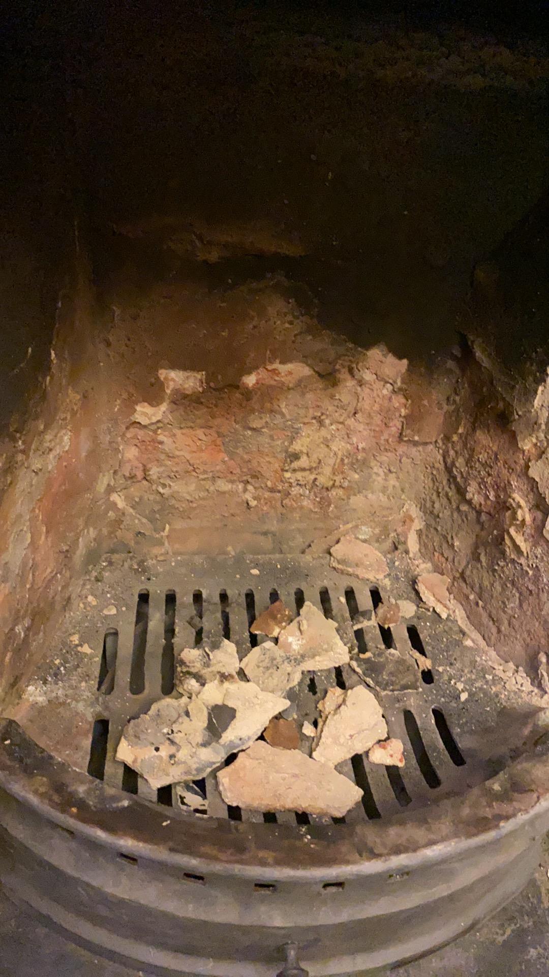

Alfarrow Posted February 25, 2021 Share Posted February 25, 2021 I’ve got an open fire which I burn coal and logs on. Having a problem with the render that’s been reapplied twice (by chimney sweep) since Xmas cracking and crumbling off. Any tips of anything different that can be used and if it’s safe to use in its current state where the firebricks are now visible? Link to comment Share on other sites More sharing options...

Carrerahill Posted February 26, 2021 Share Posted February 26, 2021 11 hours ago, Alfarrow said: I’ve got an open fire which I burn coal and logs on. Having a problem with the render that’s been reapplied twice (by chimney sweep) since Xmas cracking and crumbling off. Any tips of anything different that can be used and if it’s safe to use in its current state where the firebricks are now visible? I prefer to do it one of 2 ways, proper brick back and pointed up, or use a cast insert piece. It looks like brick behind there, I would chip the render off and just redo the brick properly. It will look nicer. If a real mess pull them out and rebuild it. I don't think render ever works that well in the firebox. Link to comment Share on other sites More sharing options...
Alfarrow Posted February 26, 2021 Author Share Posted February 26, 2021 Thanks for the replies. We are considering a multi fuel stove to replace it. Is it safe to use with the firebricks showing where the render has dropped off? Link to comment Share on other sites More sharing options...

Alfarrow Posted February 26, 2021 Author Share Posted February 26, 2021 Sorry meant is the open fire safe to use in its current state? Link to comment Share on other sites More sharing options...
Carrerahill Posted February 26, 2021 Share Posted February 26, 2021 40 minutes ago, Alfarrow said: Sorry meant is the open fire safe to use in its current state? Yes. Link to comment Share on other sites More sharing options...
