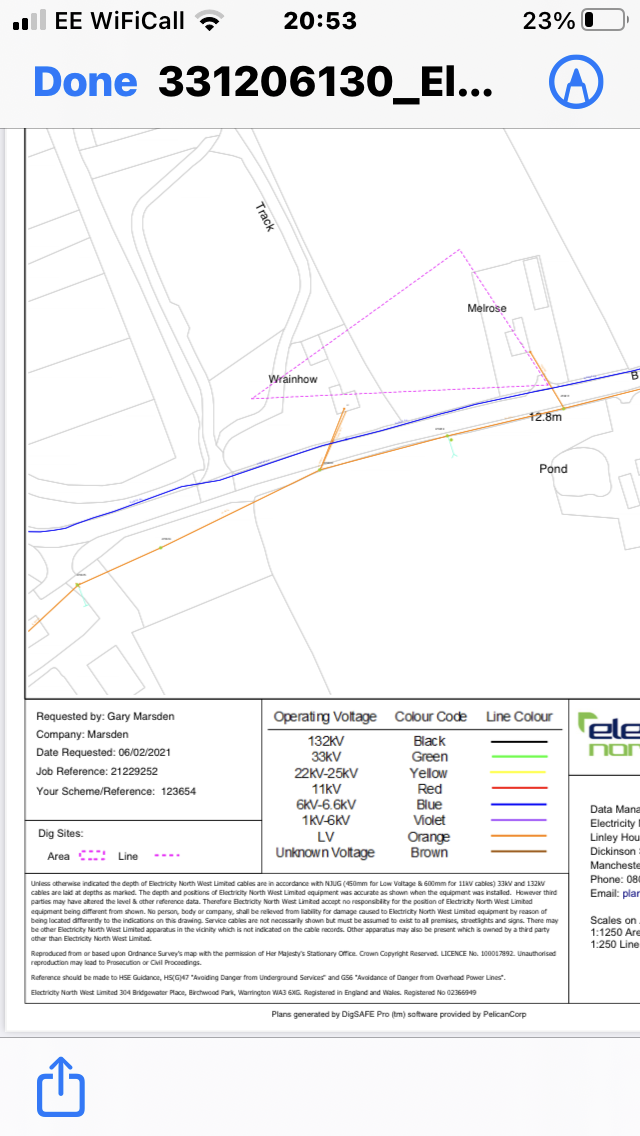

I’m just doing what I can while we complete
The line search is back showing the two neighboring properties Supplied by a low voltage cable access the road orange
Is there any reason why a supply can’t be picked up off the blue higher voltage cable on the same side of the road

22 minutes ago, Conor said:
Yes, a transformer would be needed. Would cost more than bringing the LV across the road.

If you have an HV cable on your side of the road, beware of clearance for delivery trucks, cranes, scaffolding and building exclusion distances.

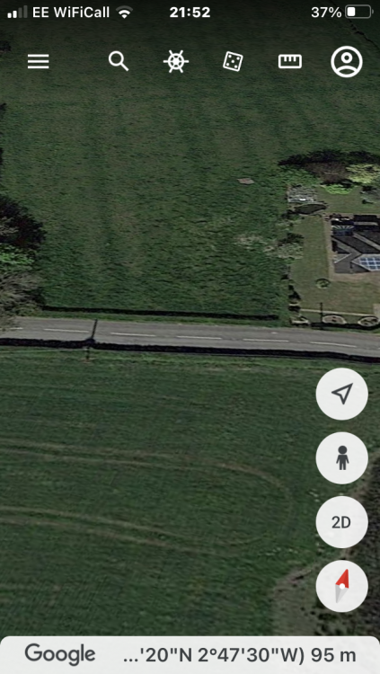

While there’s an overhead phone cable on our side All the overhead electricity seems to be across the road There no pavement so i would be surprised if anything was buried
