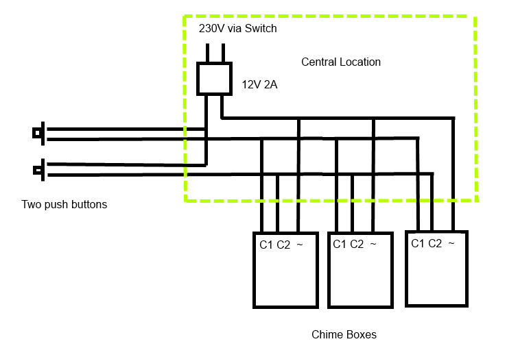

Alexphd1 Posted February 19, 2021 Posted February 19, 2021 (edited) What size of cable for a hard wired doorbell with longish runs longest run 20m, 3 runs so 60m in total. Has anybody a wiring diagram for two chime (front and back door) 3x chime box set up, happy with a external transformer. Edited February 19, 2021 by Alexphd1

Temp Posted February 19, 2021 Posted February 19, 2021 2 hours ago, Alexphd1 said: Has anybody a wiring diagram for two chime (front and back door) 3x chime box set up, happy with a external transformer. Presumably you want each button to sound a different chime so you know which door to go to, and the three chime boxes are for coverage in different parts of the house? Quick google found this range can do that.. https://doorchimesuk.co.uk/catalog/product_info.php?products_id=629 That model supports lots of different wiring options including mains and built in transformers. The circuit below is just one possibility based on their option B using an external transformer and chimes in parallel. You would run two core cables for the push buttons and three core to the chimes all to a central location like the CU where the transformer and a junction box is located. You might consider running extra cores to the pushbuttons as spares or future use. https://doorchimesuk.co.uk/pdf/CROMA_230.pdf It says each chime box needs 12V at 0.5A so I'd use something like a 12V AC 2A transformer. With more time it might be possible to eliminate the external transformer using one of the other wiring options. 1
