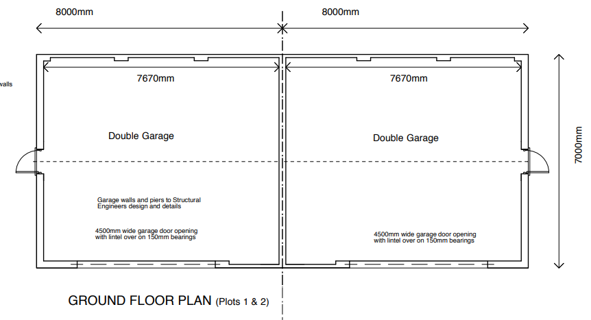

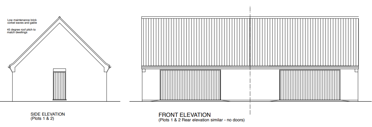

Phaedrus Posted February 17, 2021 Posted February 17, 2021 17 minutes ago, Andrew said: Our garage has a room above which I will use as an office. Andrew - Does your garage/studio have a flat roof or is it effectively two-storey? The reason I ask is that I submitted the plans below to allow for flexibility for a storage/games room space and I've just received a negative reaction from planning based on the "overall scale".
Andrew Posted February 17, 2021 Posted February 17, 2021 1 hour ago, Phaedrus said: Andrew - Does your garage/studio have a flat roof or is it effectively two-storey? The reason I ask is that I submitted the plans below to allow for flexibility for a storage/games room space and I've just received a negative reaction from planning based on the "overall scale". It's a room in the roof type i.e. 1
Phaedrus Posted February 17, 2021 Posted February 17, 2021 Thanks Andrew, looks good. My ridge height is only 6.3m compared to your 7m approx. Unfortunately if I reduce the roof pitch to 40deg then I'll lose a lot of usable space ☹️
