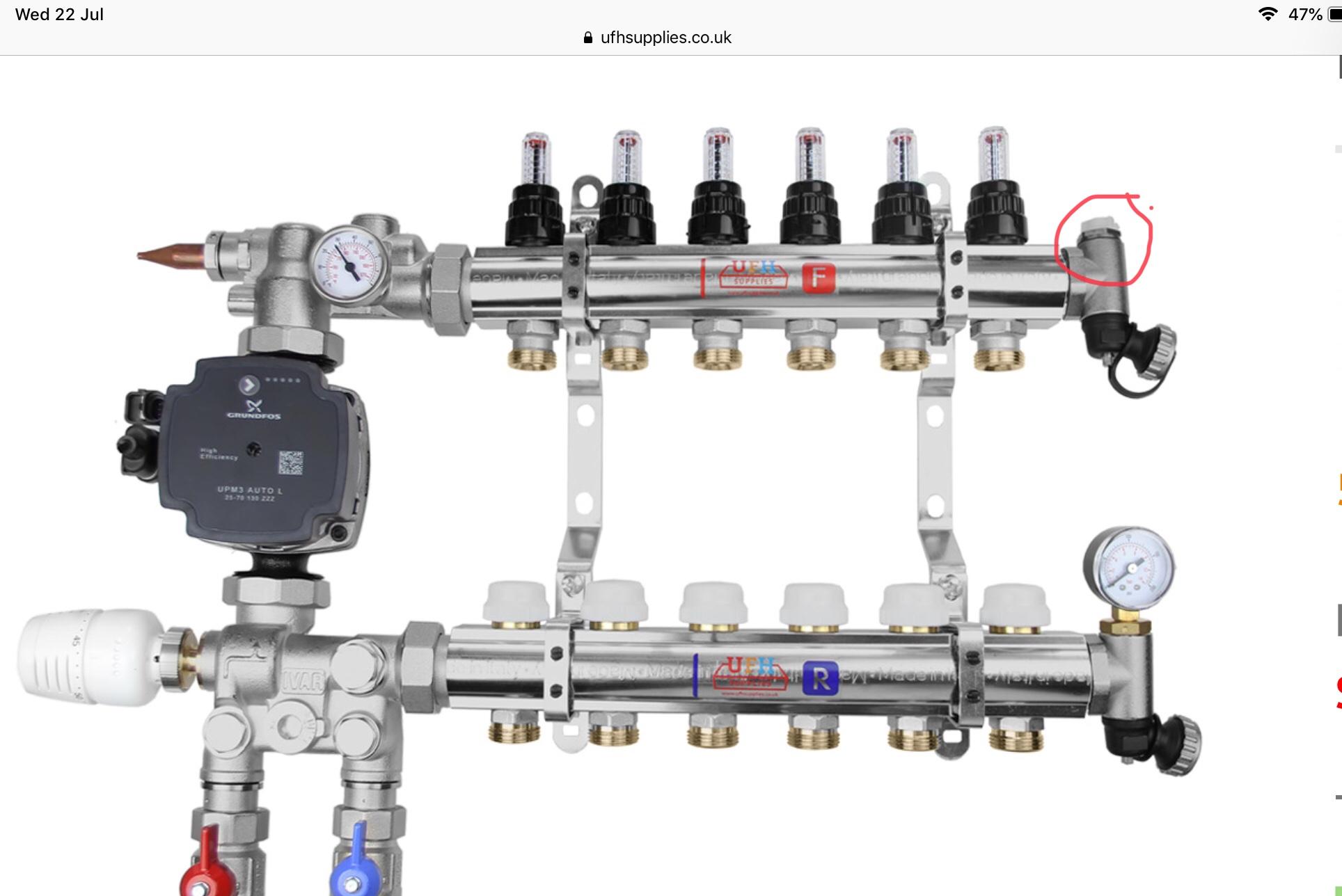

Mine came from underfloor heating supplies, I have got the extra low heat blending valve.
Just check what temperature you want with yours, some don’t go any lower than 30-35 degrees which I was told was not low enough so I got it swapped out for a lower temp one. 883C9526-7970-40E8-BC5F-5C630A707D31.thumb.jpeg.32a0d826c6eddab0a3c96027a65bcb94.jpeg
Thanks @Russell griffiths just had a look at their website and, although the picture shows the valve as Ivar, the description and downloadable user manual brands it as CosyFloor.
Is it a genuine Ivar? I've been caught out with pictures and descriptions not matching in the past so am a bit wary these days.

Phone them and talk to them, don’t read the website.
I am finding that 90% of the companies I buy from don’t actually know what they are talking about or understand what they sell.
I had to tell them constantly that ivar make a lower temp blending set, they had no idea and didn’t know why I would want one.
The problem is the people that work at these places live in a Barrett house and are just happy someone is stupid enough to pay them every week.

@OldSpot I bought mine from Heating Controls Online but only because they were about £20 cheaper.
If you're replacing the complete pump set on an existing manifold then make sure to measure the distance between the upper and lower manifold connections. My old pump set had a standard 130mm pump the same as the new set but the valve arrangements meant that I had to also buy a 25mm pump adaptor so that it all fitted correctly. Not at all difficult to do just something to watch out for.
