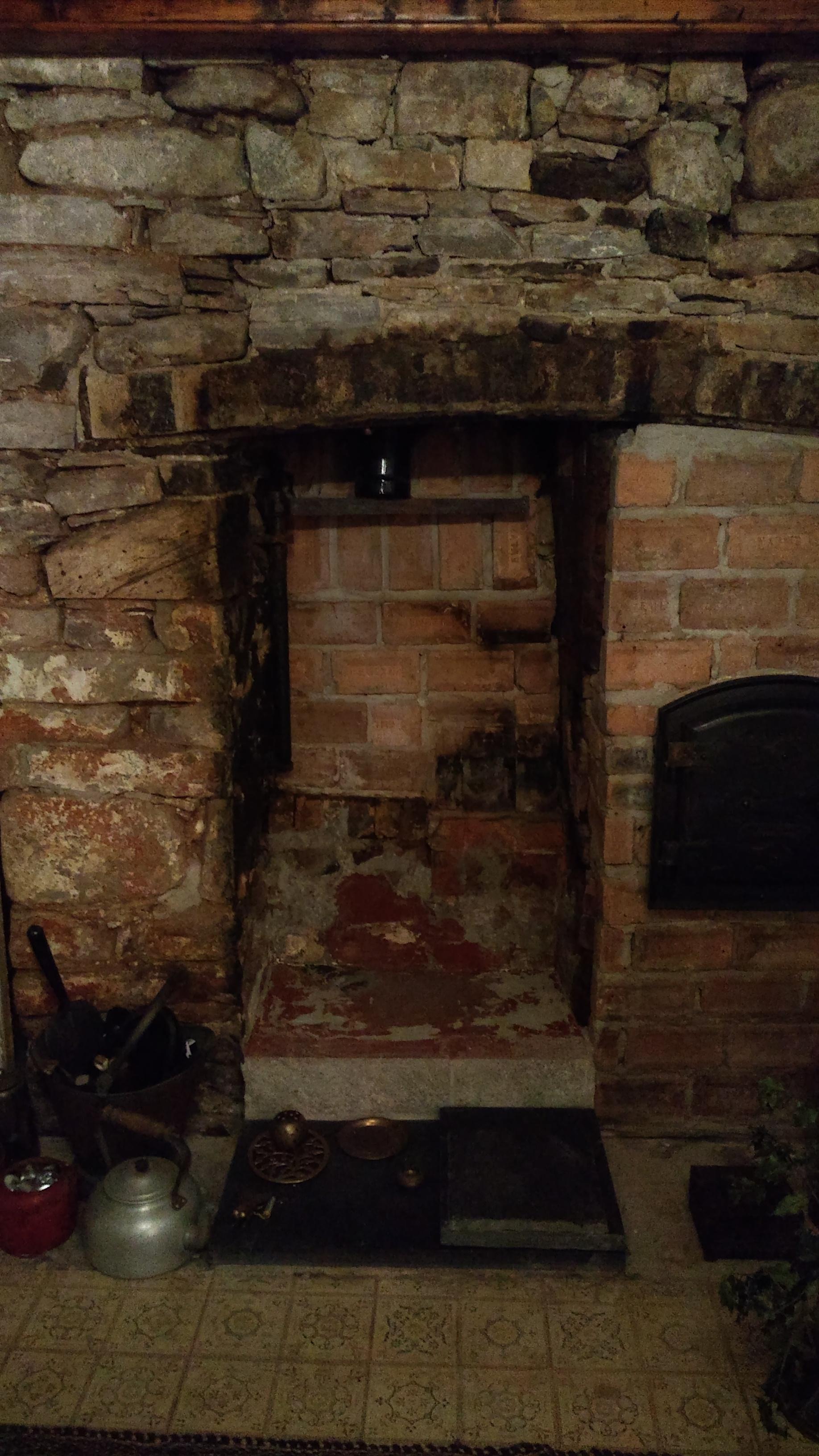

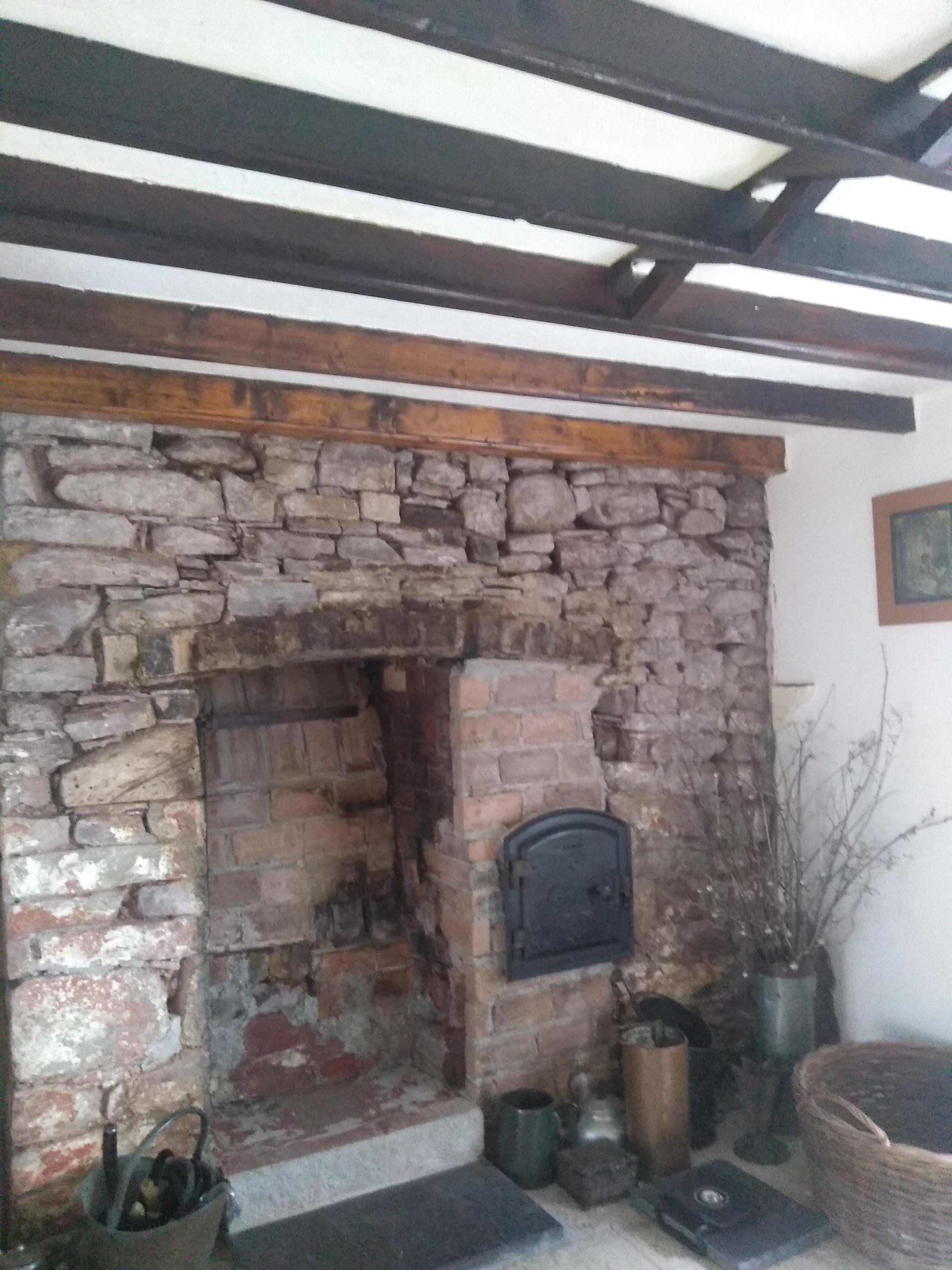

The stove is going into a fireplace recess which I'm now finishing the prep on.  There's a few things I'm not sure about and wondered if anyone can help please?
1. The constructional "hearth" in the recess could do with a lick of paint.  Any suggestions as to what paint would be best to use?  The fitter said emulsion should be ok, but a little googling seems to suggest emulsion isn't so great with high temps.  I should add we are having a Woodwarm Fireview with no legs.  So the ashpan section of the stove is in direct contact, although I won't really need to paint directly beneath the stove; just the visible parts to the side and front...

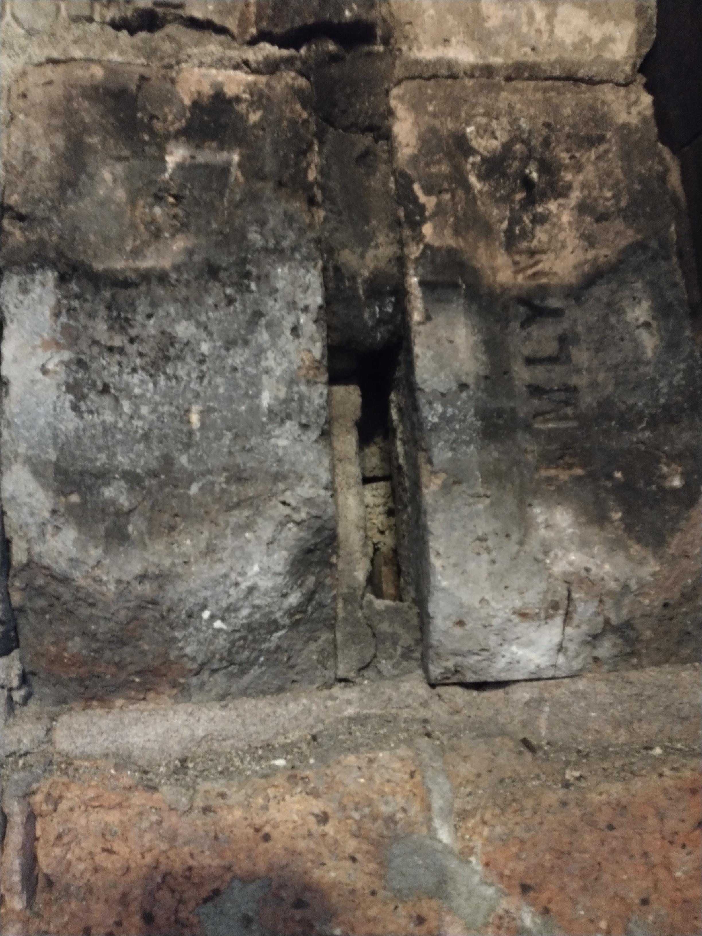

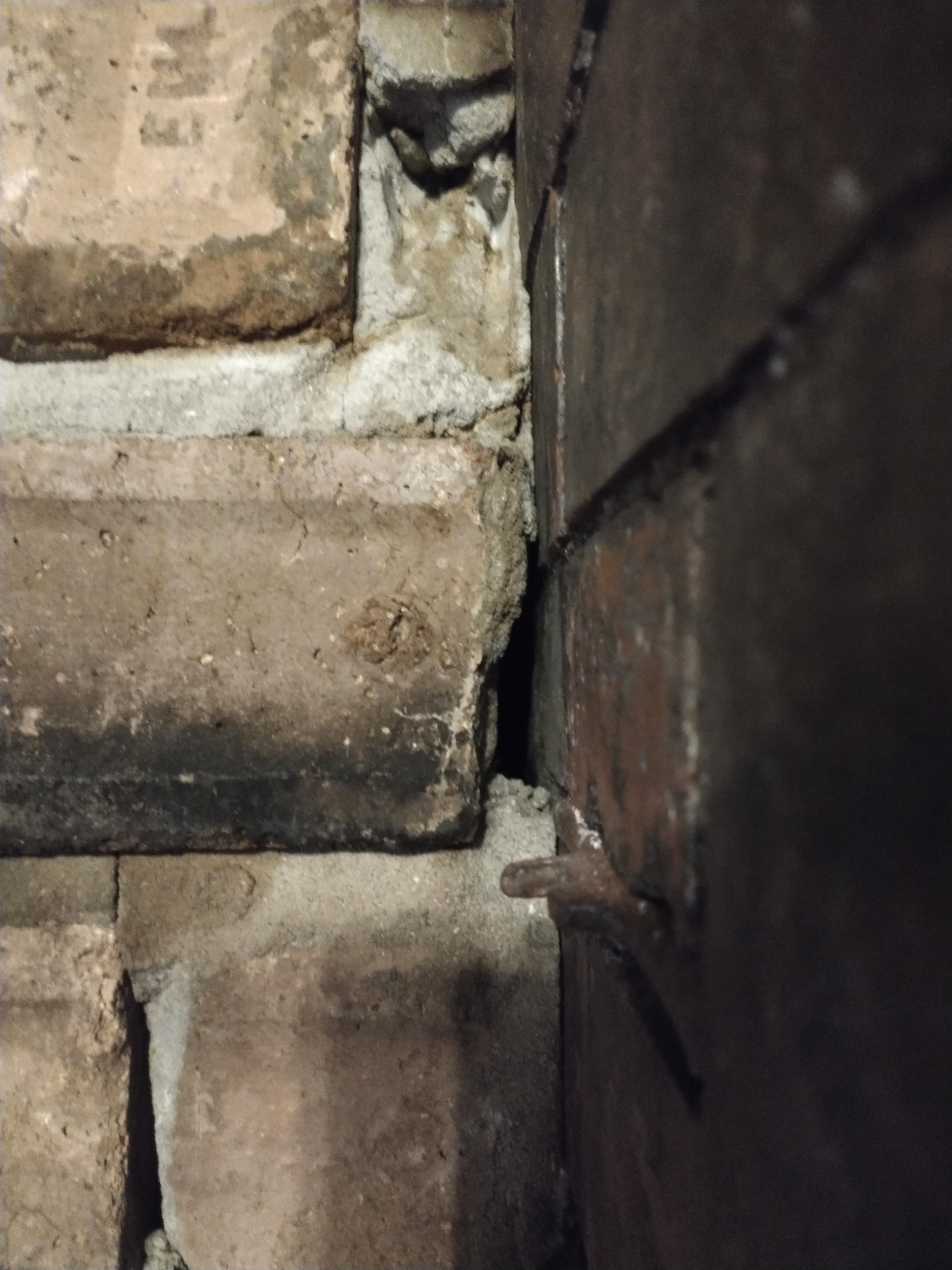

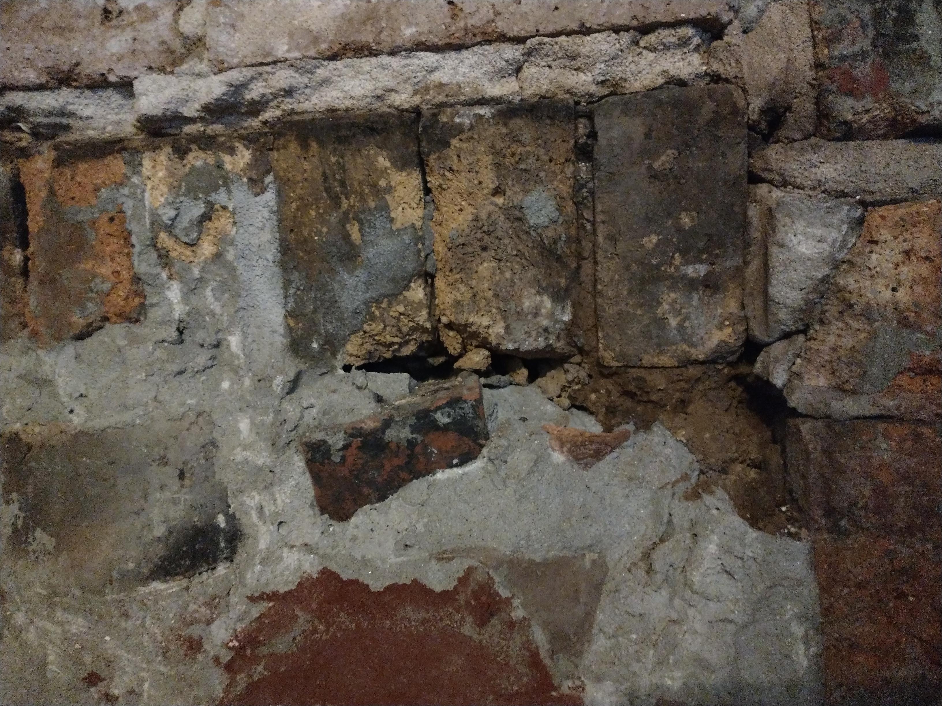

2. There's the odd gap in the pointing, some of them very deep (150mm).  I'd like to fill them before the stove goes in but I'm not sure what' best to use and whether it needs to be heat resistant?  Saying that, I've no idea what the existing mortar repairs and pointing were done with?!

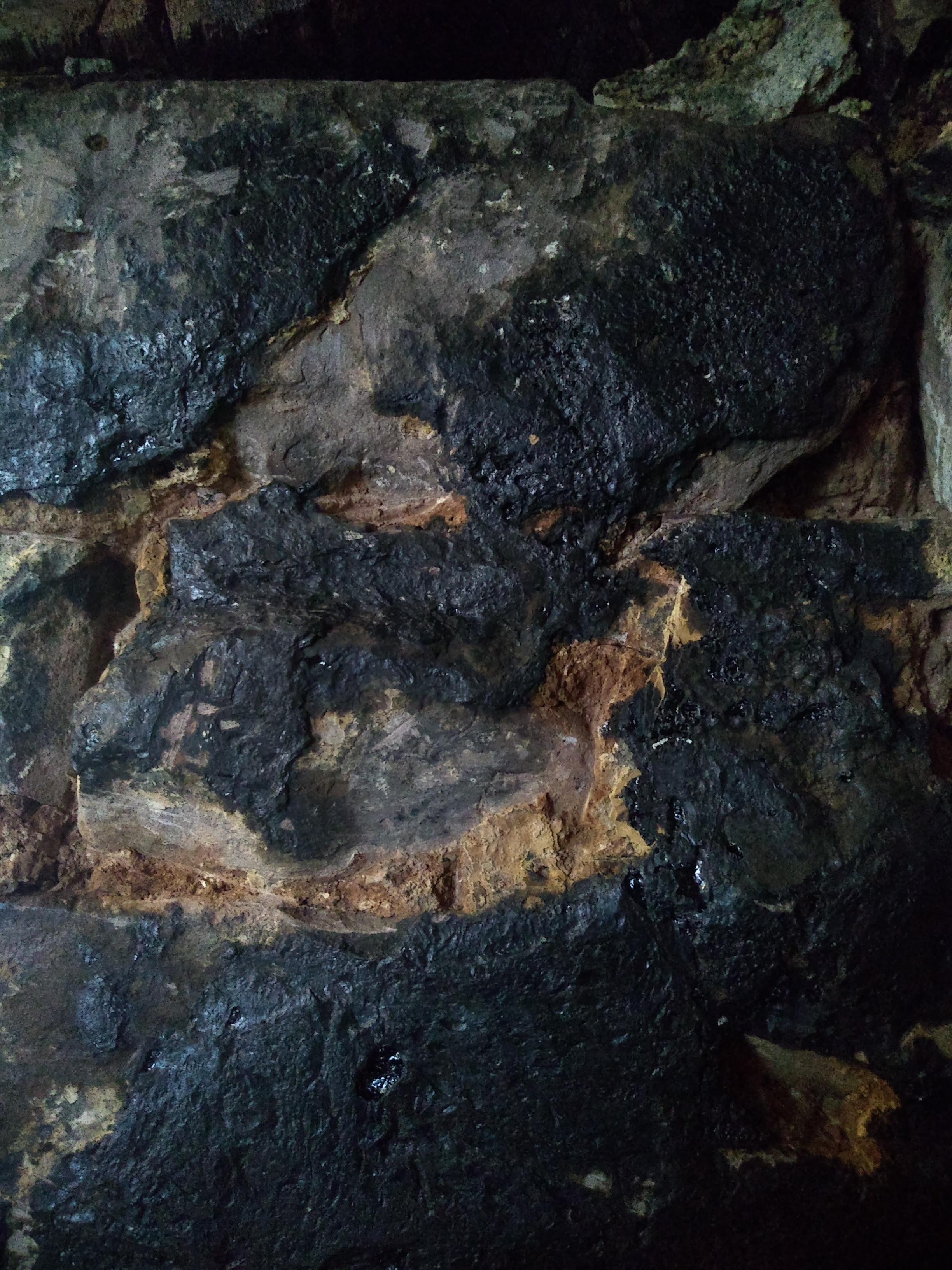

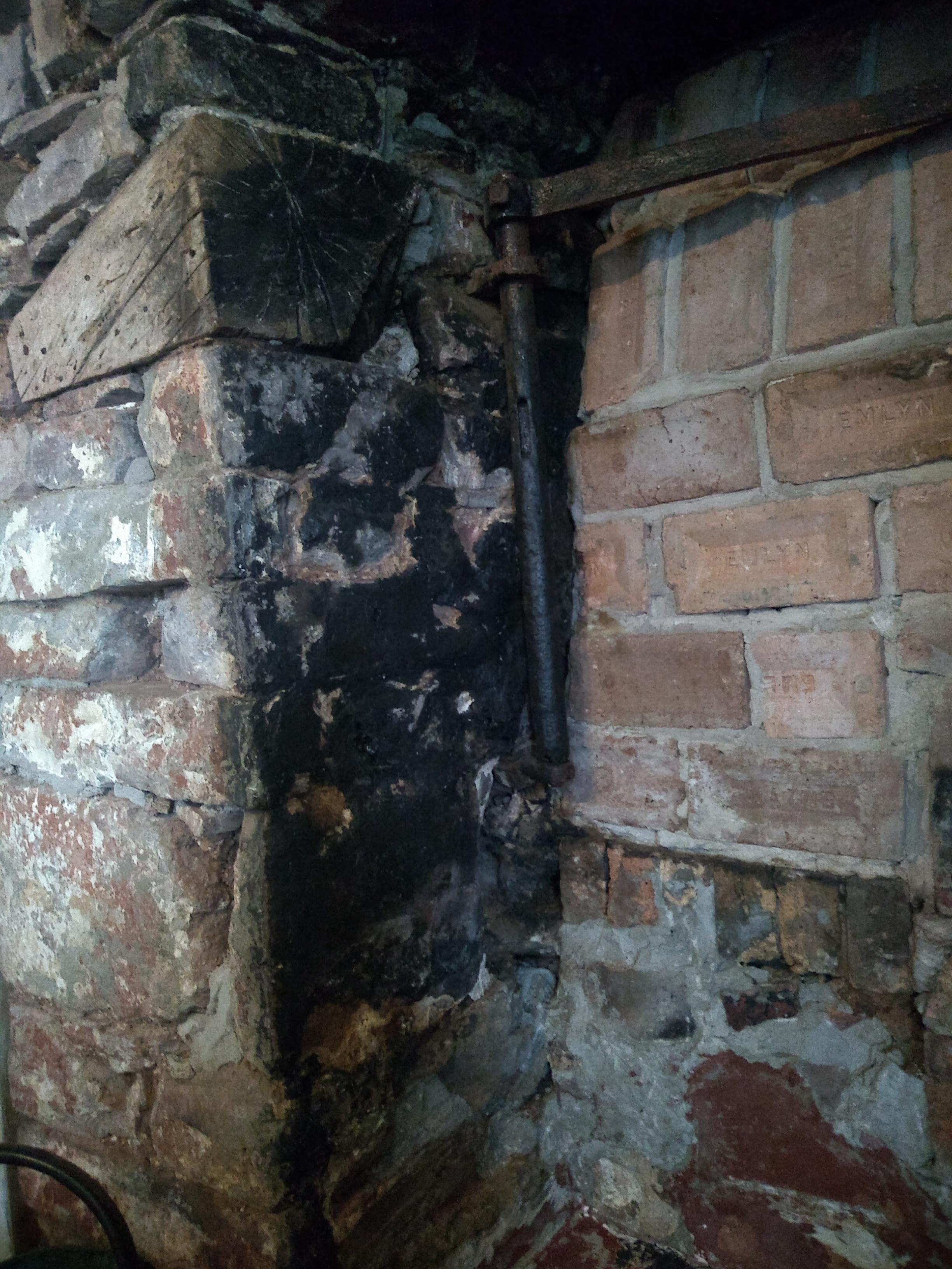

3. One of the side walls is covered in "black stuff".  I'm happy with the aesthetic; in fact I like it.  But could it potentially cause any problems?  If so, I'm thinking best to remove it now while I can...
Photos below.
Thanks a million

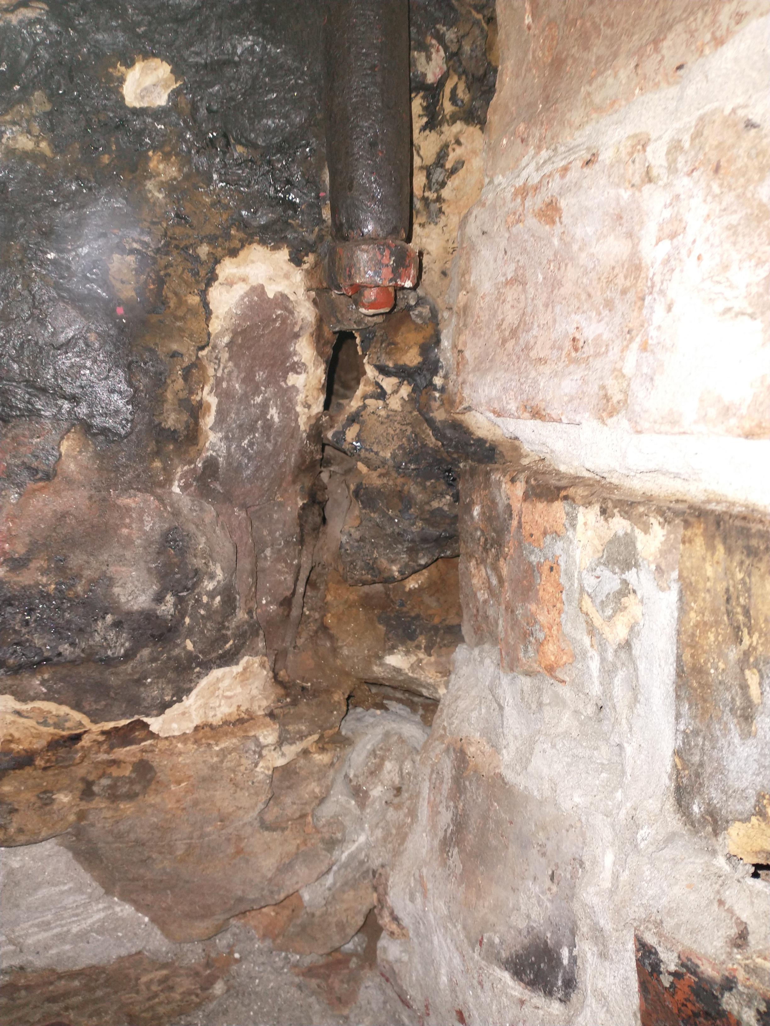

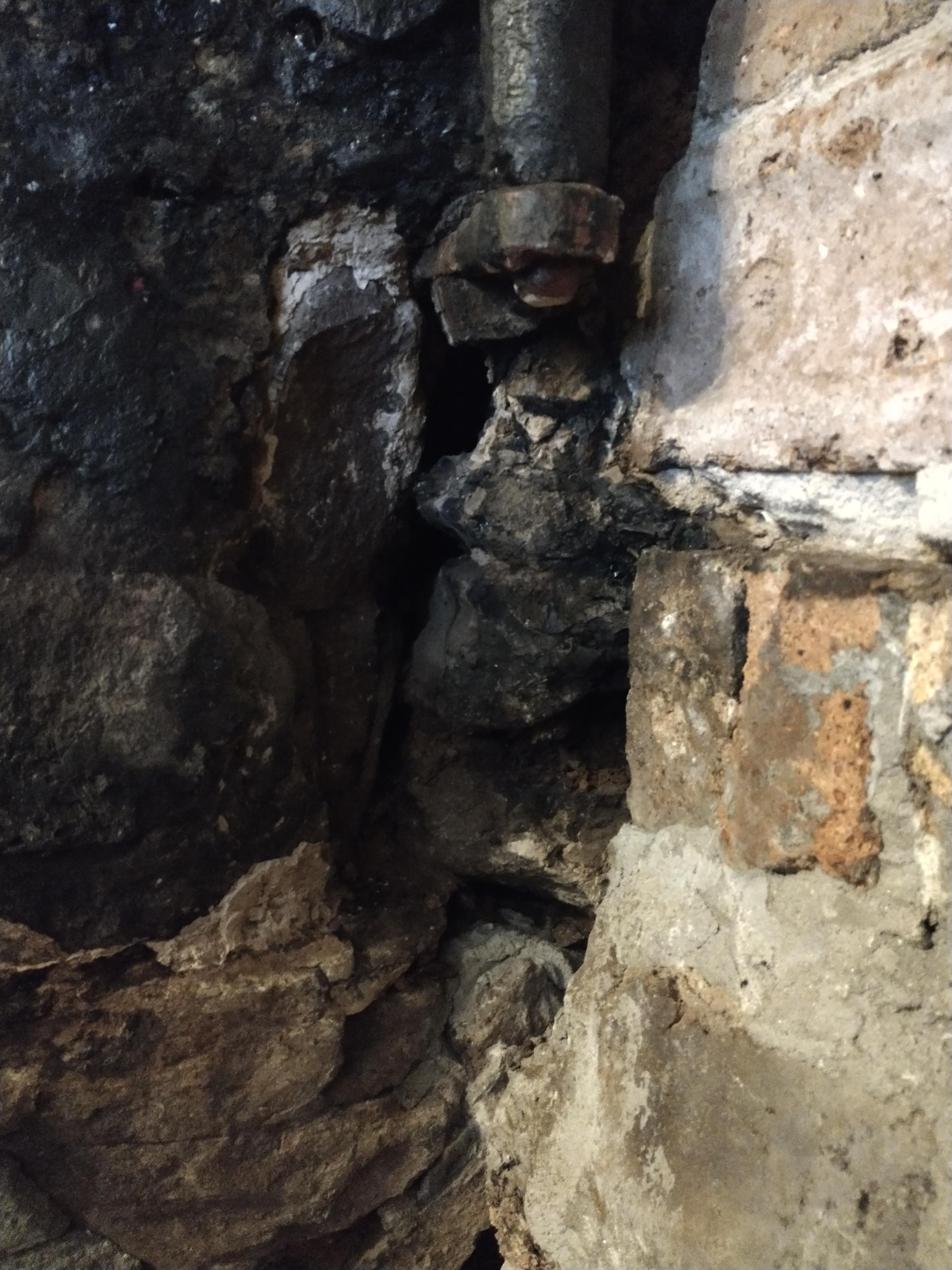

Here's some photos of the holes in question:
I’d happily chuck any mortar in those holes. Think about what’s already there... has that been “approved” for use... worst case is it dries out and falls out again.
I wouldn’t paint it, leave it as is.. it has character.
If you really want to paint it, I’d use some garage floor paint. Hardy stuff.
I've used this in the past https://shop.vitcas.com/vitcas-heatproof-mortar-10kg.html and they'll probably do everything you need https://shop.vitcas.com/products/heat-resistant-materials.html
Or you could try this stuff too https://www.toolstation.com/fire-cement/p38992?store=BK&utm_source=googleshopping&utm_medium=feed&utm_campaign=googleshoppingfeed&gclid=CjwKCAiA9vOABhBfEiwATCi7GPGty09XagmrIofU8n7Gb4XofRaM92-FlJ-29R3vL9ubhYcVIk1eehoCAVcQAvD_BwE

As for the heatproof mortar, I did find that and thought to begin with it was what we need.  But on closer reading I think this is for inside open fire places, for fire bricks, and that kind of thing.  IE - where temps reach the 1000C+ mark.  On top of that, the vitcas mortar says "It is also not suitable for use as a rendering or gap filling material."
I'm thinking standard normal mortar will be fine, but just not sure whether to use sharp or soft sand, plasterciser or no plasterciser, ready mix, etc.
