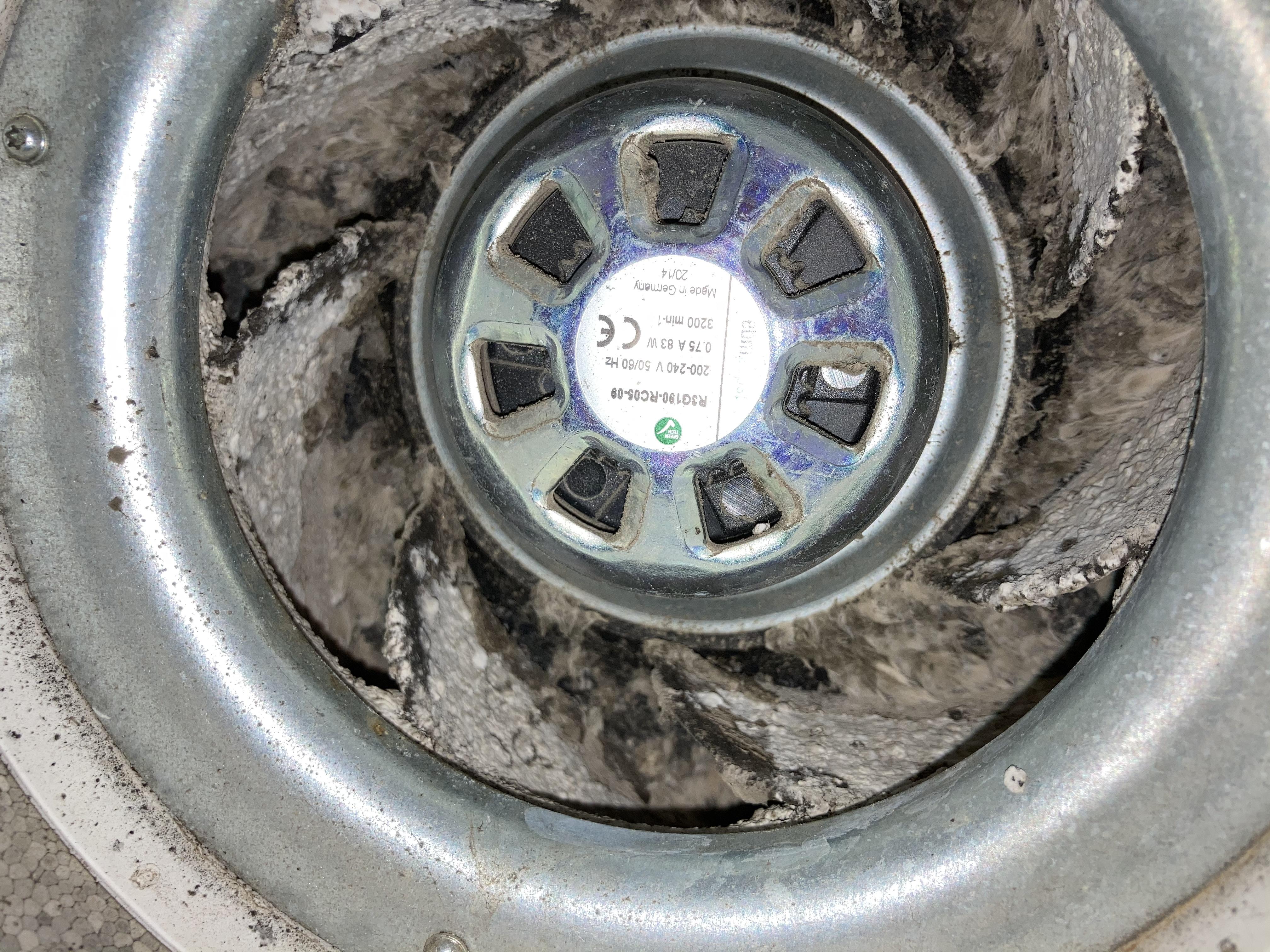

I’ve got an issue with mould growth in a Brink Mvhr unit. The extract fan has considerable mould on it. None in the ductwork/ manifold before it. The extract vents upwards (not ideal I know no) to a pitched roof cowl. So I presume the wet warmer air is condensing near the roofline and coming back down into the Mvhr unit. The ductwork is all insulated/eps ducting.

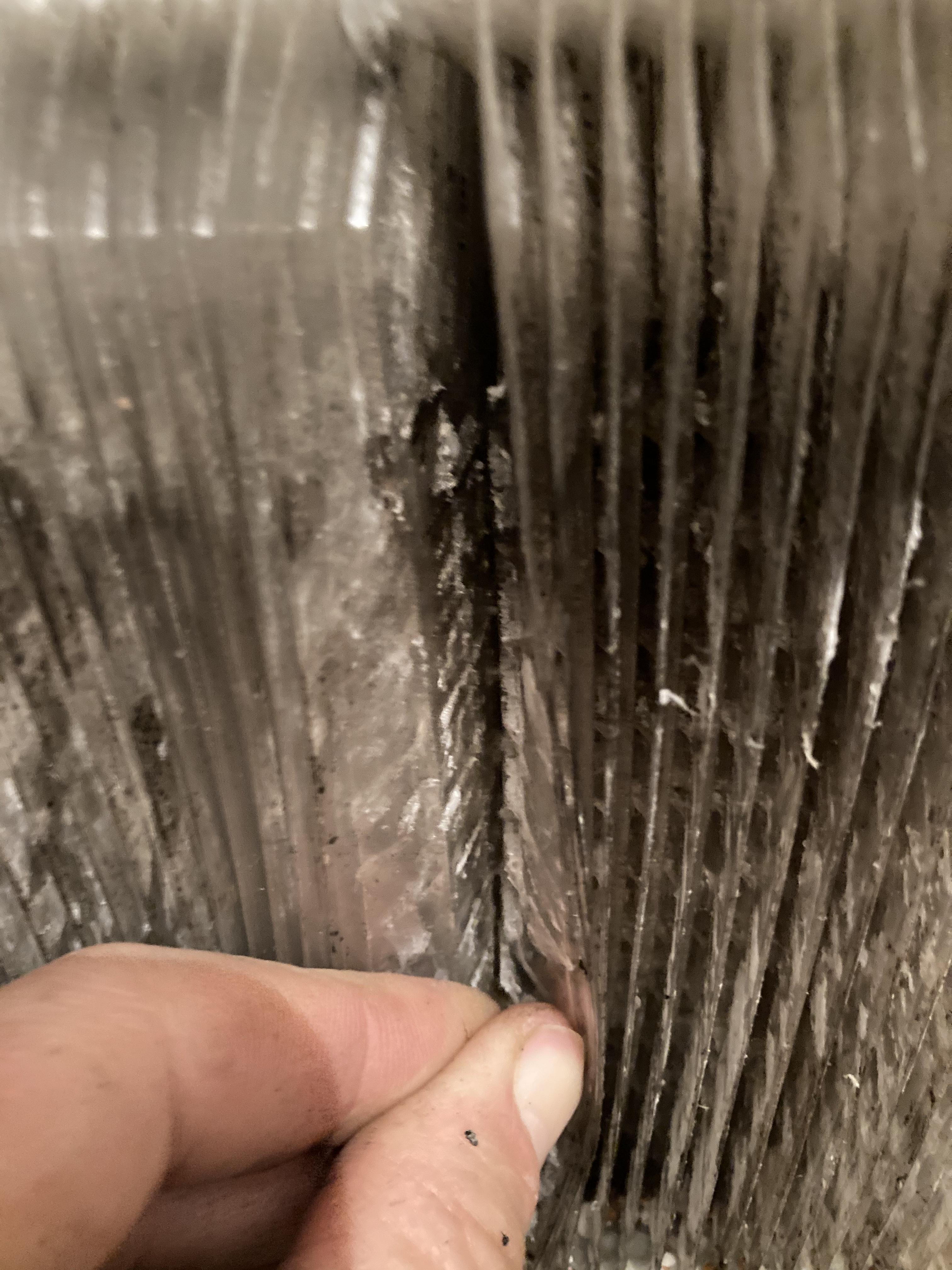

the unit has been installed for about 5 years. I had the same problem when I last took it apart for a proper clean and I had to remove similar mould from the fan. I can see some mould in the heat exchanger on the extract side as well.

Can you check if the extract fan is actually working at all? At its nominal revs it should be hard for the mould to grow to thick layer (especially at the tips of the blades, having the highest linear speed) and there should be some 'streaks' of the airflow along the surface - and I can't see either.
If it's dead, then it acts as flow restrictor only, stopping 'dirty' air from being expelled.
I had a similar issue when my Vent Axia was located in our cold loft (albeit insulated).  I think that was part of the problem, the other being the drain (including the one at the base of the exhaust fan chamber) blocked with build up of gunk / biojelly, that caused condensate overflow onto the fan blades which in turn threw cold water into the exhaust vent chamber and all over the fan blades.  I've since moved my unit into the heated envelope where it was originally meant to go and that has vastly improved things - don't seem to get mould growth now

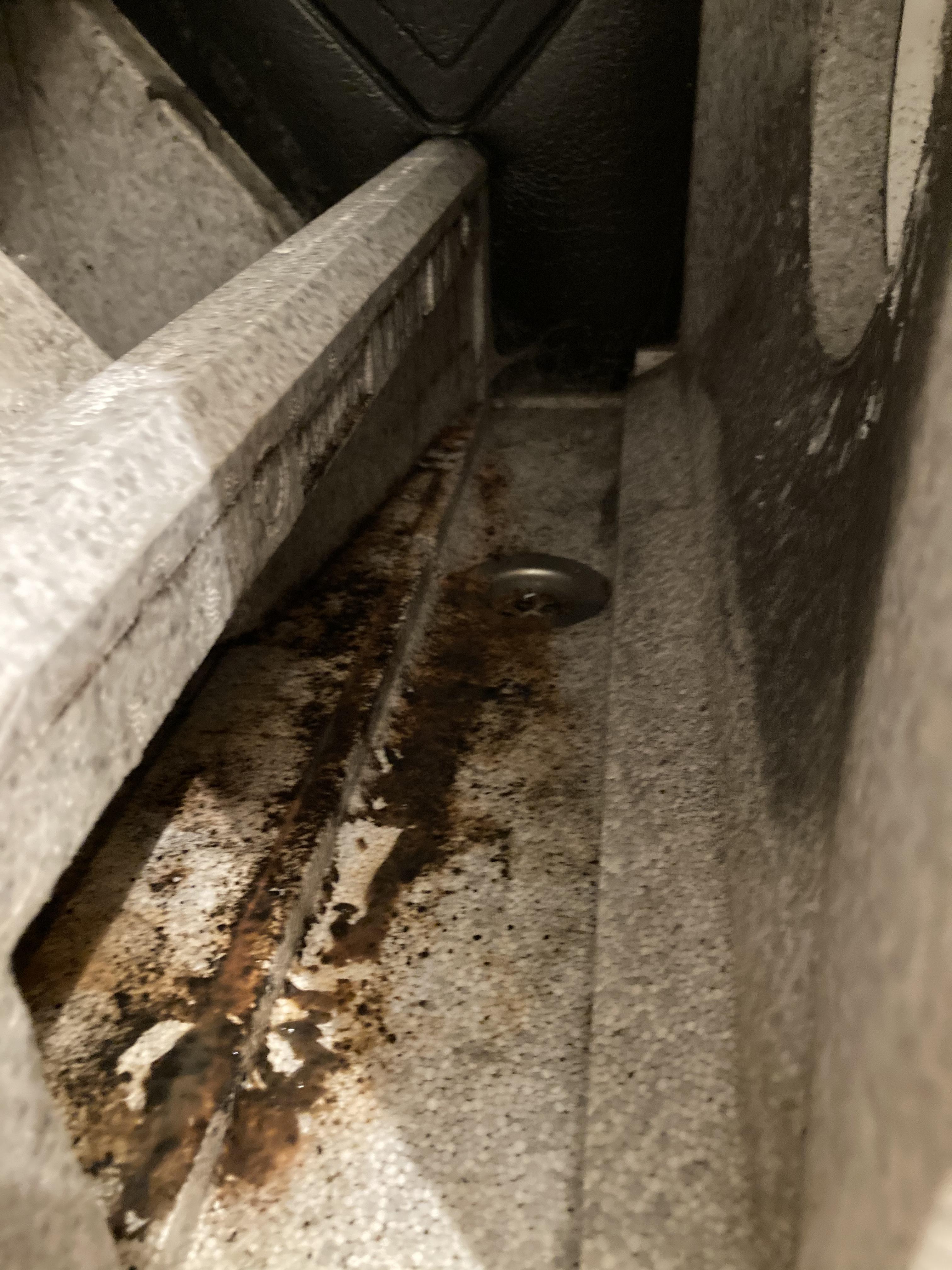

I noticed that there is some standing water in a small section - in the second picture there is a small section to the left of the EPS upstand (so to the left of the drain and nearer the back) with no route for the water to go anywhere. When the heat exchanger is in place this section is separated from the fan with the mould issue.
Any ideas?
I think there's design flaw with these Brink units. Mine has the same issue with standing water in a non-draining area.
There's some discussion here:

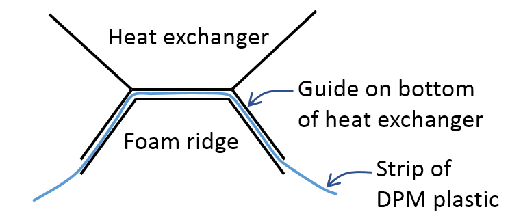

The solution for me was to fit a strip of flexible plastic between the inverted channel on the heat exchanger and the foam ridge that it slides onto. The edge of the plastic extends past the foam, which kicks any condensation out away from the foam itself. That stops it trickling down the foam and tracking to the undrained area.
Brink must be aware of this issue, as they send someone out to fix it over three years after installation. Their fix involved aluminium tape, and basically ripped off the first time I removed the heat exchanger!
As for your mould issue, once mould gets into this foam, I suspect it's going to be hard to kill off. I think a few rounds of scrupulous cleaning coupled with the application of some anti-mould compound (gel bleach perhaps?) might work?
So you mean something like a thin bit of corex (or thinner I guess as its already tight fitting the heat exchange in) that extends over to the side with the drain? (the right side of the unit in my picture).
That makes some sense.
Thinner than that. I think mine was some leftover DPM plastic, so quite flexible.
Mine is something like this:
The strip extends a bit longer at both ends of the guide, and is bent up so nothing can drip off the end.
Thanks for the diagram. Very helpful
