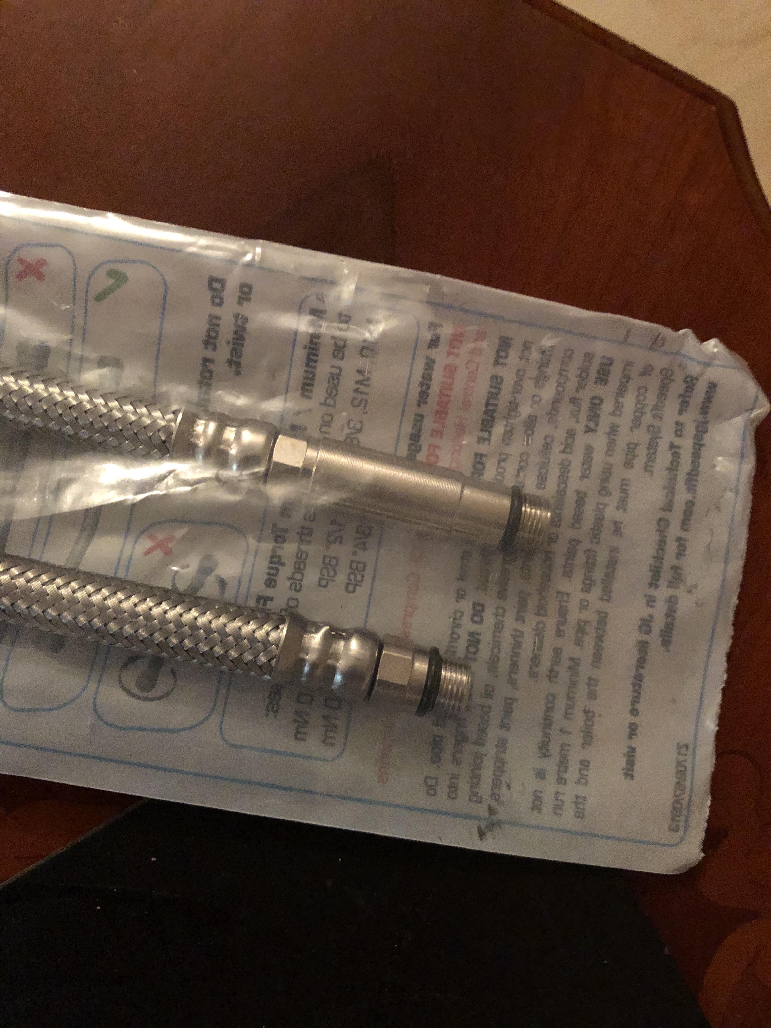

These arrived today .
Why is the shaft near the end ( go away @Onoff ) different? . Is it just so you can identify hot from cold ?
So you can get a spanner on it.
Short one first, then the long one.
Spanner.

I did wonder that . Because the supplied ones were the same making spanner access tricky .

Shouldn't need a spanner. Finger tight.
Only need a spanner for the long nut on the bolt that comes down.

Just over hand tight, and don't go mad. It's the rubber seal that stops water leaking, the threads just keep the rubber seal where it needs to be. And, deep breath, a bit of lube will stop the rubber getting FUBAR'd.
Good to hear this, I went down a rabbit hole yesterday with a kitchen tap, absolutely impossible to get to tighten the flexi-tails with a spanner, even with the tap stripped to its barest form on the bench, the flats were in-accessible, after some head scratching and rationalisation I came to the conclusion the O-ring would seal whatever the applied force and reasoned hand tightening would be good enough. Good to have it clarified though.
Yup. That’s why they have very fine pitched threads, so lots of bite for very little torque.
