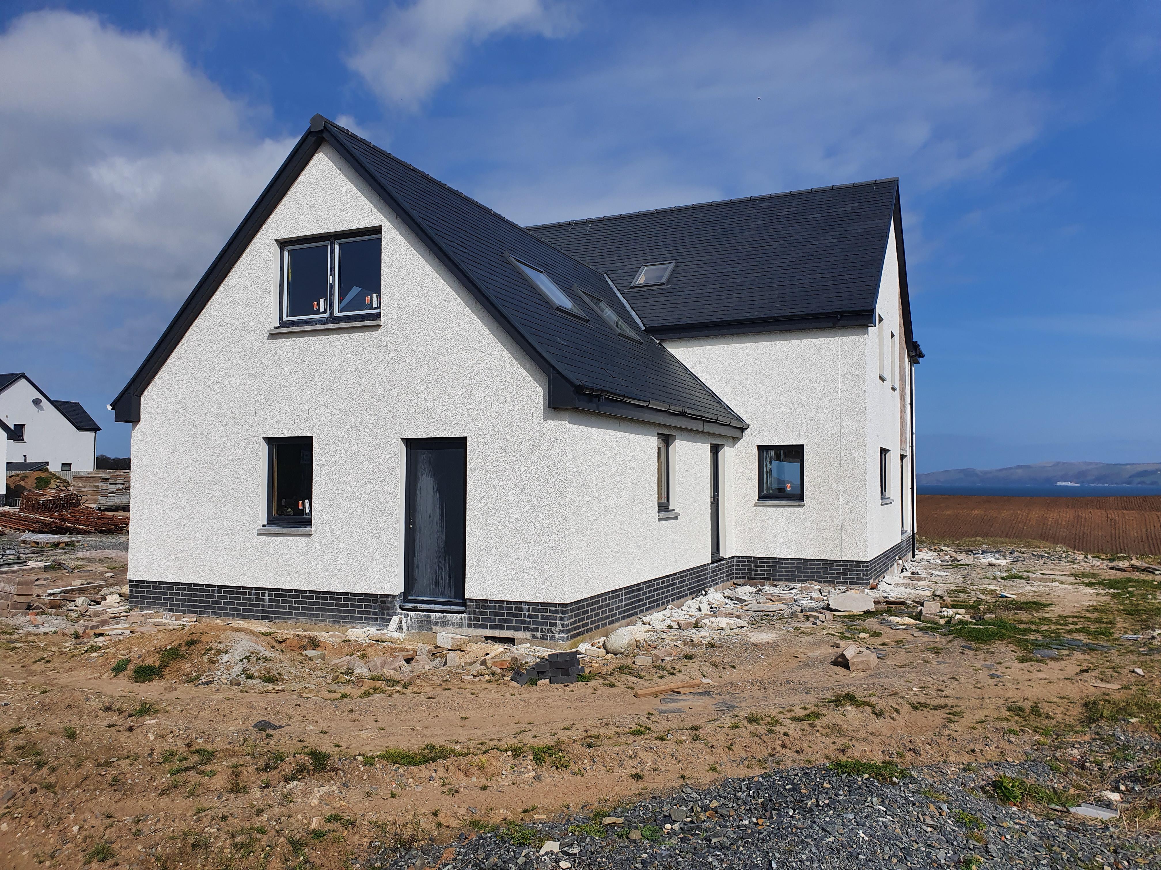

I went for white cement, silver sand and white chip wet dash.  Gives a bright white finish without painting and far cheaper than k-rend or similar.
  • Like 3
Posted
Looks nice
We still do a lot of wet dashing in the Lake District
