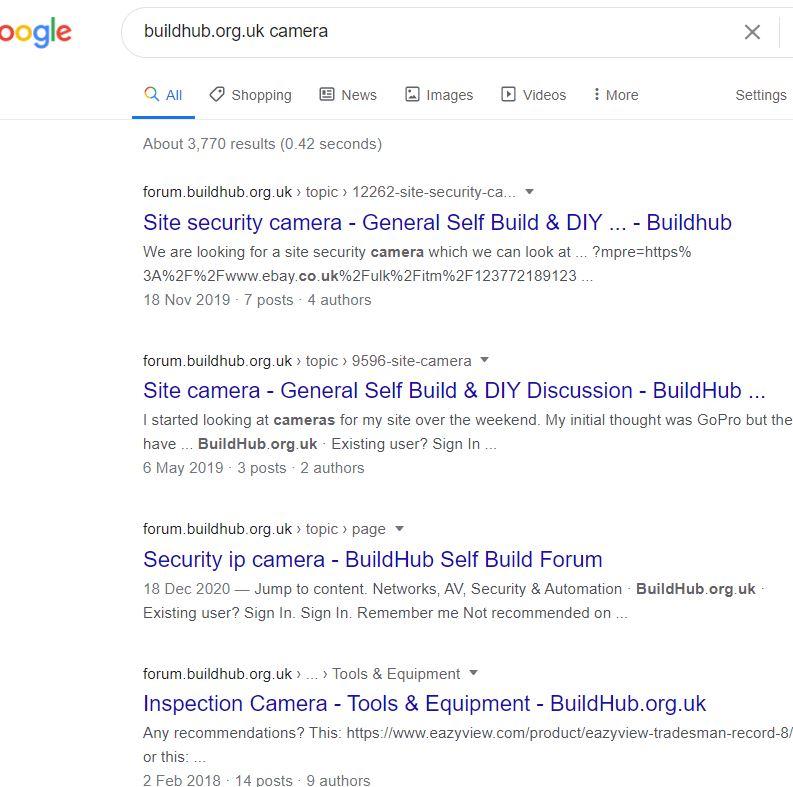

ToughButterCup Posted January 28, 2021 Share Posted January 28, 2021 12 hours ago, John latimer said: I know this has been asked before but I can’t find the answer I am looking for. ... Welcome ..... On Buildhub: Search > in body and titles > " Site camera " results Search > in titles only > "Site camera" results Search > in body and titles > "camera" results Search > in titles only > "camera" results Via a search engine ( in this case Google - others work just as well.) Search >buildbub.org.uk [insert space] camera I took everyone's advice ( as listed above) but also hid a trail camera. Biggest problem for any camera ? Rain. Hide the camera under cover. Wishing you a safe hassle free build Ian Link to comment Share on other sites More sharing options...
