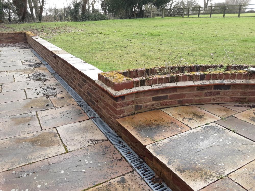

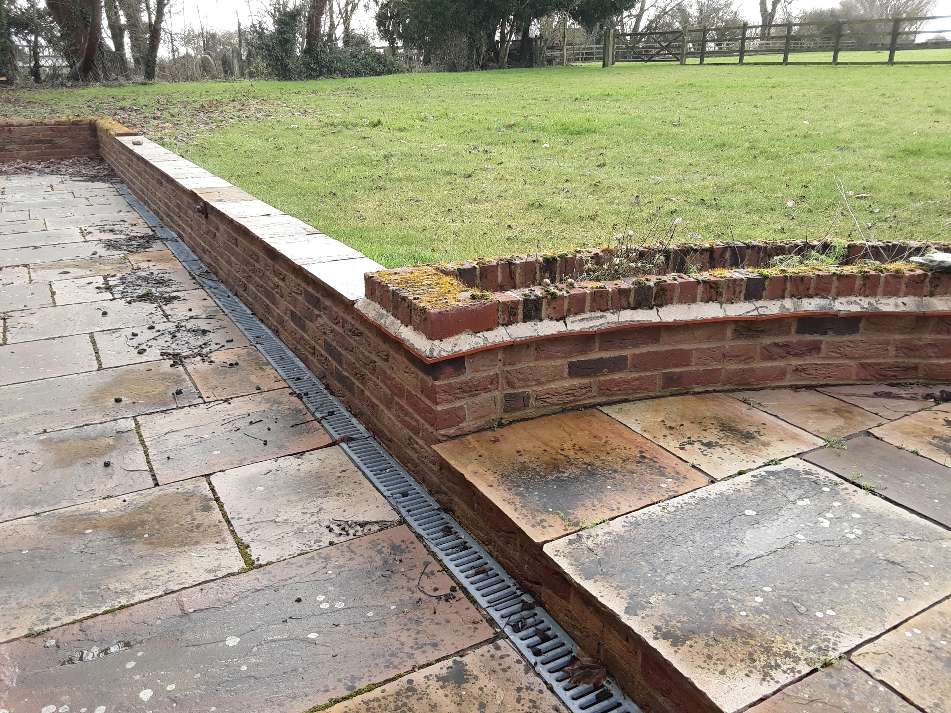

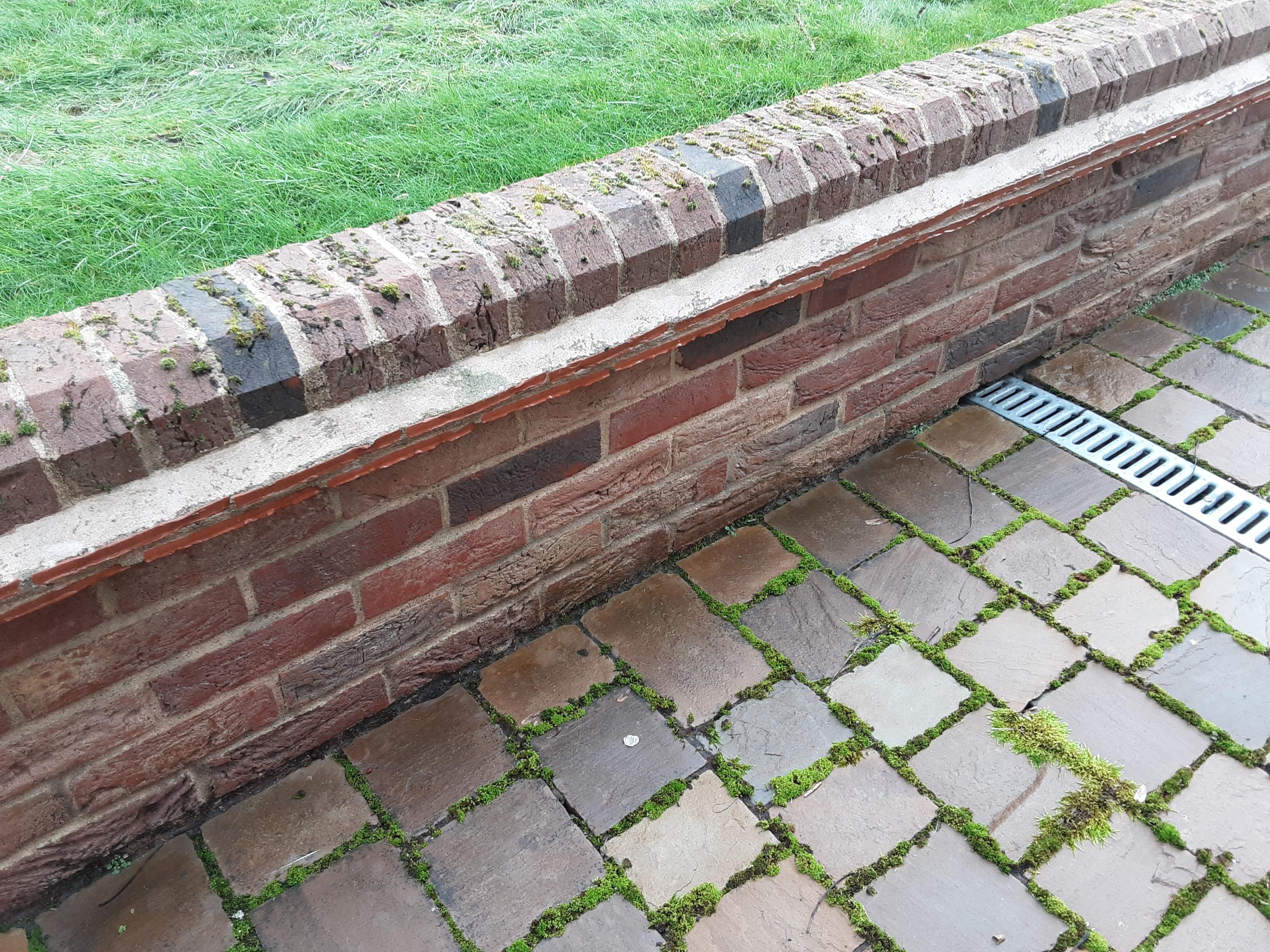

I wouldn't just use MOT for the foundation either.
I have one low height from railway sleepers laid flat and even used concrete for that. I predrilled holes in the sleepers and put the bottom ones down while conc still wet and pushed rebar through into the concrete.
Elsewhere we have the walls in the photos below. We put drainage on both the uphill and down hill side. At the foot of the wall we put a linear drain that drains the patio and collects water coming through the wall. The curved beds are single brick on concrete founds. They have a drain at the bottom and pea gravel.
All bricks and blocks should be FL (frost resistant).
Yes I know patio needs pressure washing and some moss killer.
 20210127_144445.thumb.jpg.a521c576aa4125aa942138803787536d.jpg20210127_144558.thumb.jpg.b48b02f41b164242602e0745d88fb0c8.jpg
