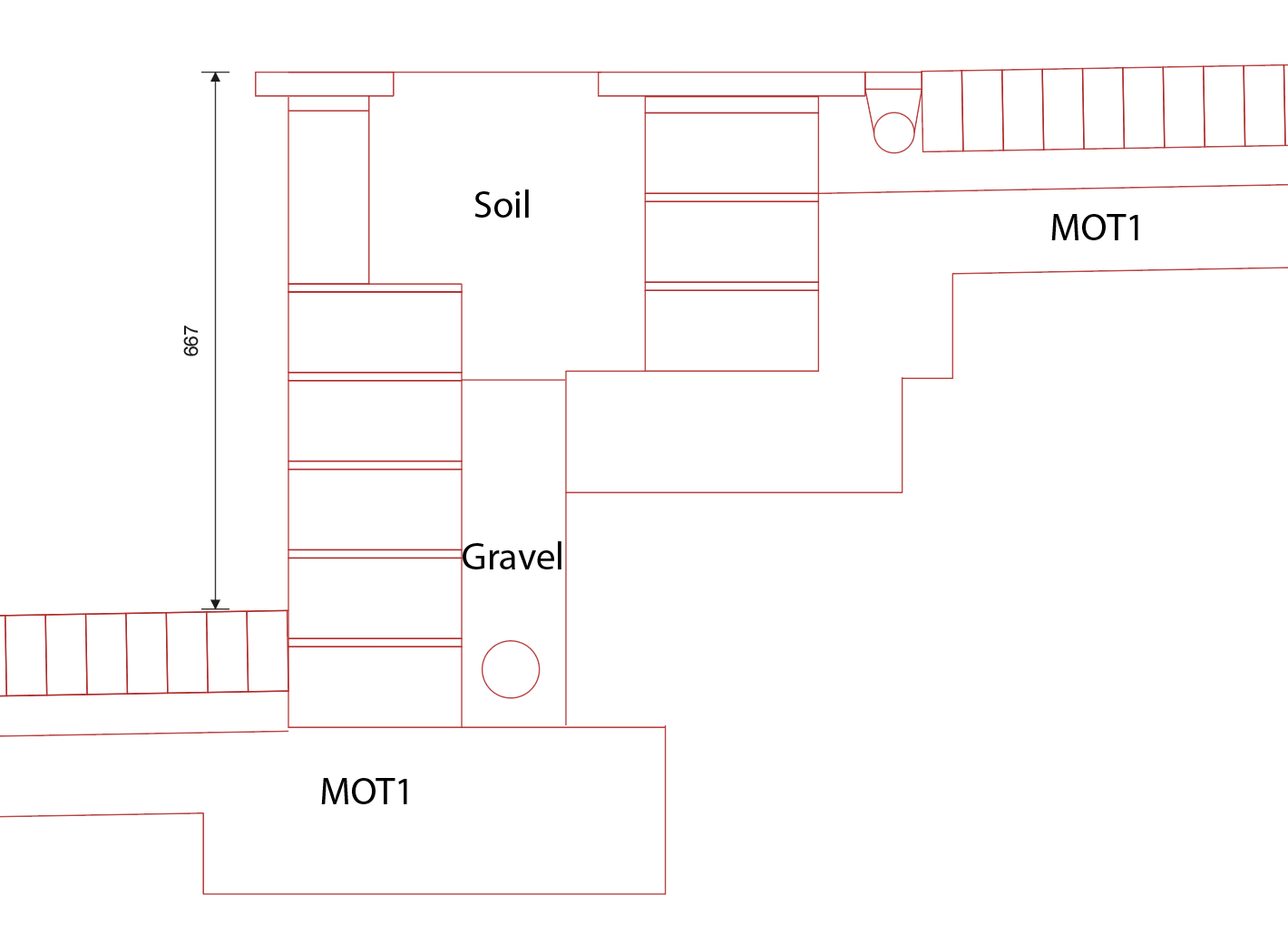

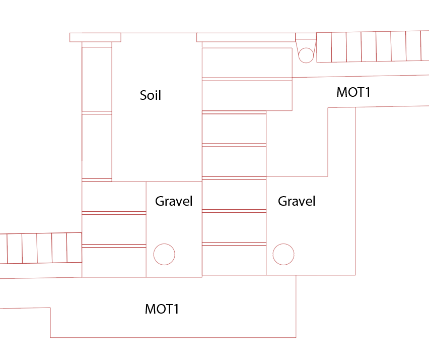

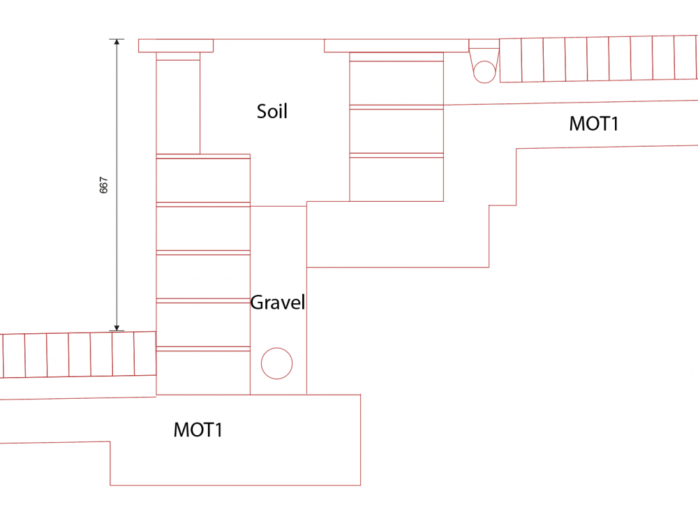

Parksyp's Achievements

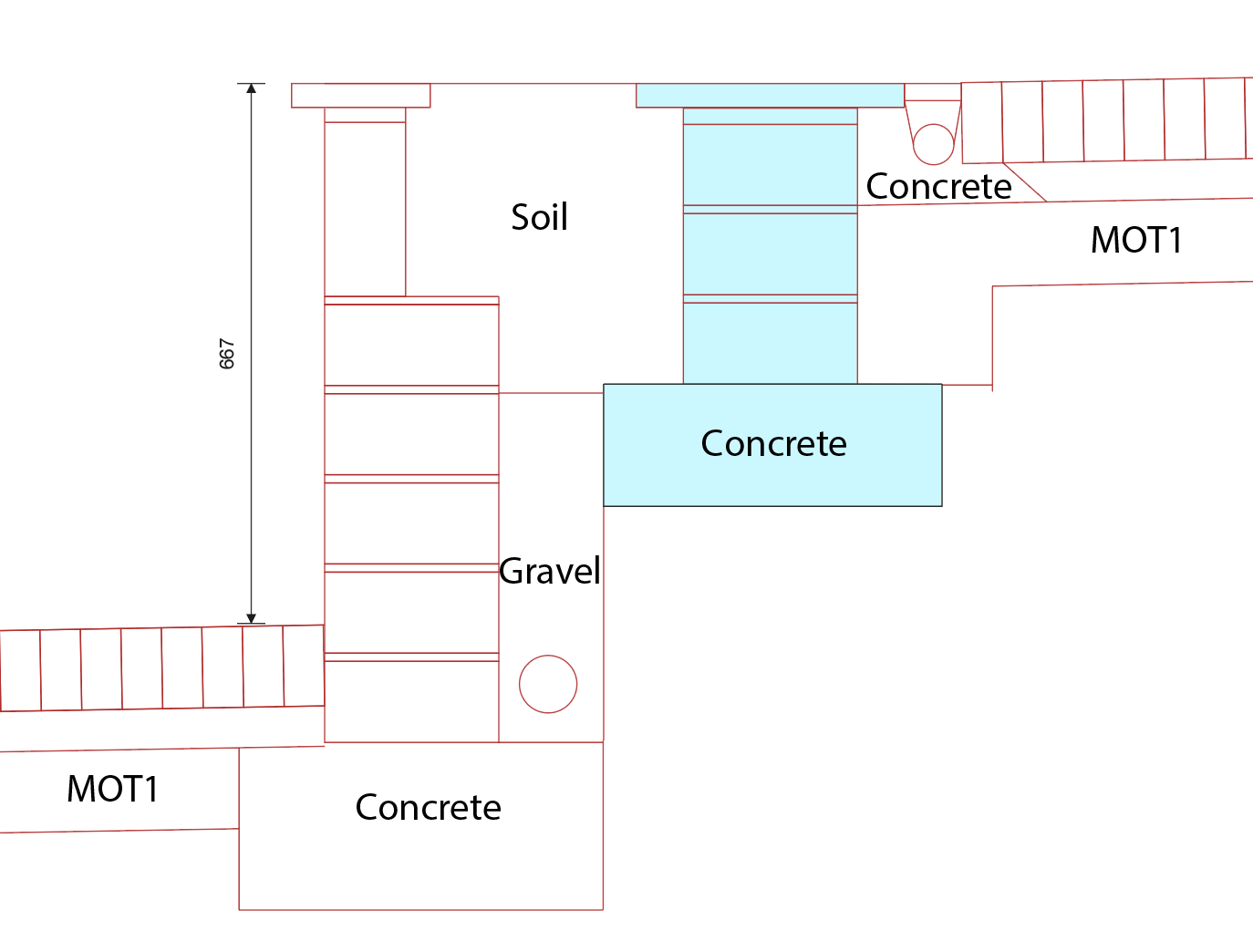

  1. Hi Declan, Further to what you were saying I have sketched out how I imagine that might work - see below. Do I need something to contain the hardcore that the capping stone is going to be sitting on? I want to have soil for planting on the left of it and without more of a wall won't the hardcore 'escape'?

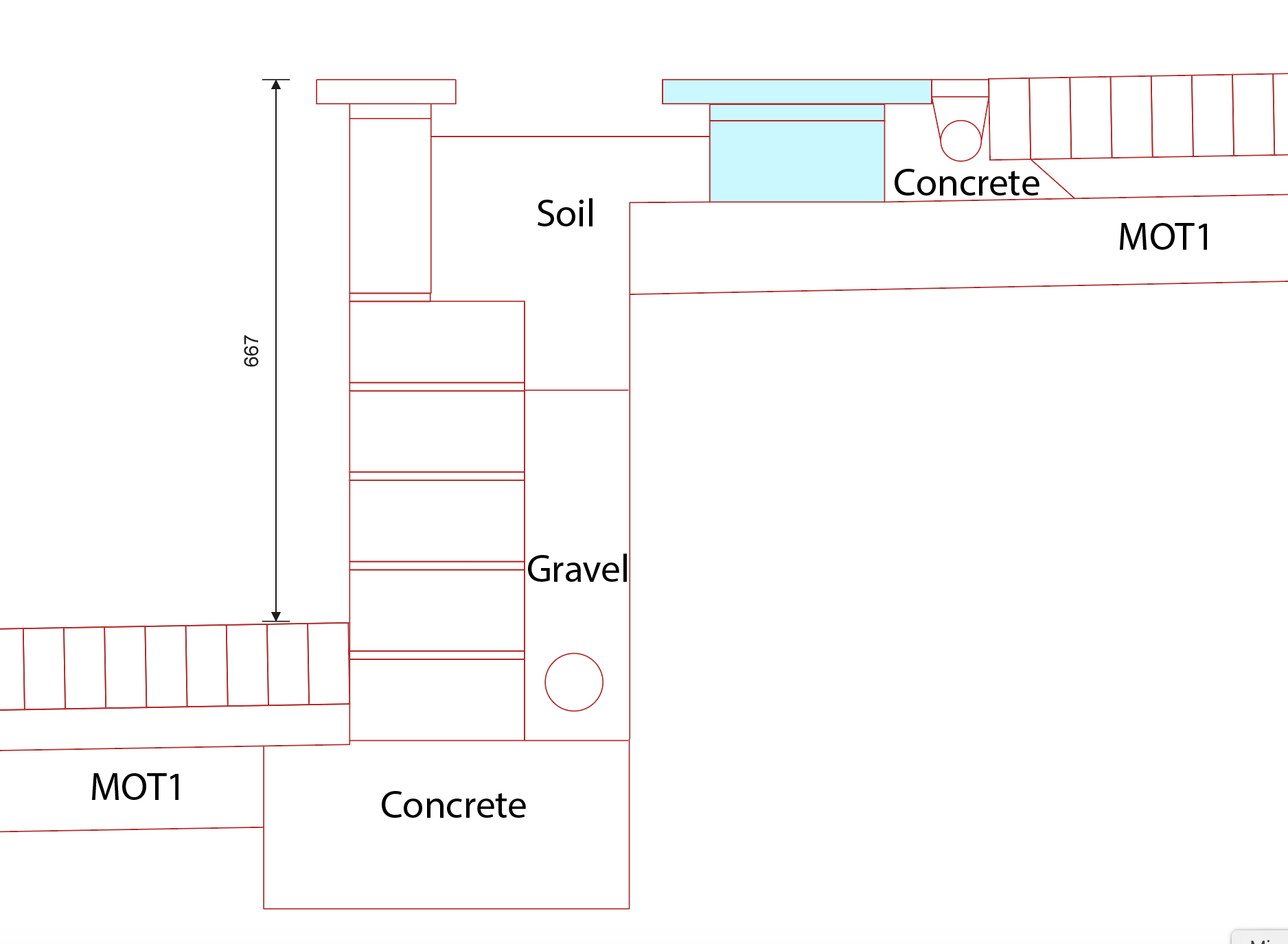

  2. Thanks Declan - that is really helpful. And thanks all for all the answers and convincing me to go with concrete foundations.
  3. Hi Declan, Thanks for your reply. I have amended the drawing to reflect what you suggest. (I think!) So - to be clear - even concrete blocks on compacted type 1 isn't good enough - you would always use a concrete foundation? Is the foundation and the block wall to the edge of the planting and patio overkill? ie is the area shaded blue excessive? It obviously isn't retaining the mass of earth but needs to support the limestone capping stone that runs alongside the pavers. Thanks again for your help and experience - really appreciated.
