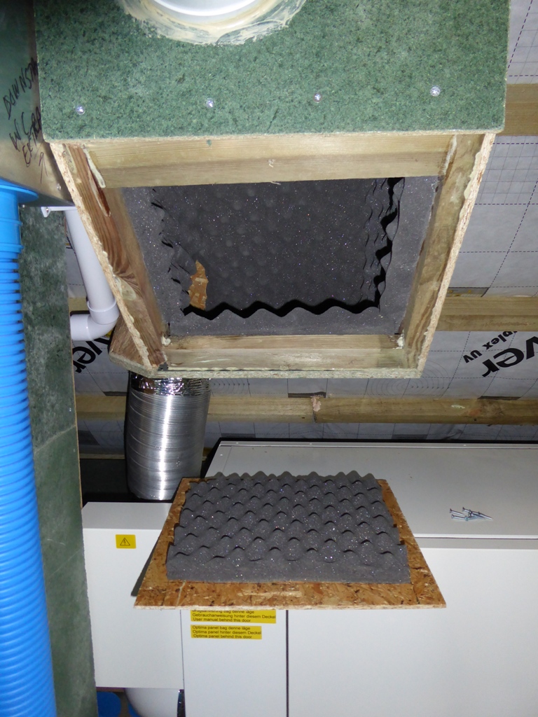

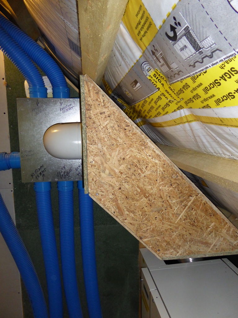

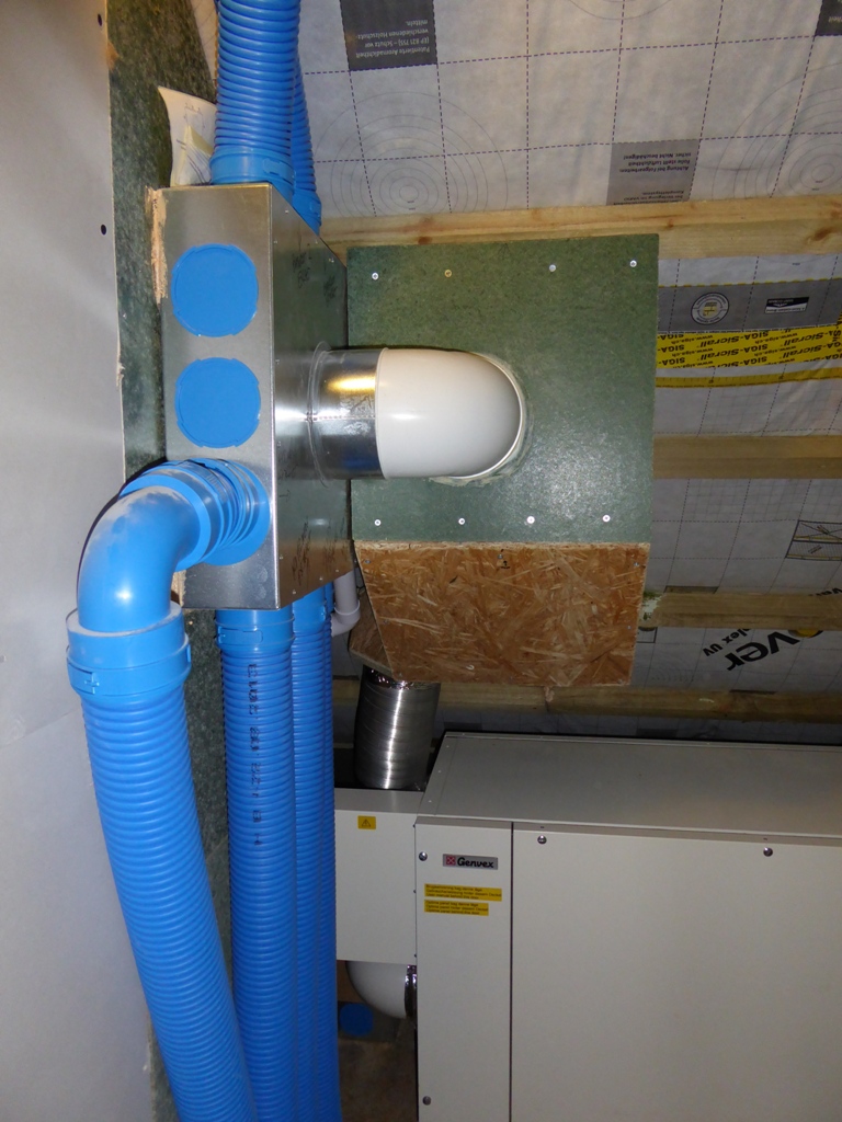

Jeremy Harris Posted February 5, 2017 Posted February 5, 2017 All I can comment on is the way I designed our system, based on first principles of air flow in ducts, the building regs requirements (which are more than a little odd in places) and our personal desire for a silent system in normal use. I also wanted to DIY the install, and had no skills in working with ducts. I started with putting terminals on the CAD plans where there would be the longest possible air flow route through a room, to allow the longest transit time and ensure the best possible chance that the air coming into the room would diffuse out across the whole room volume. The logic of this applies equally to extract terminals, as they are pulling air in from under a door, or through a doorway. For example, in our living room the entrance door is in one corner, so the air feed terminal is in the ceiling of the diametrically opposite corner. Next I looked at duct systems, and concluded that the Swiss designed HB+ (made under licence now by around three or four companies) 75mm OD, "semi-rigid" smooth bore plastic ducting was the easiest to DIY install. I bought a sample terminal and duct fitting on line, had a good look at it, and decided that's what I'd use. Running the ducting was, realistically, something that could only be outline designed first, as the alignment of the ribs in the Posijoists dictated where the ducts had to go, and my CAD plans didn't have the exact position of every joist rib! So, I put all the ducts in, and for safety ran double ducts to the kitchen extract terminal (the HB+ original design includes provision for two ducts per terminal - not all the copies of it do). Once all the ducts were in and I knew the exact fitted length, the radius and position of curves in the ducts and the exact positions of the manifolds, I went back to first principles to calculate the flow rate in each duct at the building regs mandated ventilation rate. I found that I was generally within the low noise range of under about 2.5m/s in most of the ducts, except for the longest run, to our bedroom, where I was around 2.8 m/s at 3/4 of maximum boost, and over 3m/s at full boost. I decided to just see how it panned out, as I could, if need be, run another duct to that bedroom along the eaves space if it turned out to be too noisy. I hooked up the MVHR, mounting it on old-style Mini exhaust rubber bobbins (there's a bit here about it: http://www.mayfly.eu/2014/04/part-thirty-mvhr-details/) and made an error, in not fitting the recommended silencers in the main ducts that feed the manifolds. This was me thinking the plenum effect in the manifolds would act as silencers, I was wrong! I then set about setting the system up, by fitting restrictor plates inside the manifolds to control the flow rate in each duct. I made up a home made flow meter, by buying a (still in calibration) second hand hot wire flow meter from ebay for around £30, and then gluing some PVC duct reducers and pipe together to make a cone and flow straightening pipe to take the flow meter. Here's a photo of it in use - anyone is welcome to borrow it, but it's no longer officially in calibration (not that I think for one moment that matters much - these things are very stable unless damaged, and BC seem not to be bothered): To be honest, balancing the individual ducts was the worst part of the job, as it meant doing a measurement at a terminal, seeing what the flow was, running upstairs, opening the manifold, adjusting the restrictor plates by punching different rings out, then going back and repeating the exercise. What's more, there are interdependencies, because the plenum pressure changes with every flow adjustment................ Thankfully it's a one-off task, and because there's no flow adjustment at the terminals, the noise is lower and you can pop them off and stick them in the dishwasher to clean them, without fear of messing up the flow rate settings. I mentioned earlier that I didn't fit silencers, even though Genvex said they should be fitted to the room side of the unit (fresh air feeds and extracts). The reason was there wasn't room to fit ready made silencers, and as above I wrongly thought the plenums would do the job. So, I ended up making custom built absorption silencers, lined with acoustic foam (the fire resistant stuff). They aren't pretty, but they work incredibly well, there is no noise at all from any duct, except when the system is on full boost, and even then the noise is only just audible, and not enough to disturb sleep (not that it's likely that anyone in our household would be sleeping when the things on full boost, anyway. Here are some photos of one of my custom built silencers, the extract side one. The fresh air feed one is just a rectangular box, lined with acoustic foam and sat directly onto the top of the extract manifold, which is on the floor, out of sight behind and to the left of the MVHR. Front view of extract silencer Side view of extract silencer Internal view with the front cover unscrewed Not sure if this helps or hinders, Mike, but we did end up with a system that changes the air in the house about once every 2 1/4 hours, seems to keep it very well ventilated and is pretty much silent. Several people here have visited and heard it running, and they may well be able to give an independent view as to whether they thought it was as quiet as I think it is!

Jeremy Harris Posted February 5, 2017 Posted February 5, 2017 Frankly I'd not get too hung up on duct flow rates if you go for a radial system like ours. You can calculate things out to the nth degree, but there are so many variables around in practice that at best your calcs will be within around 50% of the measured flow rates. I spent an awful lot of time doing calculations, only to find that in practice they were miles out! A good example is the kitchen extract. To meet the max extract needed by BRs, I fitted two ducts to that terminal. It's running in balance with one of those ducts throttle down to the smallest restrictor disk and the other with a disk that's around 2/3rds the maximum, so a single duct would have easily met the regs. One thing I forgot above - don't make the mistake I made of fitting the intake on one external corner of the house and the exhaust on the other. In our case the slightest breeze throws the balance and flow rates out a lot, and I've got some cowled stainless external terminals that I intend fitting, with the intake cowl pointed away from the wind that blows along that wall, to try and fix the issue. Practically it doesn't seem to have any noticeable effect, but it does make the flow rates at the terminals leap around a fair bit when you are measuring them.
MikeSharp01 Posted February 5, 2017 Author Posted February 5, 2017 (edited) Thanks again, mid supper prep, I guess I want to show the BR people that I have thought things through and in the end if I get the full 4 ACH in boot mode, for the internal WC/ en-suite on about the 75% speed setting and under 2 SFP I will be happy. Good point on the location of the inlet / outlet of the unit. My plan was run then straight up, cowell them both and have the outlet above the inlet by a meter or two. I am not sure I can get them separated much in X or Y given restrictions of the plot boundary. Edited February 5, 2017 by MikeSharp01
