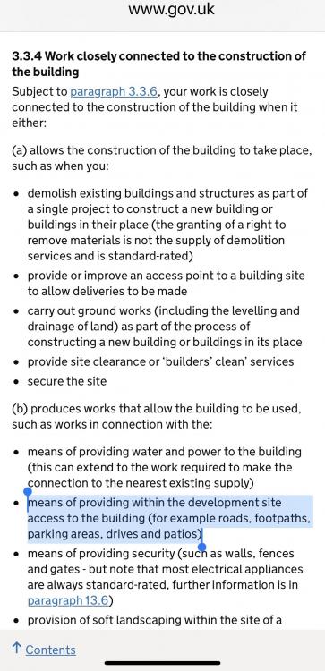

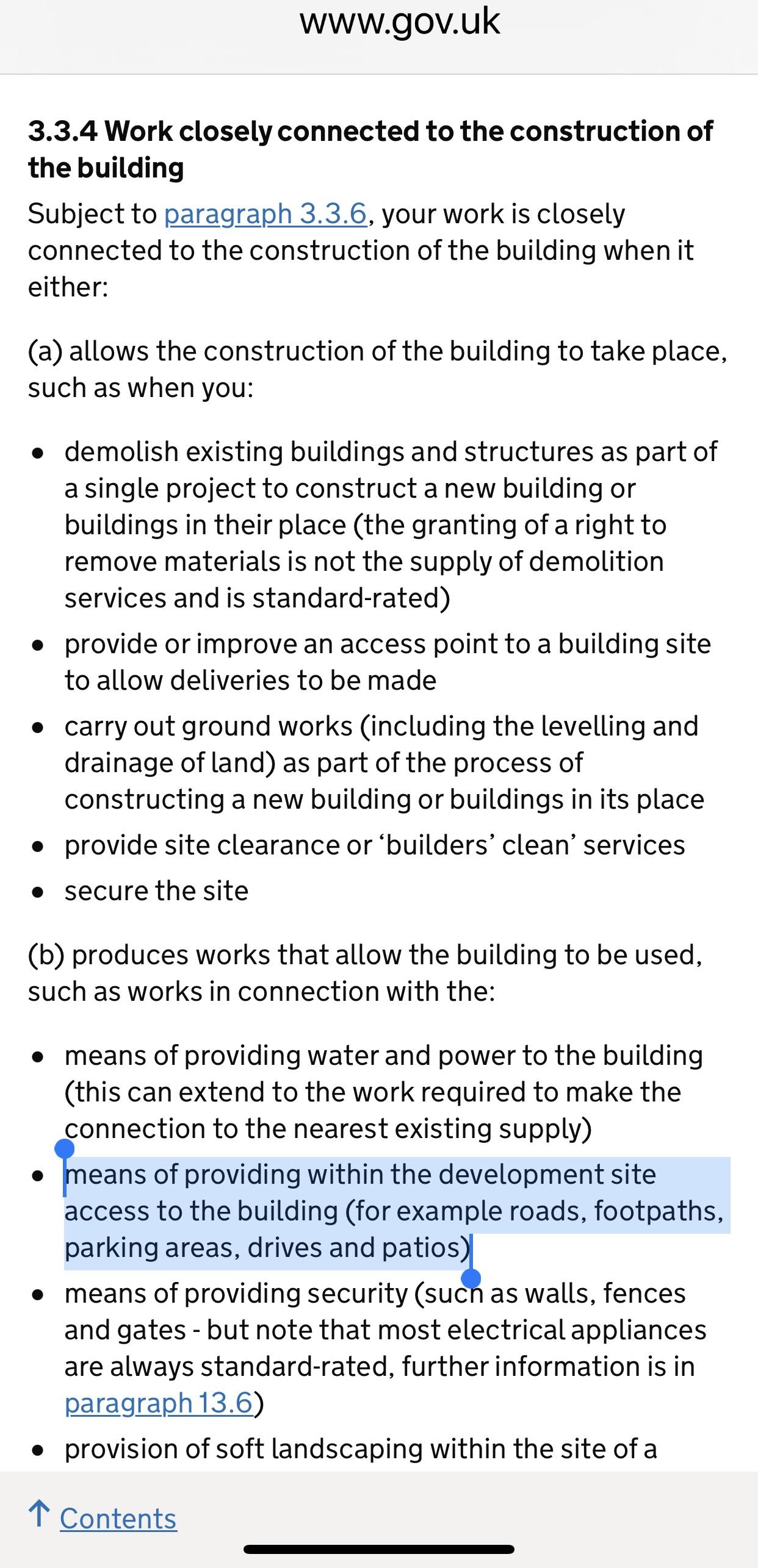

newhome Posted January 19, 2021 Share Posted January 19, 2021 Unless your builder has worked on several self builds he might not be aware of that. Adding a drive to an existing dwelling will attract standard VAT. In your case zero rating will apply. If he’s not sure direct him to VAT Notice 708 (see link) as per the screenshot posted. He may want proof from you in which case give him a copy of the planning permission. Builders can be hit with penalties if they don’t charge VAT at the correct rate so he may be cautious. https://www.gov.uk/guidance/buildings-and-construction-vat-notice-708 Link to comment Share on other sites More sharing options...

Temp Posted January 26, 2021 Share Posted January 26, 2021 Never heard of a "zero vat number". Offer him a certificate which is essentially a letter confirming that the work should be zero rated as it relates to the construction of a new dwelling at... and quoting your planning reference number, site address, your name and contact details. Attach copy of your planning grant. Your drive should definitly be zero rated. However its possible he may argue the neighbours driveway should be standard rated. If and only if he raises this issue point out that VAT Notice 708 has a section that covers "3.3.4 Work closely connected to the construction of the building" and argue that it comes under "(a) allows the construction of the building to take place,..". I would not mention it unless he does because its open to interpretation. The fact that it on your planning approval helps argue the point. Link to comment Share on other sites More sharing options...
