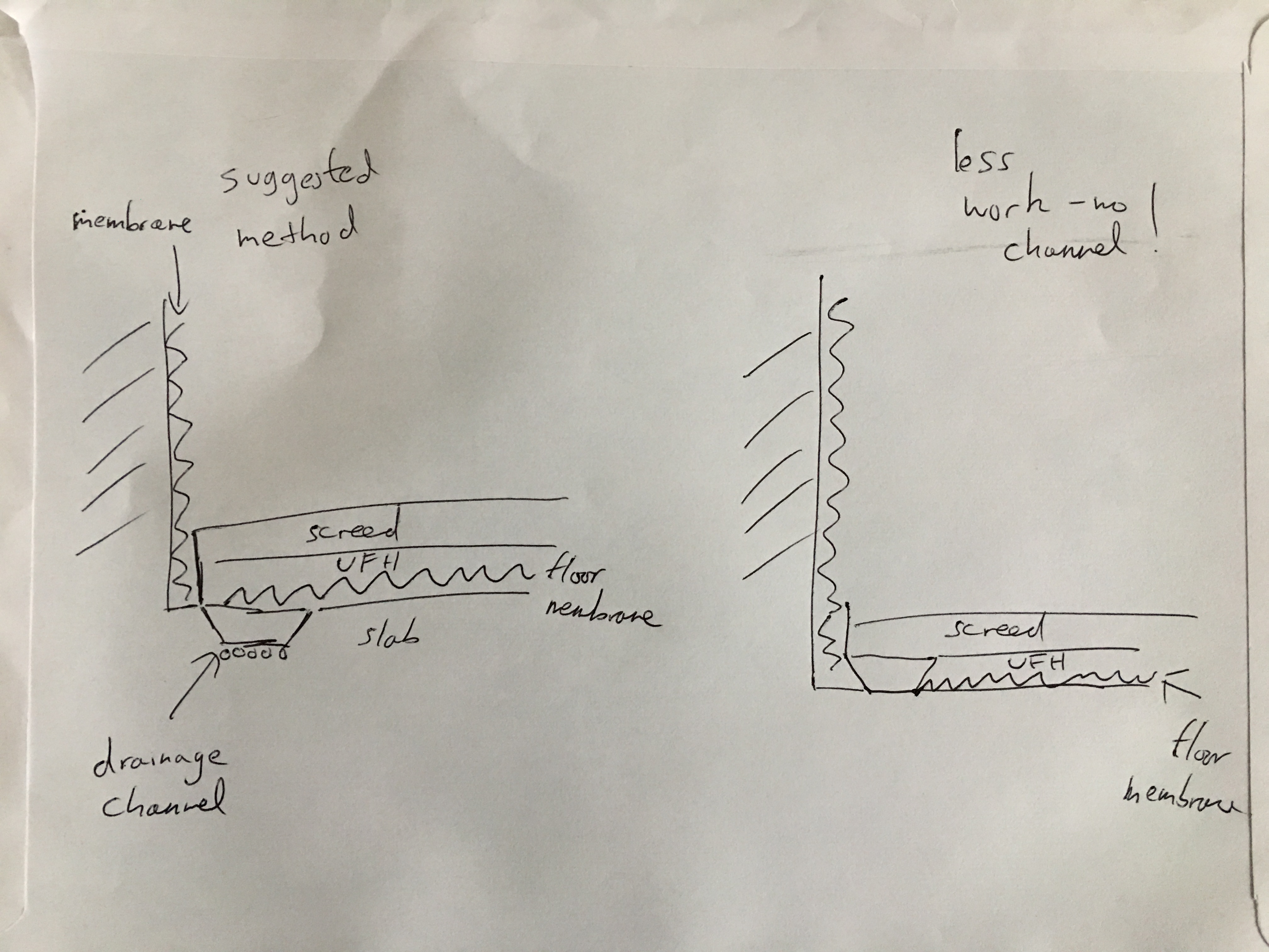

Pocster Posted February 3, 2017 Author Posted February 3, 2017 WET UFH Will put some drawings up to help explain
Pocster Posted February 3, 2017 Author Posted February 3, 2017 (edited) There! Hope that helps. I called a few of the membrane suppliers and most suggested it had to (unsurprisingly) have the channel below the floor level. But some definitely had it sat on the floor! Is my suggestion ok?. Majority of any water ingress is via the walls; but I have to assume it's possible I may get some up through the slab. Thanks p.s. forgive quality artwork! Edited February 3, 2017 by pocster
Pocster Posted February 3, 2017 Author Posted February 3, 2017 (edited) Right! Finally got to talk to someone who seemed to understand! Easiest solution seems to be battens around the perimeter and a sacrificial screed in the centre thereby creating my 'channels'. Presumably then floor membrane ontop ; UFH and final screed. Just one question if this is the best method. The existing slab; does it need 'treating' before the sacrificial screed is applied or will that just stick anyway (obviously will jet/clean slab first)? Edited February 3, 2017 by pocster
IanR Posted February 3, 2017 Posted February 3, 2017 Neither of your sections show (for me) a viable floor. Are you expecting moisture to breach your slab and insulation (or is insulation between slab and screed) and therefore require draining from between the slap top and screed? Have you got the original engineering drawings of the "suggested" slab. Are you sure your "drainage channel" should not be running within the sub-base below the slab?
Pocster Posted February 3, 2017 Author Posted February 3, 2017 (edited) The slab is insulated to 250mm. Whats wrong with the drawings? i.e. no viable floor??????? here's a manufacturers info; you can see the 4 suggested methods http://static.safeguardeurope.com/downloads/datasheets/aquadrain-perimeter-drainage-channel-datasheet.pdf#_ga=1.192104355.866109518.1486119729 So example 2) is what I'd end up with by adding a sacrificial screed. Actually floor spec; is just this!!! Floor Structure 50mm screed on; cast in situ reinforced concrete slab to Structural Engineer's details on; polythene on; 100mm thickness insulation on; tanking membrane on; blinded hardcore Edited February 3, 2017 by pocster
IanR Posted February 3, 2017 Posted February 3, 2017 I did caveat my comment with "for me". I'd not seen this sort of detail before. In the OP you mention insulated slab, and to me if water is breaching the insulation it's going to negate it. ie. water at ground temp will get passed the the insulation and on to the underside of your screed with the UFH pipes in, so you end up warming up the ground water.
Pocster Posted February 3, 2017 Author Posted February 3, 2017 (edited) 6 minutes ago, IanR said: I did caveat my comment with "for me". I'd not seen this sort of detail before. In the OP you mention insulated slab, and to me if water is breaching the insulation it's going to negate it. ie. water at ground temp will get passed the the insulation and on to the underside of your screed with the UFH pipes in, so you end up warming up the ground water. :-) I know when you said "for me" I assume I've done it wrong ! Yes. My assumption was the UFH could end of heating 'ground water'. So with the floor membrane beneath the UFH this should be avoided. Beneath the insulation in the slab is plastic sheeting ; but I guess this can only reduce the chance of water coming up through the slab. After-all it only takes 1 hole somewhere!. Perhaps I'm going belts 'n' braces on this - but better safe than sorry! Edited February 3, 2017 by pocster
IanR Posted February 3, 2017 Posted February 3, 2017 Just now, pocster said: Yes. My assumption was the UFH could end of heating 'ground water'. So with the floor membrane beneath the UFH this should be avoided. No, with membrane beneath the insulation, the insulation would avoid you heating up the ground water and sub-base. If the slab is already in then I would have thought you need to insulate above the slab, on top of the membrane.
Pocster Posted February 3, 2017 Author Posted February 3, 2017 (edited) So *more* insulation on top the slab?? Insulated Slab Screed to make height for drainage channel Floor membrane for drainage Insulation UFH Screed That correct?? Edited February 3, 2017 by pocster
IanR Posted February 3, 2017 Posted February 3, 2017 No, more like no. 1 on the sheet you linked to. Slab Membrane (tanking) Insulation (120mm - 200mm PIR) and form the channel at perimeter 75mm screed with UFH over the top of insulation and channel. Then male sure the channel drains well to a sump and keep the sump clear. I think I'd want a couple of pumps for redundancy to protect from pump failure.
Pocster Posted February 3, 2017 Author Posted February 3, 2017 (edited) Ah I see. So you are saying use the insulation in the centre to form my channels (rather than sacrificial screed). One company did suggest this; but said I had to use foam glass for the insulation - now I know; this stuff is MEGA expensive! - it would be cost ineffective. I think the problem was walking on the floor membrane would simply dent the insulation . I'll have 2 or 3 sump pumps with battery backup; don't worry about that!! p.s should I 'stick' the insulation to the slab???? Edited February 3, 2017 by pocster
IanR Posted February 3, 2017 Posted February 3, 2017 Slab with insulation above and and then screed on top is pretty standard. I assume the advice you had for using foam glass would be relating to a sole plate for any load bearing walls. The PIR insulation under the screed is non-load bearing, so can't go underneath any load bearing walls. If you have load bearing walls then you could use foam glass to reduce the cold bridge at the floor junction. No need to "stick" the insulation to the slab. I'm concerned something is being missed. Who specified the insulation under the slab, but tanking and drain channels above/within the slab? Is there any other drainage specified under the slab insulation, within the sub-base? Is it possible the drainage within the slab is belt and braces and will only be called into effect if there is a failure somewhere?
