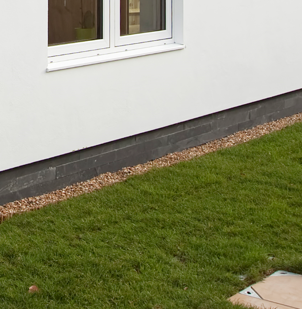

Ralph Posted January 12, 2021 Share Posted January 12, 2021 Hi all, We're looking at what to use to finish of the external blockwork between the cedral cladding and ground. The ground is quite wet so we'll be putting in drainage and probably finishing with gravel or slate chippings. There is also insulation board to go against the block work but I'm not sure what to finish it with. The builder is taking about using what looks like Eurocell soffit board in a dark grey and I'm looking at some flat cedral cement board. Any thoughts? Thanks Link to comment Share on other sites More sharing options...
Pete Posted January 12, 2021 Share Posted January 12, 2021 1 hour ago, Ralph said: Hi all, We're looking at what to use to finish of the external blockwork between the cedral cladding and ground. The ground is quite wet so we'll be putting in drainage and probably finishing with gravel or slate chippings. There is also insulation board to go against the block work but I'm not sure what to finish it with. The builder is taking about using what looks like Eurocell soffit board in a dark grey and I'm looking at some flat cedral cement board. Any thoughts? Thanks Alot of us have used Ubiflex and it looks really smart. Put this is the search engine on here 1 Link to comment Share on other sites More sharing options...
Mr Punter Posted January 12, 2021 Share Posted January 12, 2021 I have used natural slate tiles. We did adhesive and mesh on the insulation, then the tiles. Butted up with no grout. 2 Link to comment Share on other sites More sharing options...
Ralph Posted January 12, 2021 Author Share Posted January 12, 2021 4 hours ago, Pete said: Alot of us have used Ubiflex and it looks really smart. Put this is the search engine on here I'll take a look at that thanks, I would never have thought of using that. Link to comment Share on other sites More sharing options...
Jilly Posted January 12, 2021 Share Posted January 12, 2021 11 minutes ago, Ralph said: I'll take a look at that thanks, I would never have thought of using that. Any chance of a photo of how you've used it, please? Link to comment Share on other sites More sharing options...
Pete Posted January 12, 2021 Share Posted January 12, 2021 2 hours ago, Jilly said: Any chance of a photo of how you've used it, please? Look under "covering an eps plinth" there are photos on there. I used the Ubiflex on top of blockwork and it looks really smart Link to comment Share on other sites More sharing options...
