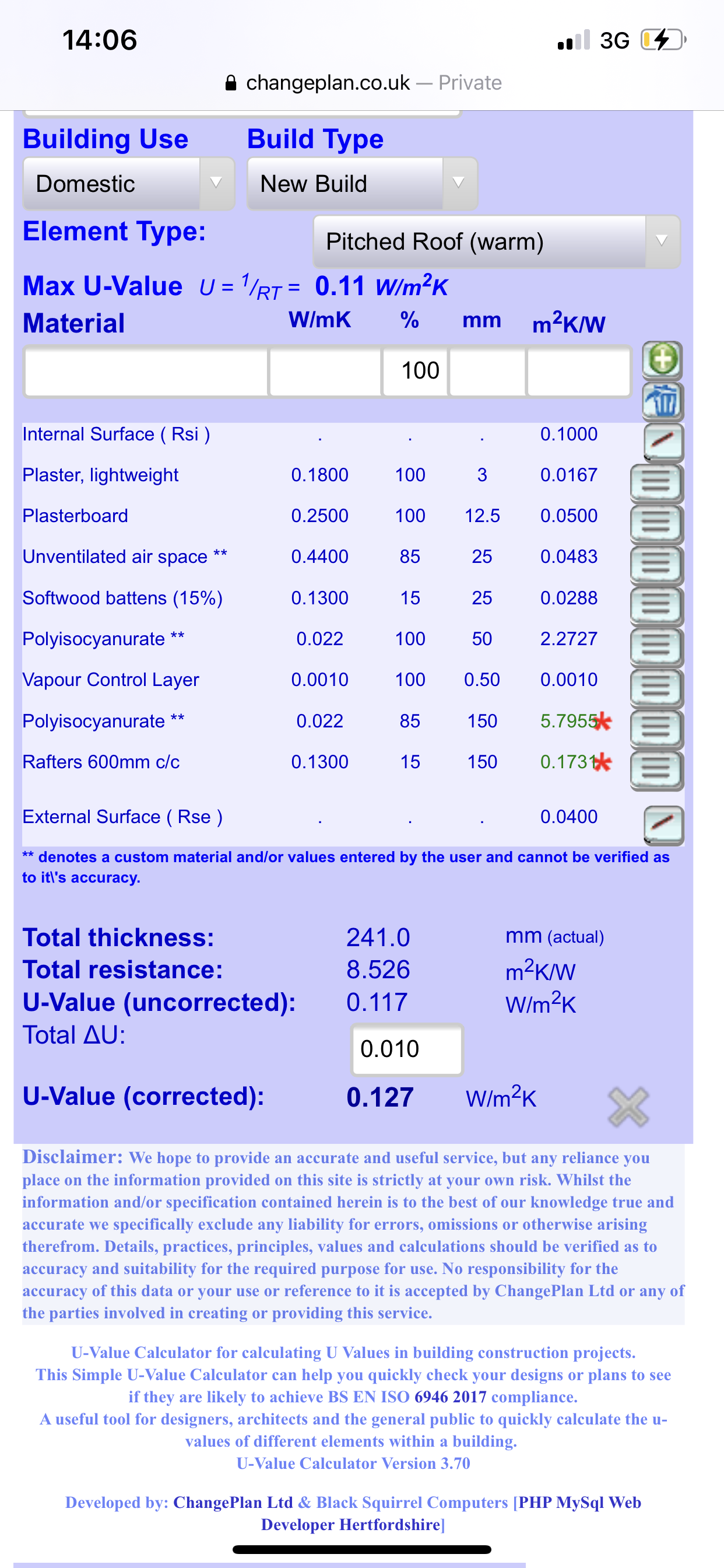

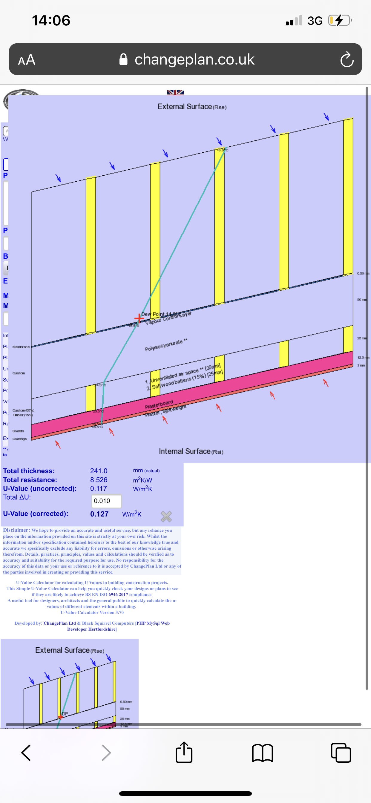

Hi all, I have been using an online u value calculator to make sure the build up of my sloped ceiling won’t cause any issues with dew point/interstitial condensation.
I plan to put intello plus across the rafters so that I can minimise puncturing it.
Does this look ok?
Thanks James

Does this look ok?
It does look OK but I would prefer the Intello on the warm side of the 50mm PIR layer, much bigger difference between actual and saturated vapour pressures. Are not 25 x 50mm battens inadequate without fixing to something else?
I'd go plasterboard, service cavity, intello, PIR.
At lease then if it gets punctured you can see the damage and fix it. Staples and screw holes don't make any difference really.
Better still I'd swap out the PIR between the rafters to dritherm or metac batts or best of all pumped cellulose.

Thanks for your replies,
I am carrying out all of the work myself. The 150mm is already in.
I have siga twinet tape to stick the vcl to the rafters, That’s why i going to position it in between both layers of PIR.
I was going to use 25x38 roofing laths screwed through the pir into the rafters.
