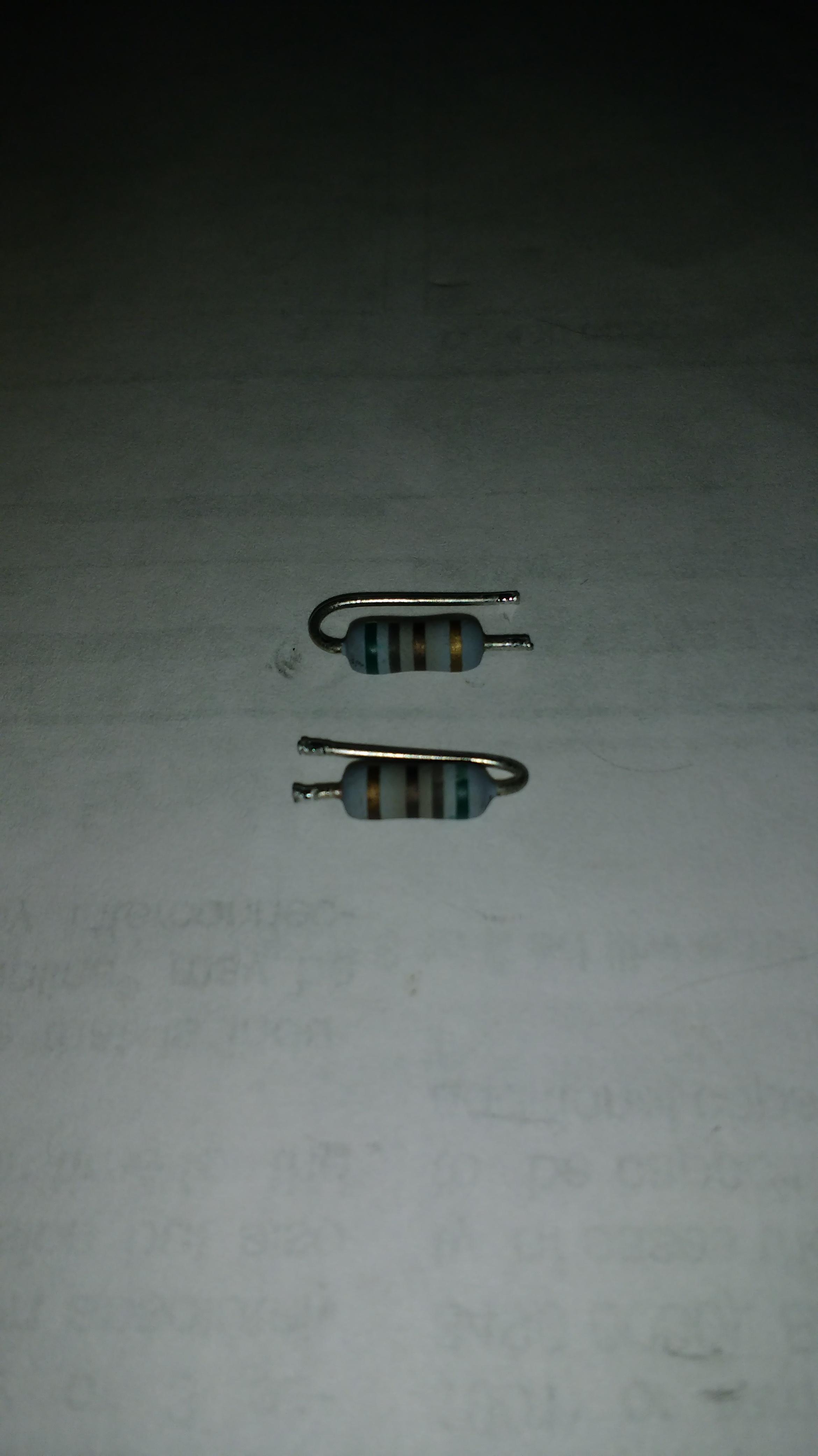

Onoff Posted January 14, 2021 Author Posted January 14, 2021 On both the + & - output of the unit is a chunky resistor. Both look a bit brown but both measure at 5.6 Ohm. It holds with me thinking it died as the output was shorted.

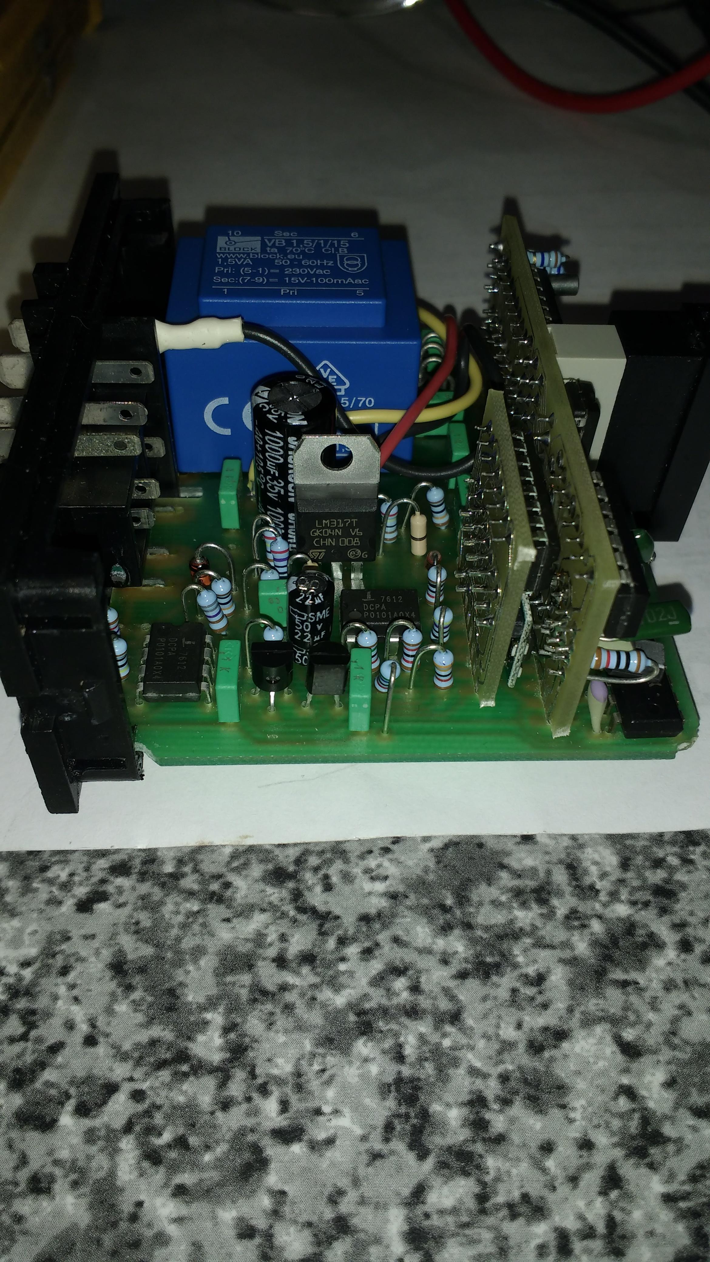

Onoff Posted January 14, 2021 Author Posted January 14, 2021 The two ICs in the foreground, in front of the regulator are 7612 op amps.
dpmiller Posted January 14, 2021 Posted January 14, 2021 something's certainly pulling it down. Maybe try cutting the odd track to narrow it down?

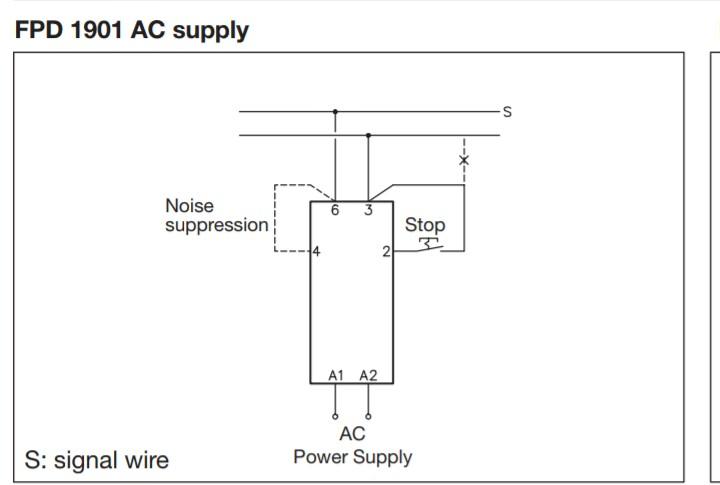

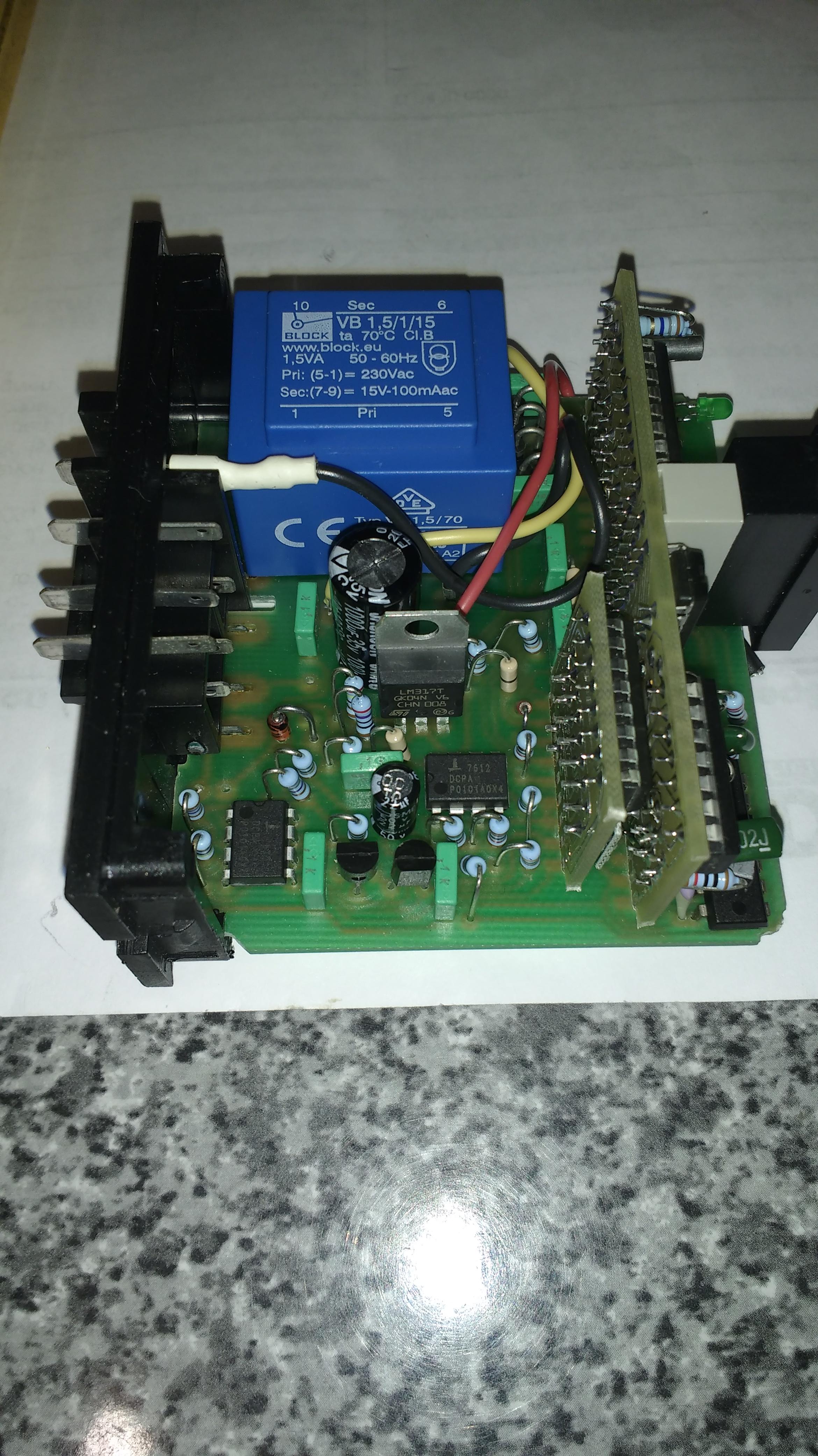

Onoff Posted January 15, 2021 Author Posted January 15, 2021 3 hours ago, dpmiller said: something's certainly pulling it down. Maybe try cutting the odd track to narrow it down? In this photo, top right, at the back is the green supply LED. That's now coming on whereas it wasn't before. That is it's coming in even with these low DC voltages. The vertical boards to the right are essentially the channel generator I think and the right hand side, around the regulator crates the 8.2vdc that goes down pin 6. The other wire for the 2 wire comms is pin 3. In my application it's just supply to A1/A2 and then 2 wires from 3 & 6. I should be measuring I think 8.2vdc across 3 & 6. I'm measuring 1vdc only. (Pins 2 & 4 not used).

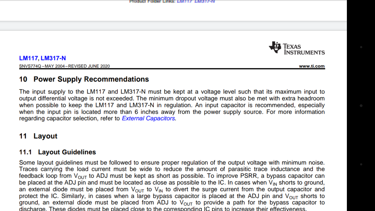

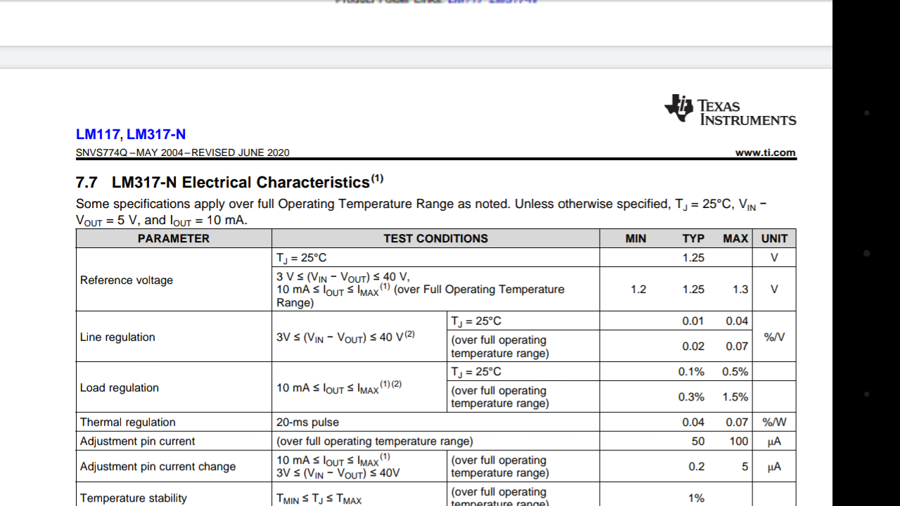

Onoff Posted January 15, 2021 Author Posted January 15, 2021 Is perhaps the 0-15v transformer not a high enough voltage to start with? Then: As I read it there's a minimum voltage differential of 3V needed. I've 5Vdc out of the bridge rectifier and R1/R2 are set up to give Vout as over 12V. So a circa 7V differential. (I have btw the 317T not 317N). Thinking to sling in a 0-24V trannie and see what gives.
dpmiller Posted January 15, 2021 Posted January 15, 2021 If it 22VAC off load and you're only seeing 5VDC out of the bridge, there's a short somewhere IMHO. I'd be removing the supply from each of the op-amps and from the two cards, to try and pinpoint it. 1
Temp Posted January 15, 2021 Posted January 15, 2021 7 hours ago, Onoff said: As I read it there's a minimum voltage differential of 3V needed. I've 5Vdc out of the bridge rectifier and R1/R2 are set up to give Vout as over 12V. So a circa 7V differential. Typo? You've got a -7V differential. eg If Vout is designed to be 12V then Vin must be >15V.

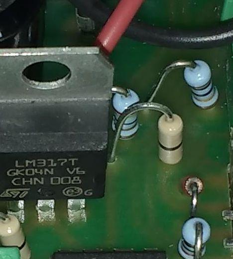

Temp Posted January 15, 2021 Posted January 15, 2021 Probably not this but in one image it looks like a resistor lead might be touching the heatsink tab of the 317. The tab is connected to the Output of the 317 regulator inside it so accidental electrical connections should be avoided. (aside: You might also be able to use the tab as a convenient place to measure Vout.).
