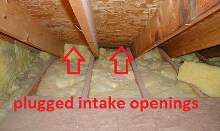

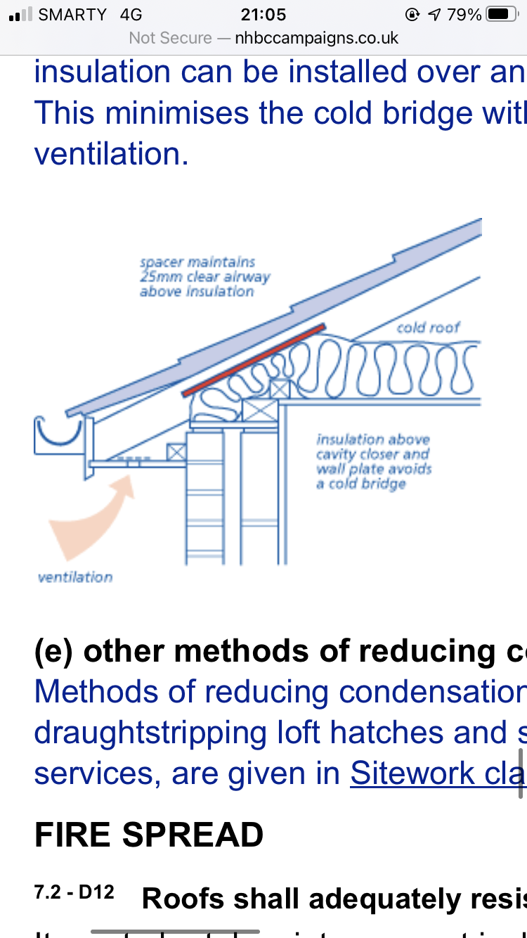

Onoff Posted January 17, 2021 Share Posted January 17, 2021 @canalsiderenovation, out of interest do you have ridge ventilation too? As an aside sometimes the loft insulation can be pushed too far into the eaves and that prevents the ventilation getting up past it to the underside of the roof. Link to comment Share on other sites More sharing options...
canalsiderenovation Posted January 17, 2021 Author Share Posted January 17, 2021 8 minutes ago, Onoff said: @canalsiderenovation, out of interest do you have ridge ventilation too? As an aside sometimes the loft insulation can be pushed too far into the eaves and that prevents the ventilation getting up past it to the underside of the roof. No I don't think we have ridge ventilation. I'll ask them to check the loft insulation when they return and keep an eye out Link to comment Share on other sites More sharing options...
Onoff Posted January 17, 2021 Share Posted January 17, 2021 8 minutes ago, canalsiderenovation said: No I don't think we have ridge ventilation. I'll ask them to check the loft insulation when they return and keep an eye out Have a look at the some of the images here. The "arrows" represent the airflow you want to wick away moisture. https://www.google.com/search?q=eaves+ventilation+airflow&tbm=isch&ved=2ahUKEwjE0a7Yl6PuAhVP_4UKHbviC_YQ2-cCegQIABAC&oq=eaves+ventilation+airflow&gs_lcp=ChJtb2JpbGUtZ3dzLXdpei1pbWcQAzoECCMQJzoCCAA6BAgAEB46BAgeEApQpU1Y1F9g8GdoAHAAeACAAXWIAYUHkgEDNS40mAEAoAEBwAEB&sclient=mobile-gws-wiz-img&ei=lUoEYISzDs_-lwS7xa-wDw&bih=512&biw=360&client=ms-android-motorola&prmd=simvn This grabbed from a US site: 1 Link to comment Share on other sites More sharing options...
TonyT Posted January 17, 2021 Share Posted January 17, 2021 1 Link to comment Share on other sites More sharing options...
