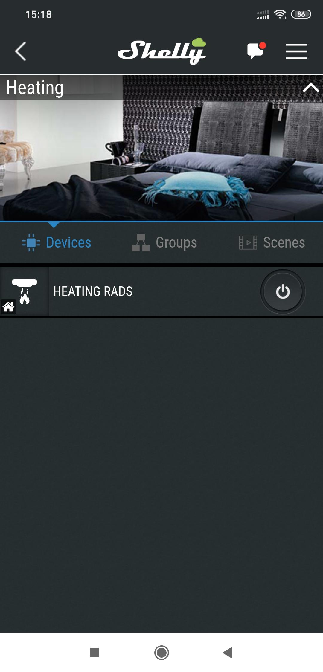

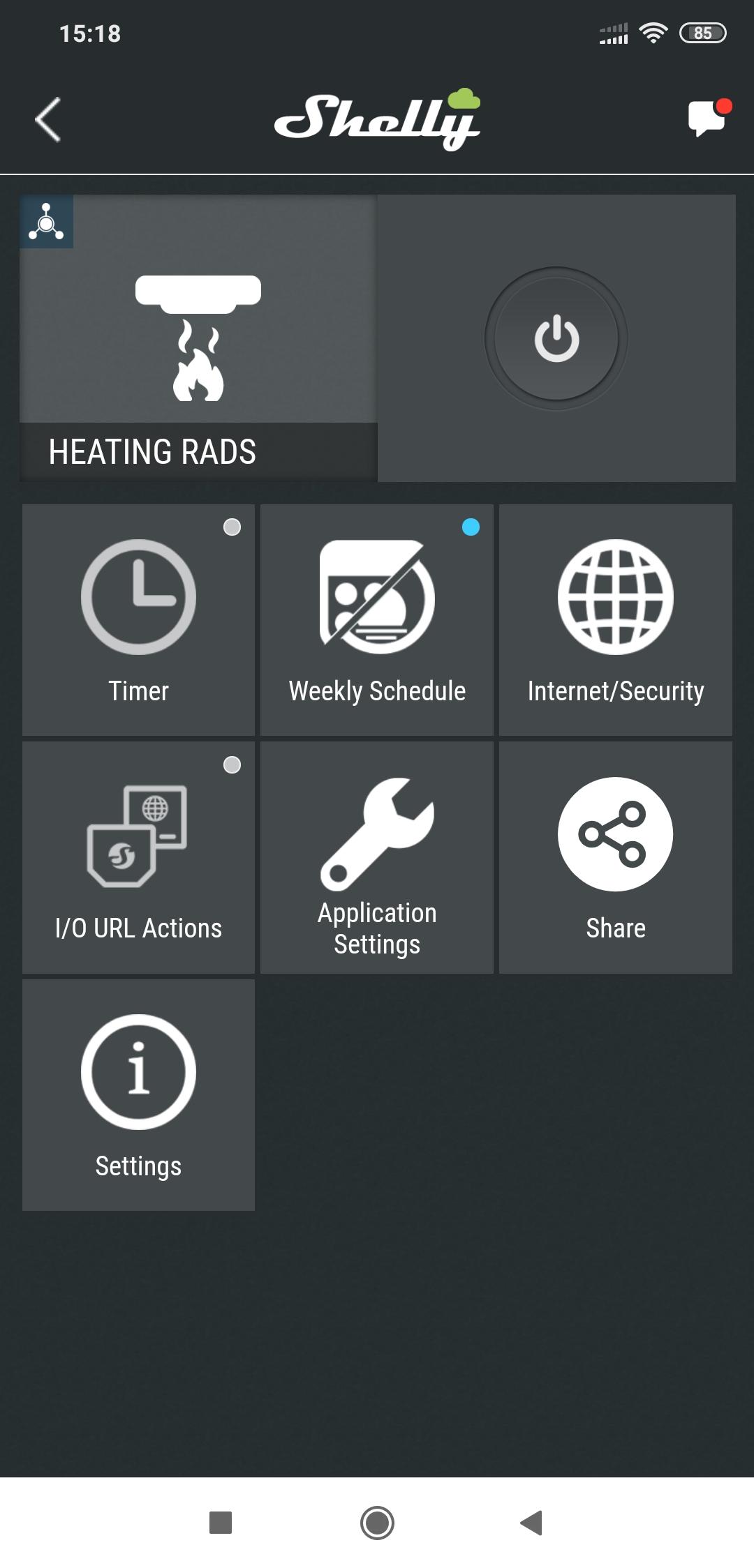

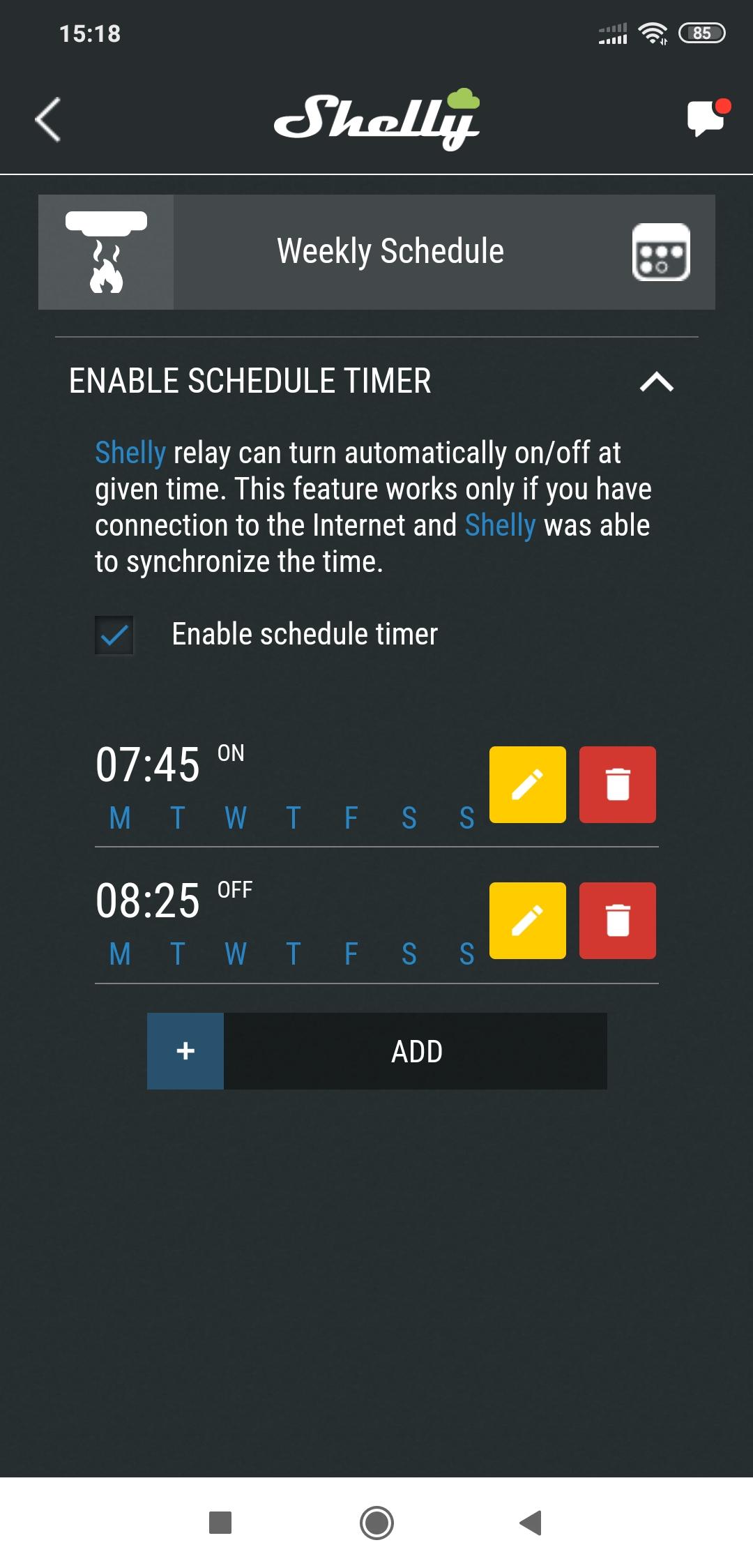

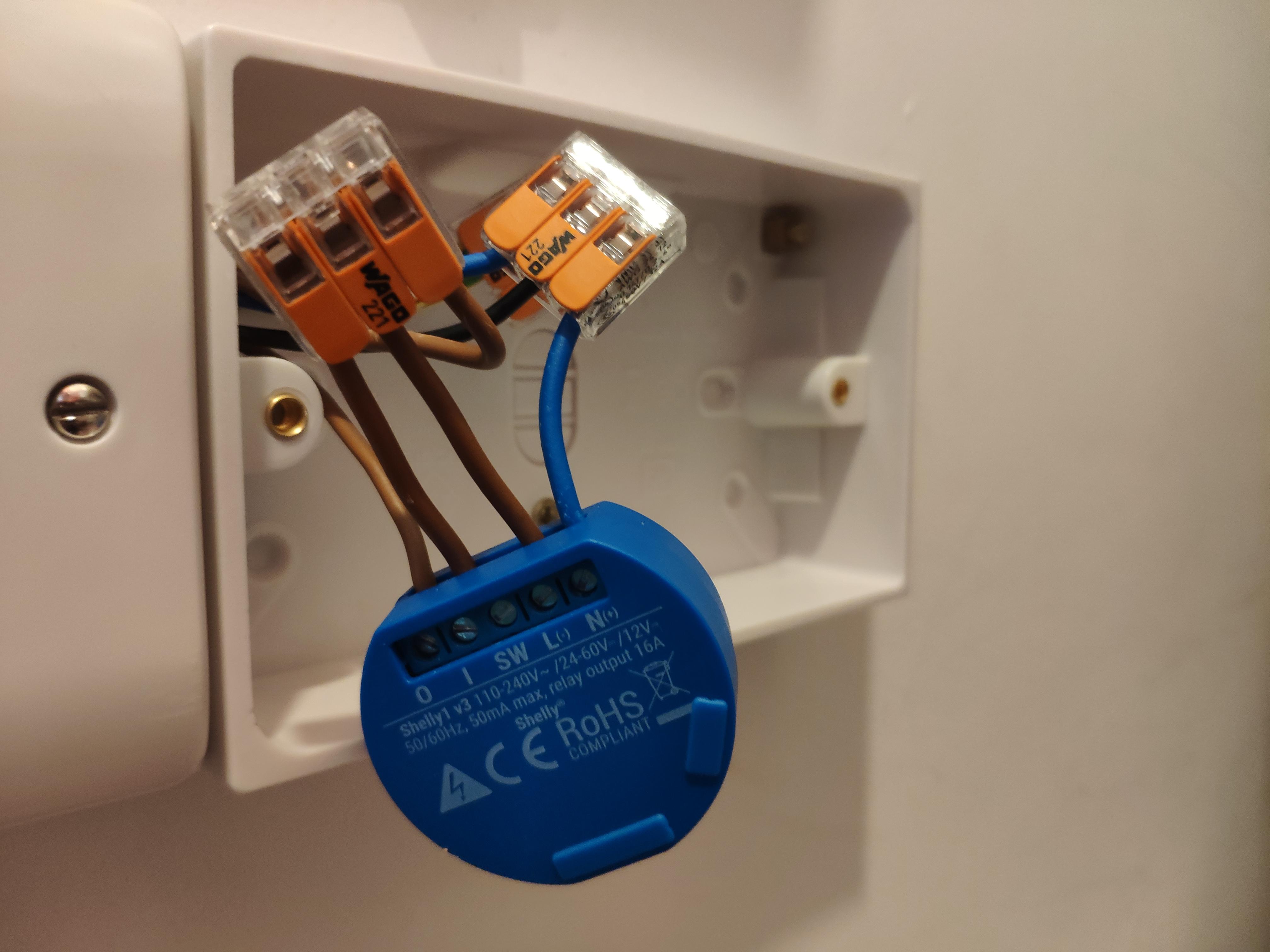

Declan52 Posted January 25, 2021 Author Posted January 25, 2021 So just to tidy this up my Shelly 1 arrived and I set it up. Very easy and well impressed so far. Here are a few pics of its setup and the app that controls it. I have a live and 2 neutral coming in plus a live going out and 2 earth. The live coming in gets split so a live goes to the L port to power it and another to the I for the input. The neutral goes to the N. The output then is the live return from the O. For tidiness I have them in a 2g box, a single would have been fine but had a double so used it. A blank face plate then covers it up. With the app I can then call it whatever it needs to be, lights or heating or whatever it's purpose is. By clicking on the correct option I can then set a weekly schedule to come on when ever I want. As a further option I can connect to the Shelly via the cloud and turn the rads on when I'm not using my home network.
SteamyTea Posted January 25, 2021 Posted January 25, 2021 If you have programmed the Shelly to come on at a set time, and then you have a power failure, does it keep the same state i.e. on, or does if fail safe i.e off. And can it repickup any times that are set? Or are they done on your phone/cloud?
Declan52 Posted January 25, 2021 Author Posted January 25, 2021 I had it wired up roughly just to test it and had to disconnect it and all the settings where still there. But not sure it's stored on the device or the app.
PeterW Posted January 25, 2021 Posted January 25, 2021 It’s all on the device. I had one hanging off a 4G hotspot doing outside lights on dusk to dawn and forgot to plug the hotspot in and it kept going.
SteamyTea Posted January 25, 2021 Posted January 25, 2021 2 minutes ago, Declan52 said: But not sure it's stored on the device or the app. Interesting. I wonder what happens if you use a local network, with the settings on the phone, then the power goes when you are out. Not sure if that would be an unusual scenario or not.
