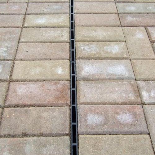

MAB Posted December 22, 2020 Share Posted December 22, 2020 Linear Slot Drainage channels look better than the standard wide gratings available but do they block up with debris easily and how exactly do you clean out the channel below in a concrete block driveway? https://www.drainagesuperstore.co.uk/product/aco-brickslot-hexdrain-threshold-channel-drain-1m-x-125mm-x-148mm-a15.html Link to comment Share on other sites More sharing options...

Temp Posted December 22, 2020 Share Posted December 22, 2020 Pressure washer. The actual channel can also be rodded if you provide access at the end. 1 Link to comment Share on other sites More sharing options...
Critical Path Posted December 23, 2020 Share Posted December 23, 2020 The slot drains have a sump unit that transitions the slot into your drain connection the lids are recessed to accept paving. We use Gatic slot drains in commercial settings. 2 Link to comment Share on other sites More sharing options...
