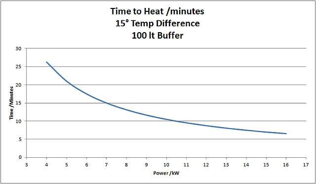

Just a general observation.  Putting in a buffer will reduce short cycling of the heat source.
Taking a simple example of allowing a 100 lt buffer to vary between 30°C and 45°C, and not taking any external draw from it, the times will vary for different power sources.
(this chart breaks convention by putting time on the y-axis, but is correct as time varies with power, with power being the controlled variable)
