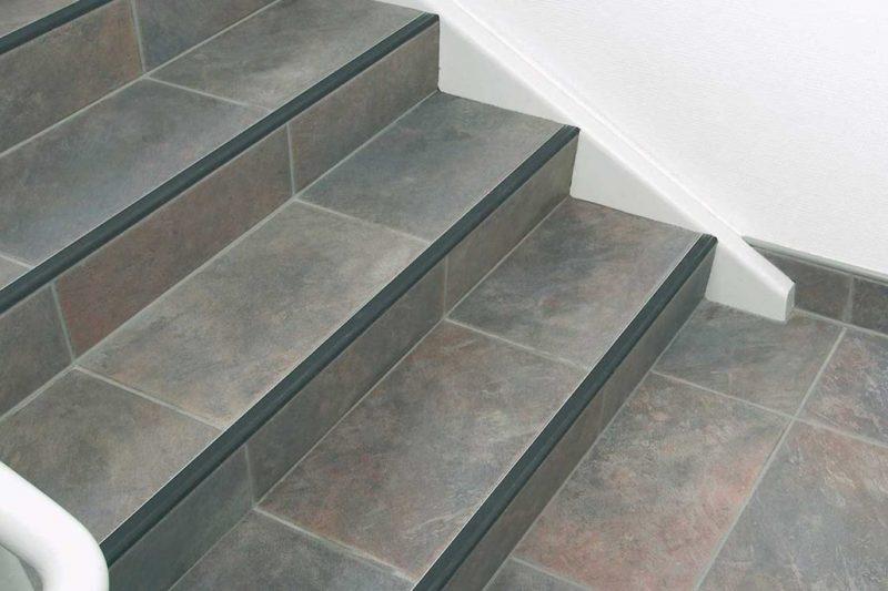

NeilScotland Posted December 18, 2020 Share Posted December 18, 2020 Hi All, I have a step to tile - and I was wondering if you have any suggestions /tips /advice on how to finish the edge. It will have high traffic - it is a step from the living room to the (new) kitchen...... I had an old trim that I was trying out... the stylre works ok, but curious to hear your thoughts. I'm also worried a trim won't last the test of time..... Alternative is no trim - tile to tile - but it looks a bit $hit i think. Hope to hear, Neil Link to comment Share on other sites More sharing options...
Gav_P Posted December 18, 2020 Share Posted December 18, 2020 (edited) The second option, with the trim, looks better to me. Although, thinking about it, won’t you want something visual to show where the step is, otherwise people will keep tripping up it? maybe something like this? Edited December 18, 2020 by Gav_P 2 Link to comment Share on other sites More sharing options...
Mr Punter Posted December 18, 2020 Share Posted December 18, 2020 +1 to the nosing. Make it a contrast. 1 Link to comment Share on other sites More sharing options...
NeilScotland Posted December 18, 2020 Author Share Posted December 18, 2020 Thanks, does look quite nice actually..... Link to comment Share on other sites More sharing options...
Gav_P Posted December 18, 2020 Share Posted December 18, 2020 25 minutes ago, NeilScotland said: Thanks, does look quite nice actually..... yeah I think it can make it look quite professional, rather than average. 1 Link to comment Share on other sites More sharing options...
NeilScotland Posted December 18, 2020 Author Share Posted December 18, 2020 Challenge is, the step is over 3m long - it's unlikely i'll get a trim that long and a join will not look great.. Link to comment Share on other sites More sharing options...
nod Posted December 18, 2020 Share Posted December 18, 2020 If you are doing them yourself an edging strip may be a good option Though-a strip is rarely used on commercial As they are prone to damage I normally tile the up stands and use a gauge to square the step then tile the top of the steps You will need a tile with a fully glazed edge Link to comment Share on other sites More sharing options...
